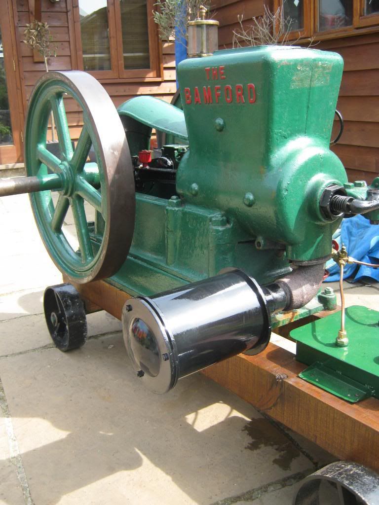

My Bamford 4 Hp
Just varnished the trolley in the sun. Smile Need To grind the exhaust valve in. Then hopefully she will make it to the rally Next weekend with my tulip top.

I must be mad just bought a ruston PR. going to collect 2morrow.
Also why does the bamford exhaust valve get so hot that its smoking.
lewis
Age : 23
Re: Bamford 4Hp
Post by JONESEY on Sat May 07 2011, 21:57
Sounds like the timings out and the fuels burnig too long in the bore before th valves opening

when i got the engine it never got hot around the exhasut valve. Its only since we took the valves out to re grind them, It has started doing it. The only valve that gets hot is the exhaust and it only gets hot and around the cylinder head. but no where else. it starts and runs well only the heat in the exhaust valve.

Lewis how hot is it getting, reading this it sounds that it must be very hot if it's causing you some concern. I have to agree with what's been said and check the timing. I wonder if it's worth adding an additive to the petrol, to put some of the lead back in. On older car engines when they changed the petrol to lead free they would burn out the valves or valve seats, so it was change them for a modern vavle or put an aditive in the fuel. Normally it should effect something like a stationary engine but maybe worth a try.

Post by Hughesy on Mon May 09 2011, 14:59
getting hot enough so that when you place a drop of water on it evaporates straight away.
timing i believe is now better it was only slightly out. but out. so thats been adjusted and now is better.
need to give it a good run and try it on heating oil. whats a good mixture for heating oil.

stationary stu wrote:Lewis how hot is it getting, reading this it sounds that it must be very hot if it's causing you some concern. I have to agree with what's been said and check the timing. I wonder if it's worth adding an additive to the petrol, to put some of the lead back in. On older car engines when they changed the petrol to lead free they would burn out the valves or valve seats, so it was change them for a modern vavle or put an aditive in the fuel. Normally it should effect something like a stationary engine but maybe worth a try.
I wouldnt Put any aditive in the fuel as due to the engines age it would have been meant to run on the old 2 star petrol, which basicly is unleaded in todays money.
The only thing that i can think of to making the valve hot would be the timming or mixture, It wouldnt take the timming to be out by much to make the valve hot.

i have set the timing so that it sparks just after top dead centre is this right or can someone tell me different.. Also can someone tell how strong these valve springs should be as.

Post by stationary stu on Tue May 10 2011, 10:54
Lewis I'm no expert but I would say it should be a few degrees before TDC. Someone with a bit more knowledge of this engine might be able to help you better.
