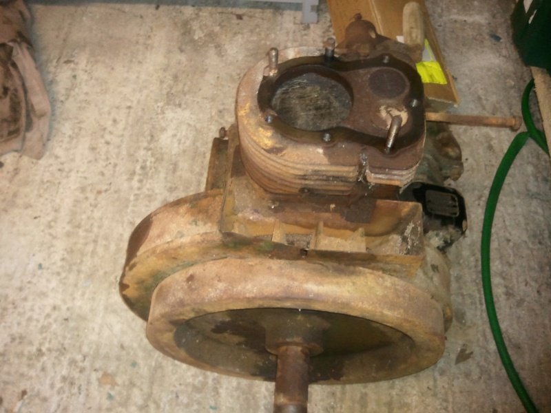

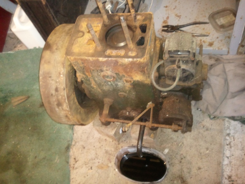

Having just reconditioned my BMC 1.5 diesel for my narrowboat I decided that it would be nice to punish myself further, and always having been fascinated by stationarys I have purchased a Lister 18D2T which I have dated at 1937 and a Petter A1 which was a standy by in a milking parlour from at least 1949. Number 592392 if anyone can date it!
The Lister turns freely, so the heads off to reveal a stuck valve for starters and what looks like a newish +60 piston, so it's done some work in the past I guess. Everything else seems to be present except the exhaust which I believe can be bought easily from the bay!!
The Petter was turning up to a couple of years ago but is now seized. Again the heads off to reveal another stuck valve. Looks like I'll have fun removing the flywheel. Of course in my enthusiasm, forgot to take the before photo's but I've taken some now, so I'll post them when I get the knack of it.

Post by DaveT on Sun Jun 12 2011, 22:16
The Listers coming on...bits cleaned and painted and all that. Still having fun with the flywheel, but am in the process of making a suitable puller. Anyone know where to get suitable trolley wheels from?

Post by DaveT on Mon Jun 13 2011, 20:32
Thanks for the info Stu and Mike....I'll keep searching....hit my first real problem today, I made a gib key puller, but the key had been abused so much it pulled the head off....so its a drill out job I think study . Funnily enough, the Petter gib key came off no problems and that was the one I was expecting problems with. The Petter piston is siezed solid in the bore so I had to disconnect the con rod in situ which was a bit fiddly. So its less of a big lump now!!
Cheers for now

Post by stationary stu on Tue Jun 14 2011, 10:21
Dave it might have been better to split the threads to the Lister and Petter as were getting old and confuse easy lol! lol! lol!
The Petter, have you tried putting diesel or WD40 down the bore and let it soak for a few days, then just trying to tap it with a lump of wood. Even if it's just a few mm's to start with it all helps just to break the rust seal.
Can you not get a thin chisel behind the gib key, I did see some pics of it being done that way but can't find them now. You could also take the crank out with the flywheel still attached and put it in a vice if that's easier for you. Same again try and soak the gib key in WD40 and a little heat before trying again. You can get WD40 for about £25 a gallon it's cheaper then buying the small spray cans.

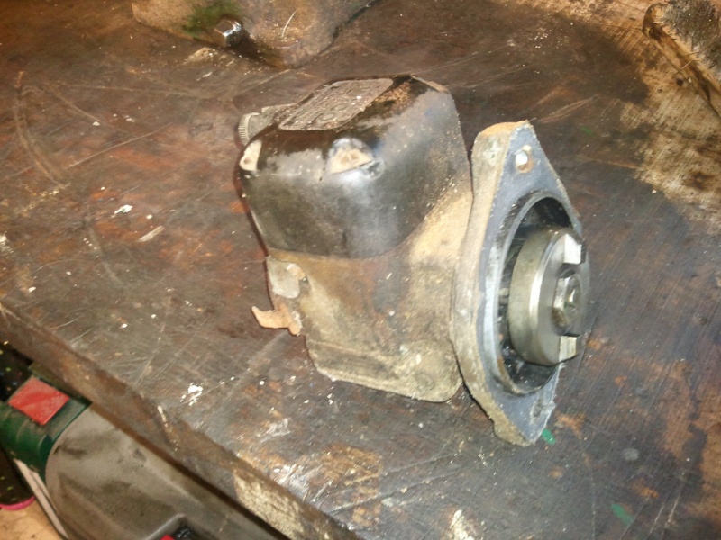

First attempt project...Petter
Post by DaveT on Wed Jun 15 2011, 18:41
Hi all,
Hopefully I'll get the photos up first time this time....The plate reads Number...592392, Series A1, 1 and1/2 HP @ 750RPM. The plate is made of brass. The Mag is a Series A Wico
Does this help Rab?

Post by RAB on Wed Jun 15 2011, 19:41
Hi Dave,
The engine you have is a Petter A1 series 2 as has been said in previous posts, and is dated between 1947 - 1949.
For a definative answer to your engine dating post a letter to with a SAE to :-
Keith Ott
80 Hobb Lane
Hedge End
Southampton
SO3 4GP
He can tell the exact date and who it was first supplied to, Hes a busy guy so you may have to wait a week or two.
Best of luck with the restoration dave keep us up to date with the procedings.
