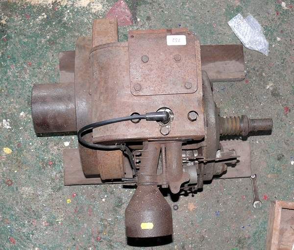

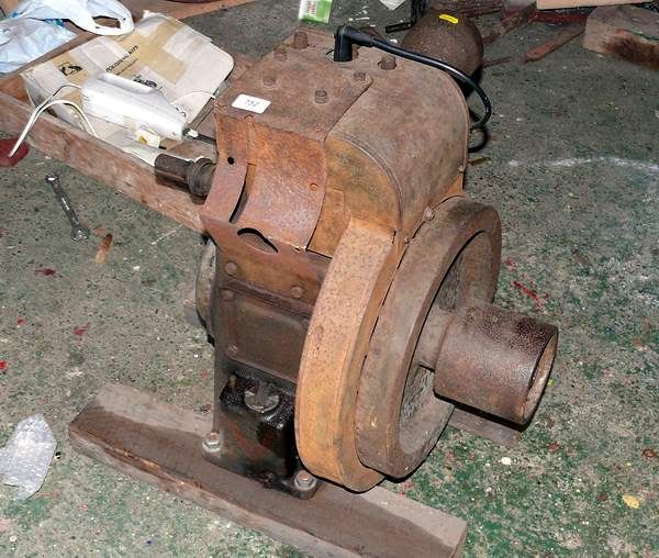

Hi. I just joined here after buying a Petter A1 at a local auction, I have always been interested in seeing them on the rally fields and thought I might try restoring one. Very Happy

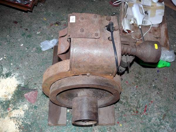

collected it this morning and here it is, about a 1\3 ton of seized up rust with bits missing Shocked Laughing
I found out what it was from the name plate

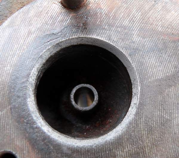

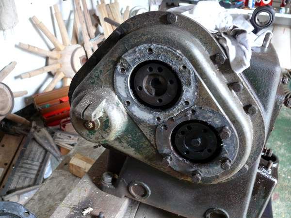

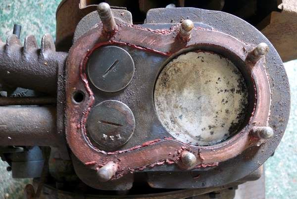

strange thing is the exhaust valve is in line with the carb and the in valve lines up with the exhaust Question

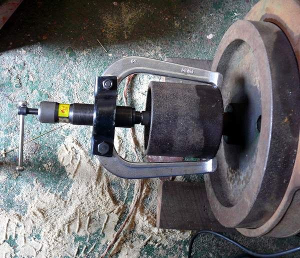

next off were the pulley and the flywheel

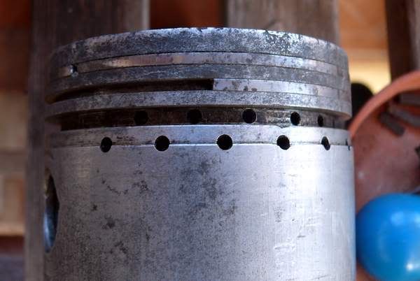

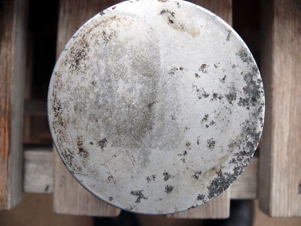

after unbolting the barrel i found out which end was seized, the top end the piston was solid in the bore, some bright spark had fitted the head gasket with red hermatite Shocked which had run down inside the barrel as he tightened it up Shocked
several different thickness's of wood were gradually built up between the barrel and the top of the crank case and a big hammer was used with a block of wood to knock the piston down the barrel, not a good idea i know but it was the best i could think of at the time.

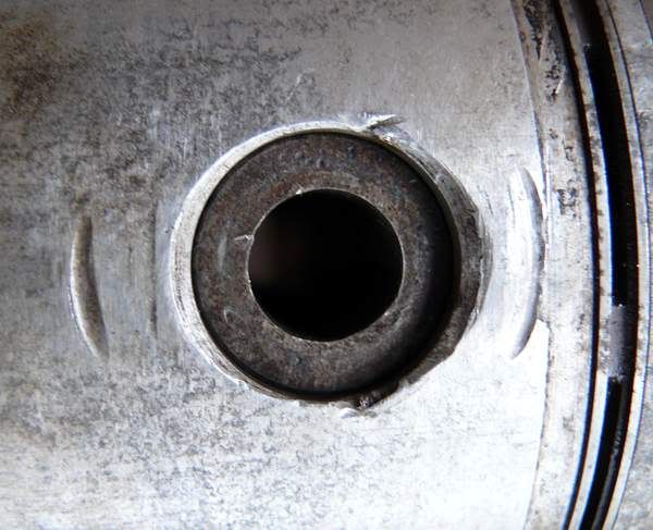

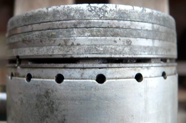

all 3 rings were solidly jammed up with red hermatite and the gudgeon pin is solid in the piston too.
i just hope i didn't damage the bottom end bearing (shells?) getting the piston out Embarassed
the bore looks surprisingly good after bashing the piston out

thanks guys. Very Happy are those valves the wrong way round ??

Hi Neville, from the sounds of the last engine restorer he may have just put the valves in the wrong way round. The piston looks as i might be shot looking at the score marks, but I'd need to see it better once it was all cleaned up. It beats me why people use red hermitite and more so on an air cooled engine scratch scratch There doesn't look to be much missing it has most of the main bits and even a flywheel pully. You'll need to find a good petrol tank and pipe. If you sort out what else you need try an add in the wanted section.

the gudgeon pin is seized in the piston so i'm working on a puller using some threaded bar and some steel pipe, the engine is in a friends workshop so i can only work on it when he's around.
looking at the valves they are both the same size so i will probably swap them when i grind them in.

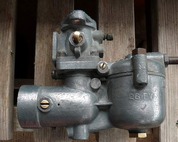

i brought the carb home this weekend and gave that a clean and cleared the jets, its crap metal so it didn't clean up too well

yes i bought a book and it says carb is either a Zenith 24U or a Zenith 24T-2 but mine seems to be a Solex 26-FV so maybe not the original Question

well i made a puller for the gudgeon pin with some threaded bar and cranked the pin out
piston is standard size
minor damage from the puller
rings are gummed up solid
started breaking them out in case the piston can be re-used
top view

The Valves are the wrong way round, its not a big job to change them over.
The carb that you have is from a 'Petter A' engine. youd be better to get the right type as it would run better.

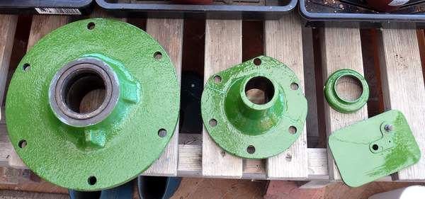

made 2 more gaskets last night.
painted a few bits this morning, my first green bits Cool
and some little mainly carb linkages painted black hanging in the conservatory roof to dry

thinking about getting the pulley and flywheel skimmed on a lathe Question it would save an awful lot of work trying to do it by hand
