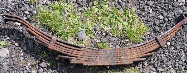

having more trouble with the trailer than i thought Rolling Eyes had to cut the axle out with an angle grinder

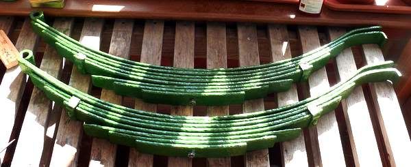

then cut the springs off

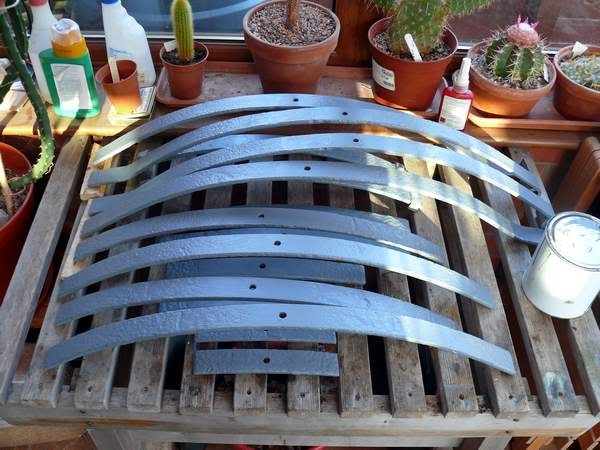

springs have been blasted and primed and i'm buying new bolts and U bolts from eBay

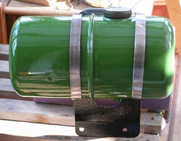

trailer is being a right pain so i had a day away from it today and made some stainless tank straps
and got my axles welded Very Happy

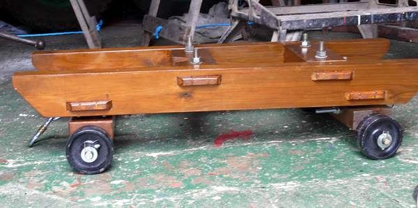

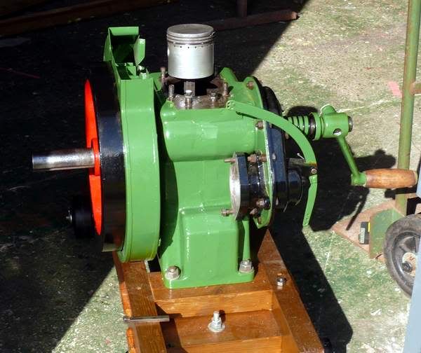

finished the trolley today Cool
and set the engine on it.............
Stu the end where the engine is is steerable, no problem with the lock because the wheels are small enough to go under the trolley. looking back i would have liked bigger wheels.
Re: my first engine
Post by matt86 on Wed Aug 10 2011, 21:22
smart looking trolley there ... soon will be having trolley competitions lol
Re: my first engine
Post by hob on Wed Aug 10 2011, 21:52
thanks Matt, it helps sharing a workshop with a retired wheelwright Very Happy
timber is all 40 year old pine reclaimed from a big packing crate, wheels, axle metal and bolts came to about 35 quid and the varnish was left over from decorating the bathroom Laughing
Re: my first engine
Post by stationary stu on Thu Aug 11 2011, 10:02
Cracking looking trolley, give yourself a pat on the back for a first atempt you can't get much better. Neville you could always change the wheels if you find some bigger ones, the axles would need to be changed as the diameter would be bigger so you always have that option then they'd need to be longer.
Befrore you mount the engine check first that the starting handle won't foul anything, (if you change the wheel size have it sorted now) nothing worse then getting it all built and find you can't turn it over, I saw it a few months back at a rally where he had to take a trolley wheel of to start his engine Laughing Laughing
Re: my first engine
Post by matt86 on Thu Aug 11 2011, 16:39
like the oil drain slot cut i to the cross brase

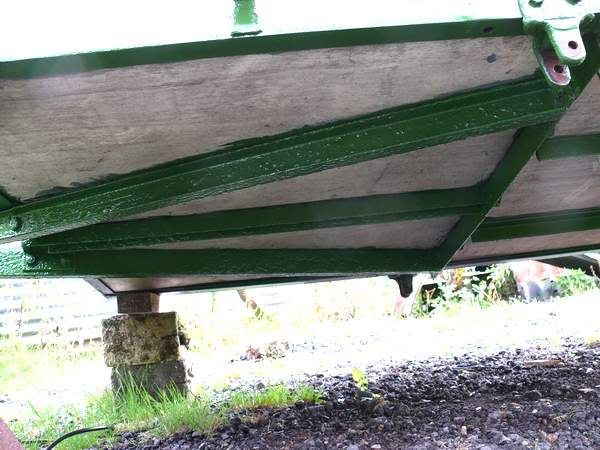

most of the last few days under the trailer Shocked wire brush, prime and paint
springs are ready, brake back-plates being repaired
managed to source all the new fixings
and painting the frame
large quantity of liquid pain killer purchased from the local wine-shop after laying on my back trying to look up for long periods drunken hoping to have the trailer back on its wheels next week.

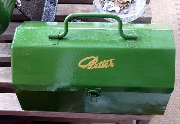

this old toolbox was my fathers in the 1960's, its been kicking around in various sheds and garages for years being too small to be much use....................i found it on a shelf the other day and thought what a nice little box to sit on my engine trolley......................... Cool
Re: my first engine
Post by stationary stu on Sat Aug 13 2011, 09:23
First class work again Neville, wish the weather had been fine enough to get outside, we've had rain, rain, rain.

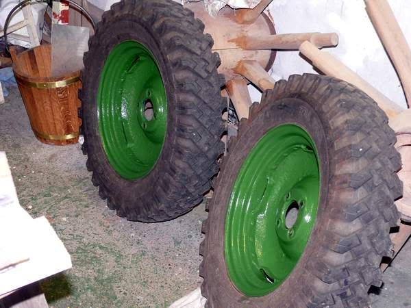

trailer work continues at pace (i need to move the chassis before i go on holiday)
brake drums repaired spring retainers welded and painted, axle rebuilt
wheels and mudguards repainted
framework painted and woodwork painting started
fitting the axle and wheels tomorrow to get it mobile ..............blocking the entrance to the barn Embarassed Embarassed

There big wheels to be on that trailer, must have been built as a heavy weight trailer. They look very similar to the wheels on my twin axle plant trailer 600x16 but mine needs new tyres which are difficult to find in my price range lol! lol! so looking to change the wheels for something newer.

look similar to land rover series wheels to me ... stu have you thought about them ?

Yes I think that's what they are, but must be a series 1 landy as the later ones went up to 7.50x16. There is someone near me that breaks 4x4's so I'm thinking of paying him a visit to see what he has in. Like I say it's all down to cost as I don't want to spend a lot on it as I'm going to sell it on as it's to big for me.

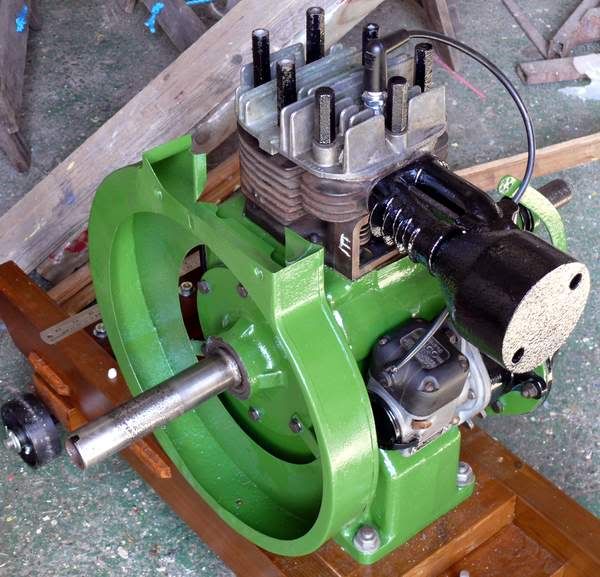

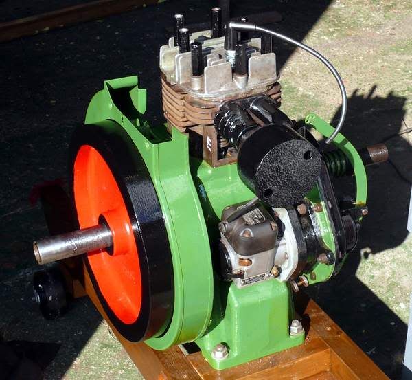

Petter A1 update done a bit more work recently Cool
piston with new rings fitted on the conrod and replaced the lower fan cover
refitted the barrel

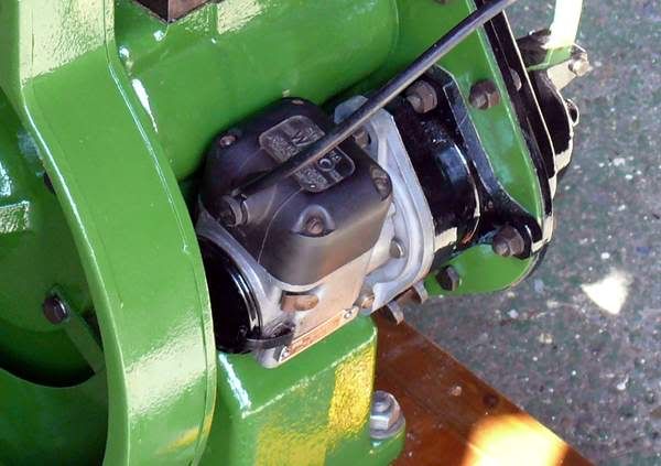

tested the mag and fitted it so it clicks and sparks at TDC
put the head on
and the manifold
and did some retouching on the flywheel ready to fit the key

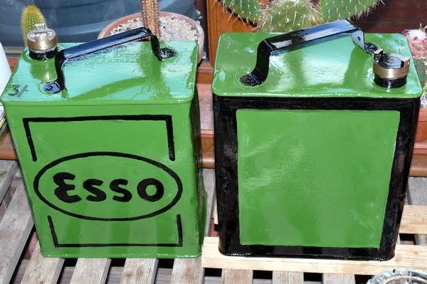

got a pair of 1940's petrol cans at a rally the other week and did them up a bit too
starting to look like an engine now Cool
