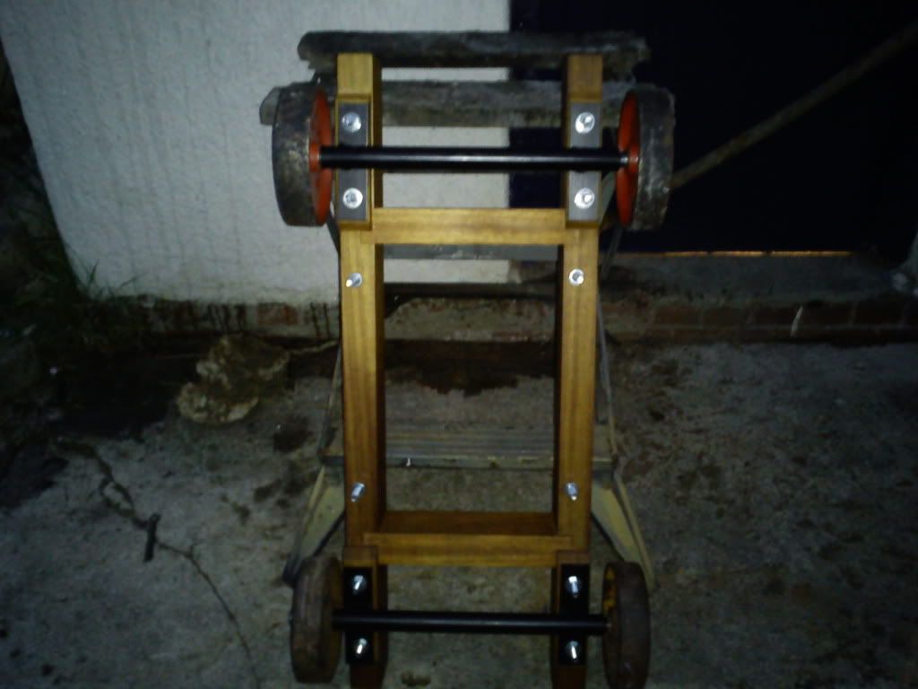

Post by matt86 on Sat Aug 13 2011, 22:30
after leaving the glue to dry and alot of sanding , have decided to oil the trolley up using danish oil .
After 4 coats ....
And a close up of the grain , Think the effect is what i wanted .... just debating if i should beeswax it now or not ?
Started to sort out the axles as well .. bought some 30mm round bar and some wheels from my stock pile . The holes in the wheel are 7/8 so will get the ends turned down to 22 mm to allow for clearance . If you can imagine the last 60mm of the bar tuned down to take the wheels and steps up to 30mm .
Started to make up some gaskets .... just done the sump one for now . once the trolley is done i will start to build up the engine from sump upwards doing the rest as i go .

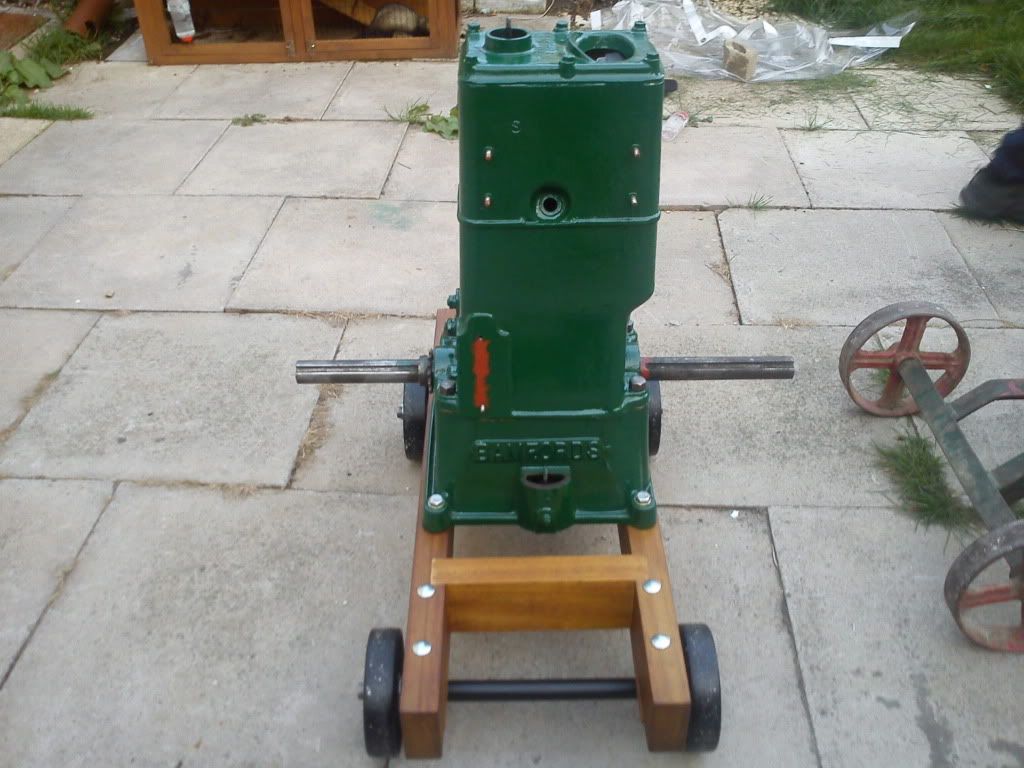

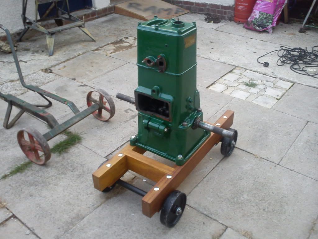

Post by matt86 on Fri Aug 19 2011, 20:27
A few up dated pictures with the trolley virtually finished , just need to washer out the wheels and clean them up and paint them .
after when this done i can start doing more bits on the engine then Smile hopefully should be finished off by october ish but you never know with this game lol
regards , matt

Post by matt86 on Sat Aug 20 2011, 12:30
Thanks stu , been into town today and got some 7/8 washers and bigger split pins so can clean the wheels up and paint them . once all assembled can wack the sump on Smile

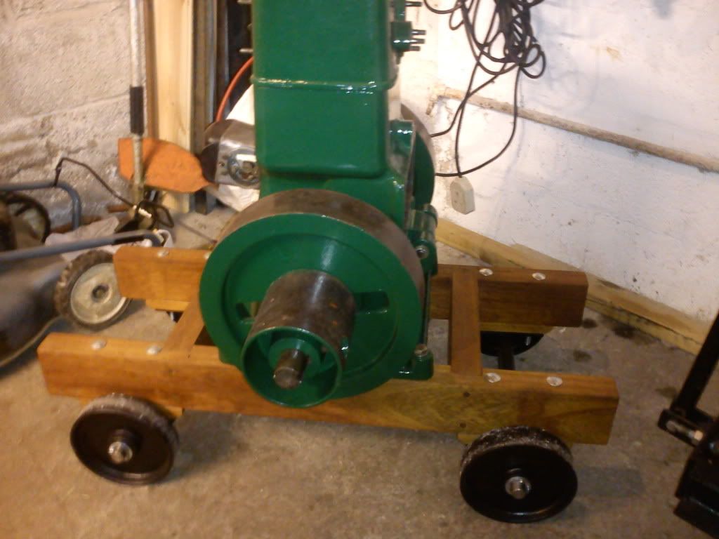

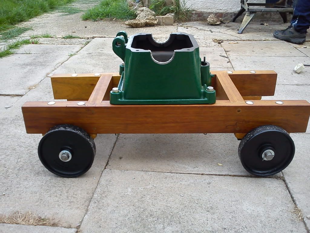

Post by matt86 on Sat Aug 20 2011, 20:00
been a busy bee today and made the most of the suntrap of the patio .... oven for drying paint lol lol! lol!
here is my progress so far , i have shimmed out the wheels now and painted wheels and placed the sump on -
As you can see i have placed some gland packing for the crankshaft seals ... 1/4" glad packing did the job fine , just hope it doesnt leak but have tightened it down quite tight .
Next was the main block to drop on with the gaskets ....
As you can see the sump bolts i have cleaned all the paint off ... not too sure if should leave them like it or to paint them . Question The idea was no paint to chip off when need to tilt the block in future .
regards , matt

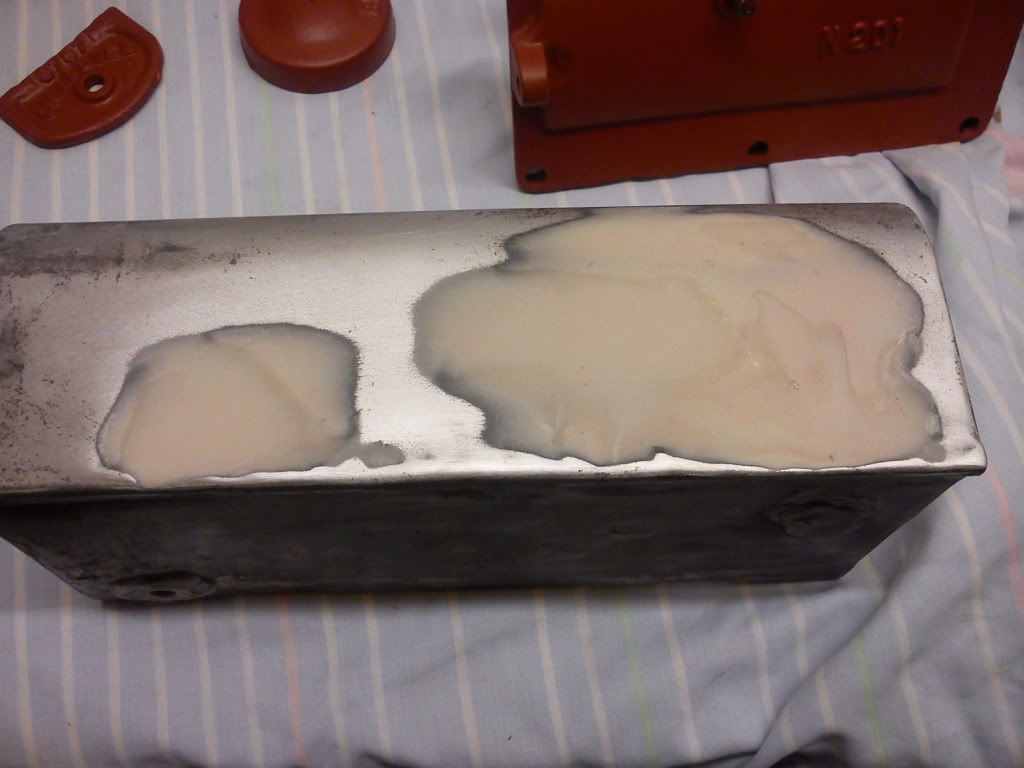

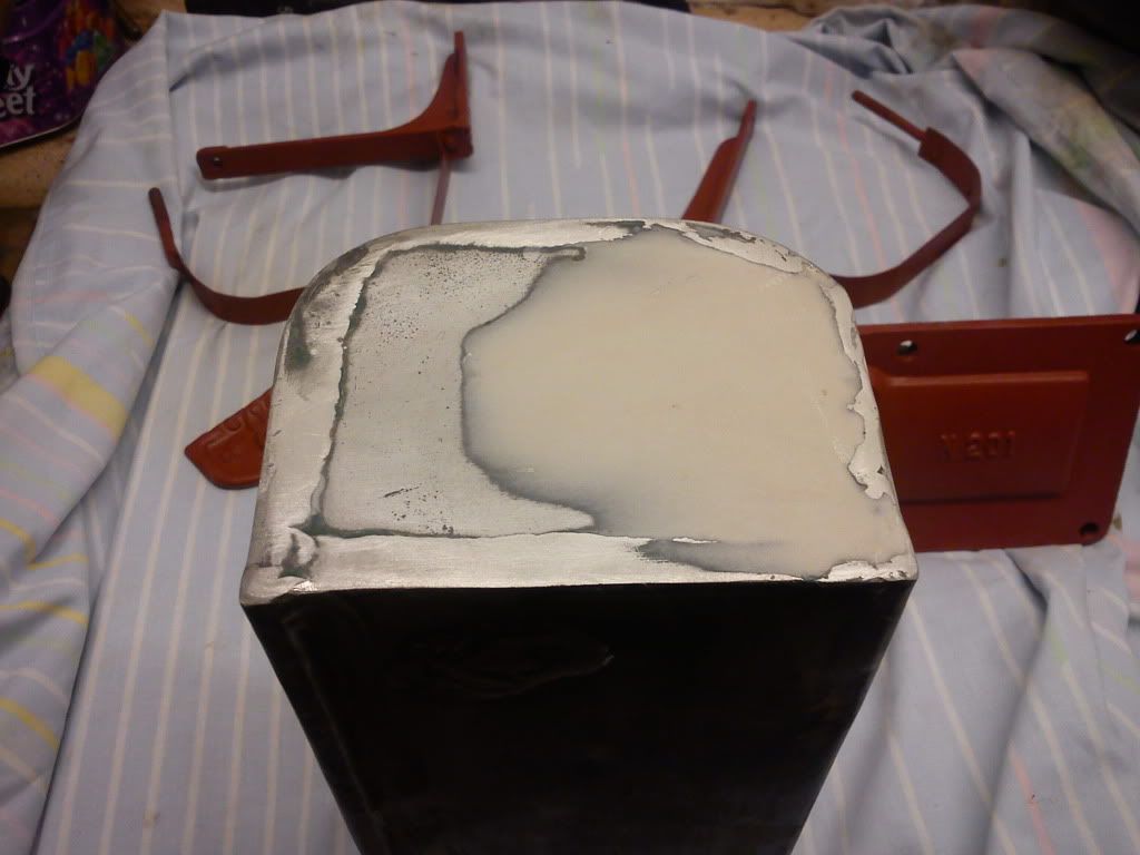

Post by matt86 on Mon Sep 05 2011, 21:12
yet some more progress on the bamford a bit slow been at dorset and other things on my plate ..
well the mag has been inspected and cleaned and painted the bracket and various other bits that been cleaning and painting .Also have striped the fuel tank and soldered up one of the ends... ( mastered it at last lol ) and been filling and sanding and filling etc as there was dents well more like craters.
anyway a few pictures -
regards , matt
