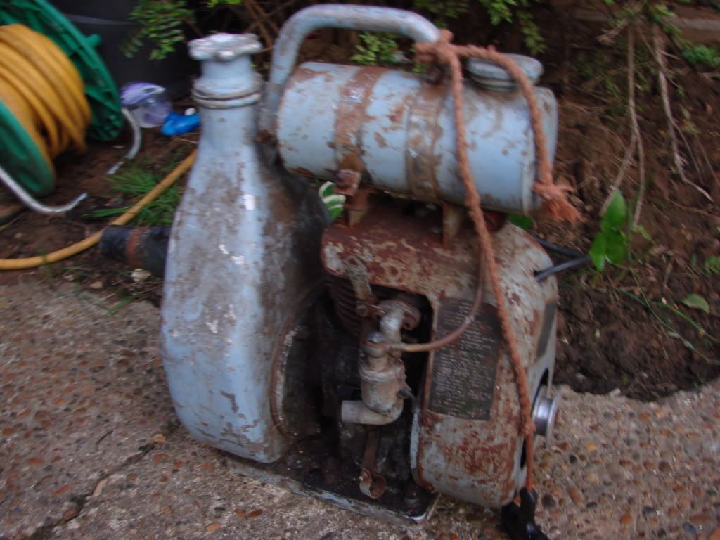

got this nice little jap2a alcon pump set off ebay for the bargain £5..
A little clean of the points and a quick whip off with its head to free off the exhaust valve as it was sticking a little..A bit of fuel and oil change it started up and ran ok..
As bought and pictured on front garden path

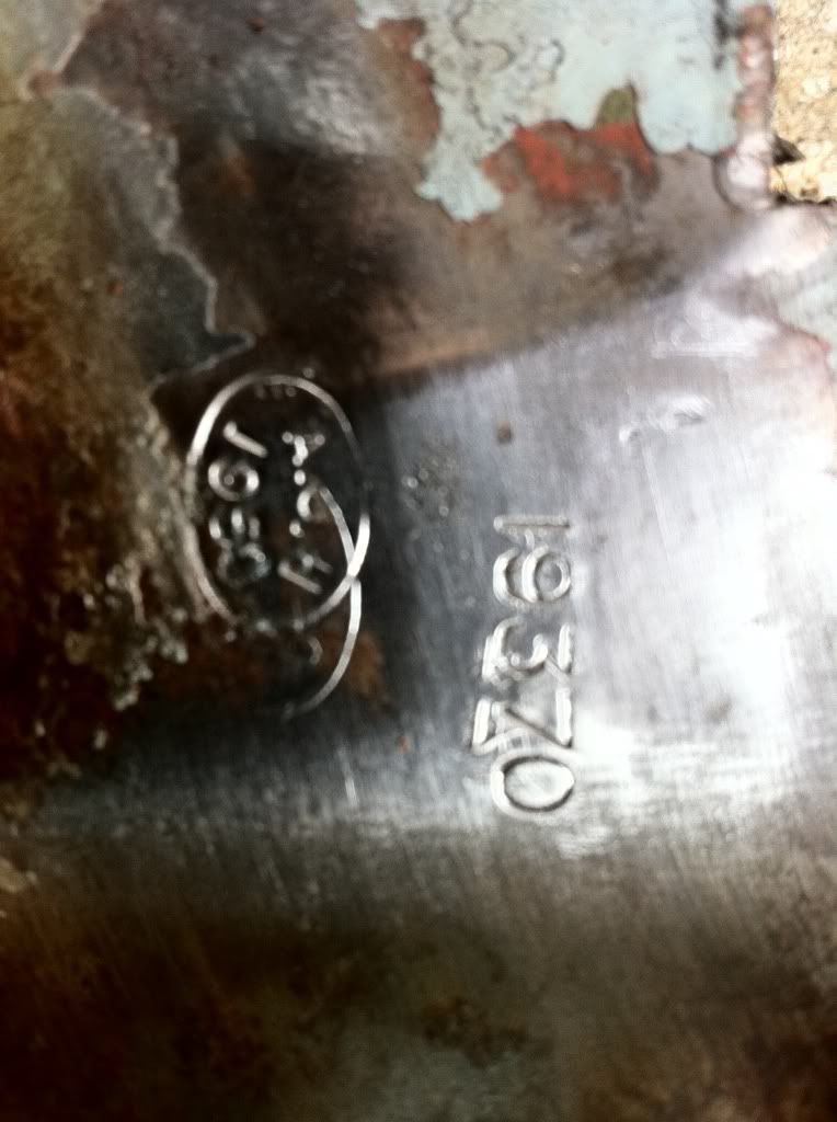

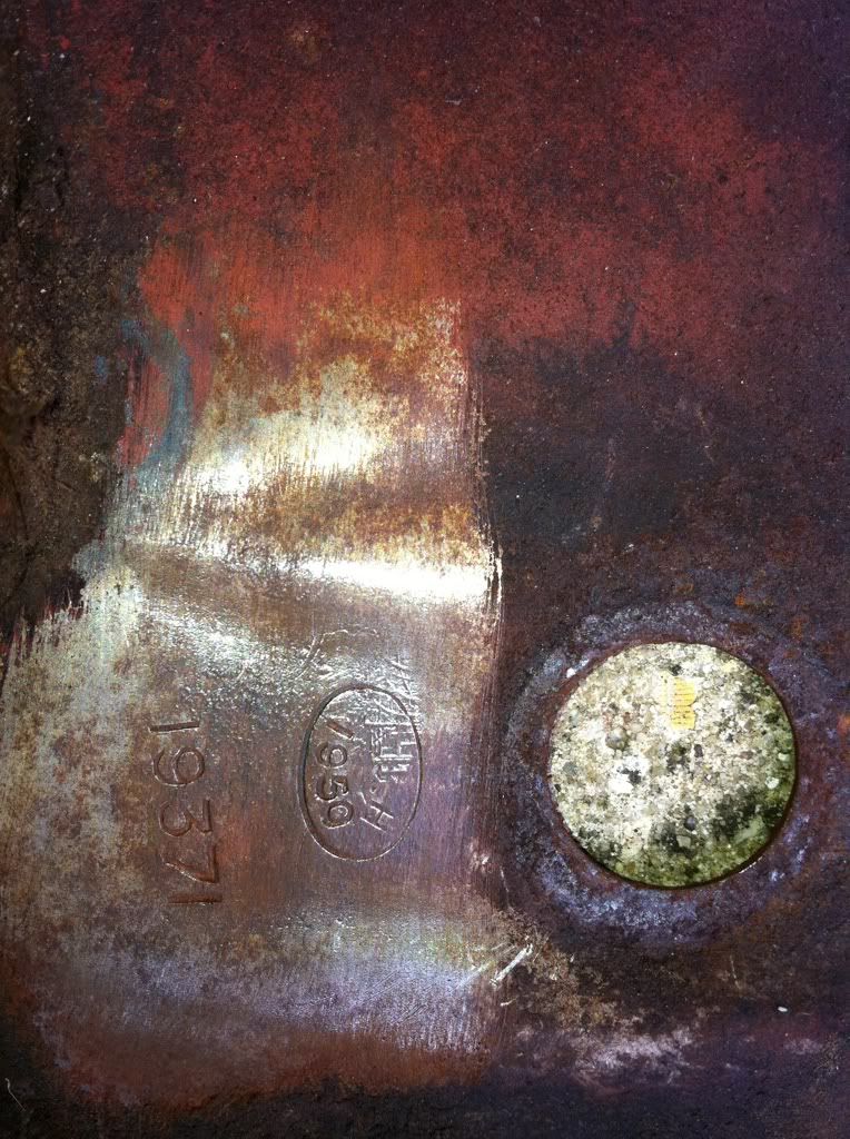

engine number.
now we seen this on petter engines made by j&h maclaren but found there mark on this jap engine as well..
just under the exhaust is where the mark is and its repeaqted inside the heat sheild/ducting dated 1950..
how do you date the jap engine normally?

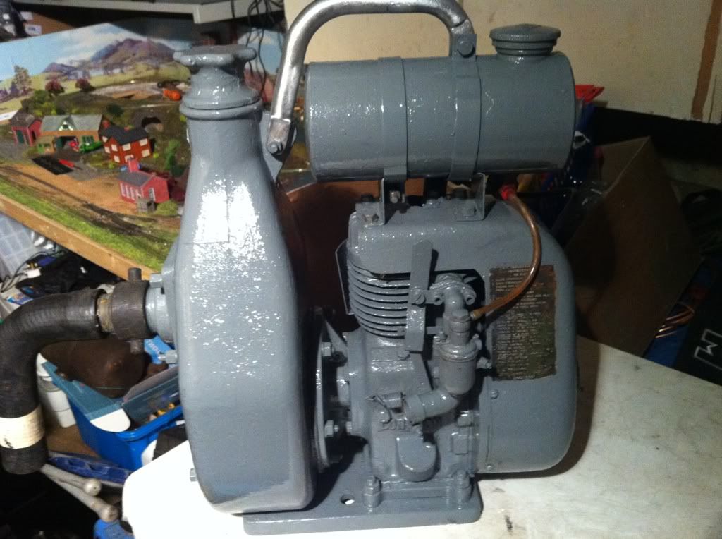

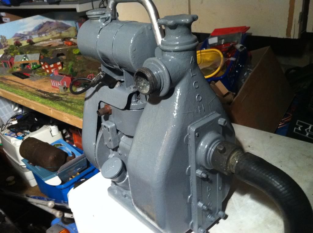

Painted in grey simlar colour that i found under a few layers of paint on it..going to take this little set to a rally next week and see how it runs for the day..
total spend including engine was £5..Had the paint already and had loads new spark plugs.even collected it on way home so no extra fuel in going to get it..maybe 4 or hours of work to bring it to a useable standard its by no means a trophey winner and was never going to be done to win any as just wanted it to look useable..hope to use it next week pumping out my gandads big pond as he wants it drained..
