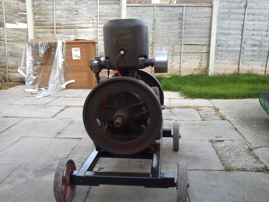

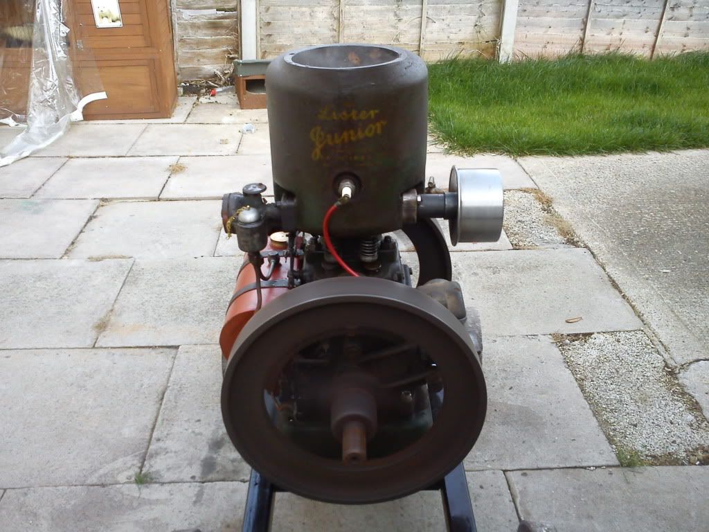

The Lister A after the mechanical restoration arrived at home tonight , got it out of trailer and into the shed in the dark ... a picture but will upload more tomorrow in daylight

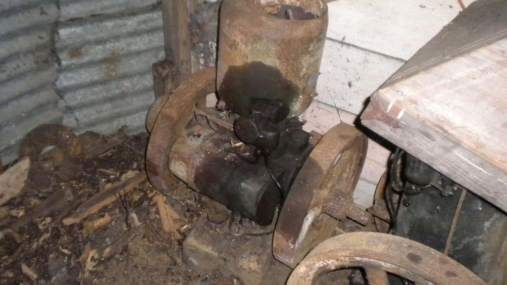

This engine was sat in a shed and was siezed solid and was sat there for 40 years plus ... fully mechanical strip down ... new rings , valves faced off , seats ground and lapped in , mains scraped etc all cleaned etc etc . the worst bit was the fuel tank .... more holes than a tea bag lol! so had to have a new one made .

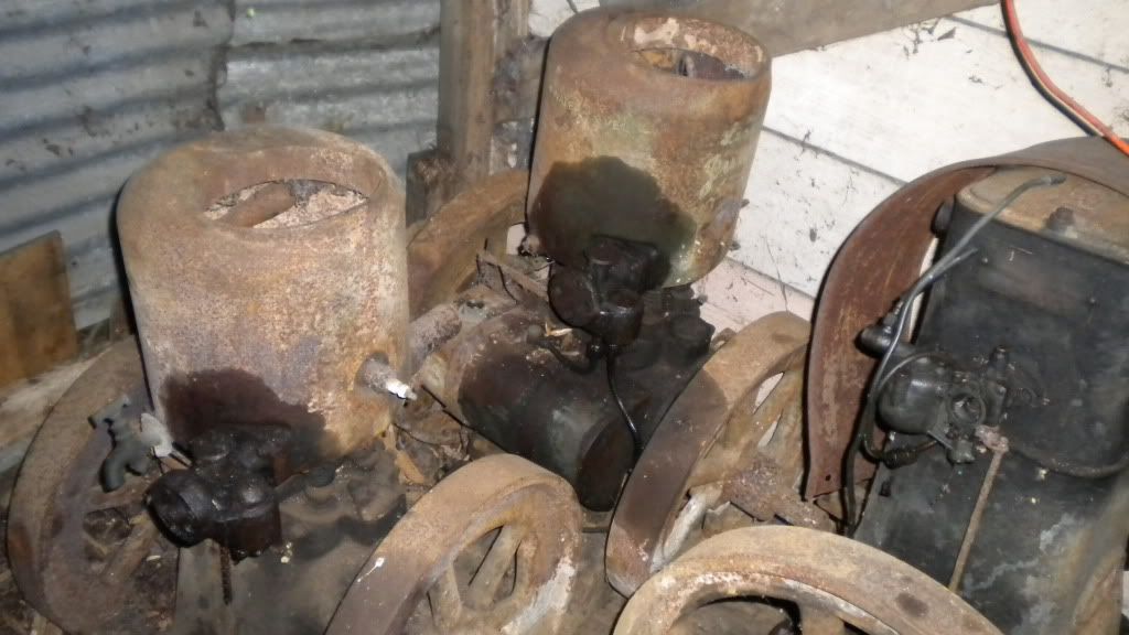

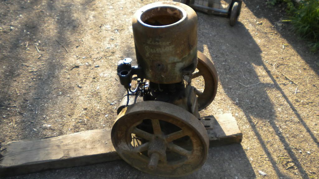

this what it looked liked when we dragged it out of the shed ...

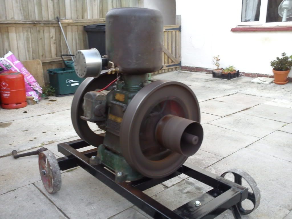

Finished ... ? It is finished just needs a oily rag treatment .... the trrolley i made from scratch before anyone asks who made it lol!

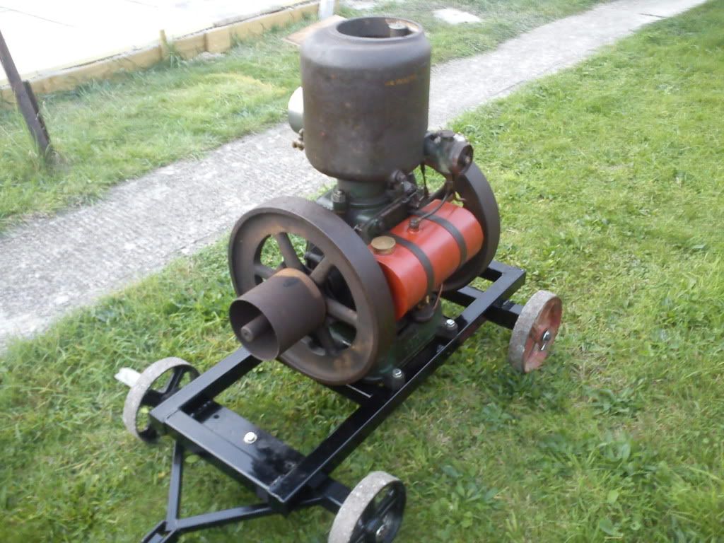

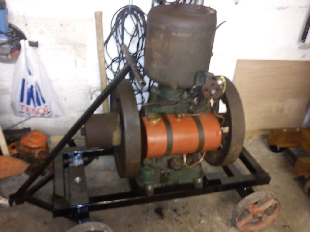

took a few more pictures today , and been down to Bristol to see martin at vintage magnetos , he is going to swap the rotation of my mag and at same time having a new condenser as it has gone open circuit ... the coil also has a intermittent spark but not that much to worry about i think as doesn't miss a spark that often so im going to chance it .
well some pictures ....
regards , matt

i bet it feels good to get it home,what a cracking trolley mate...
you ever thought of making trolleys for a living mate...
keep up the good work feller..

i like how u can see the transfers still though Very Happy

I have to agree with Mike it's a great trolley, had a good look at it and can't fault it, I'd like to make the same axle set up but wood skids but I'm better at welding then woodwork lol! lol!

and some pictures of it finished !
regards , matt
