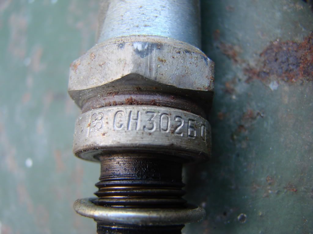

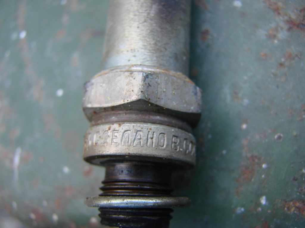

Proper russian(cccp) spark plugs with sheilded leads and connections all intact.Also it came with a load of spares like brand new plugs and mag points which are impossible to find anywhere(I have looked already)

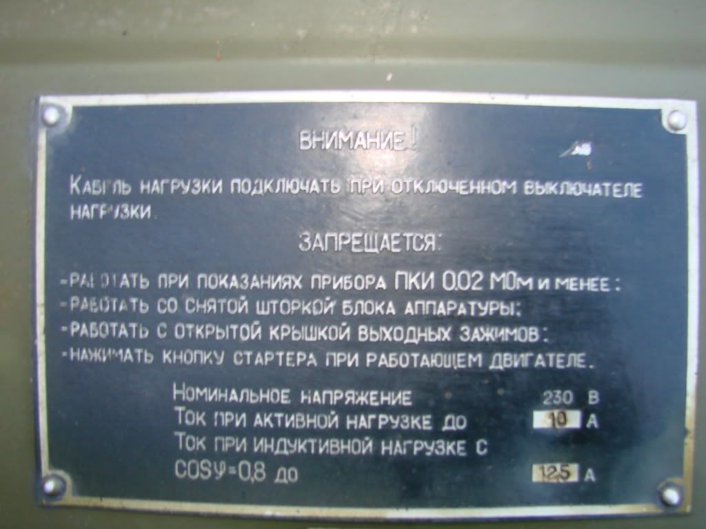

As can be seen this one is only a 10 amp nominal power.

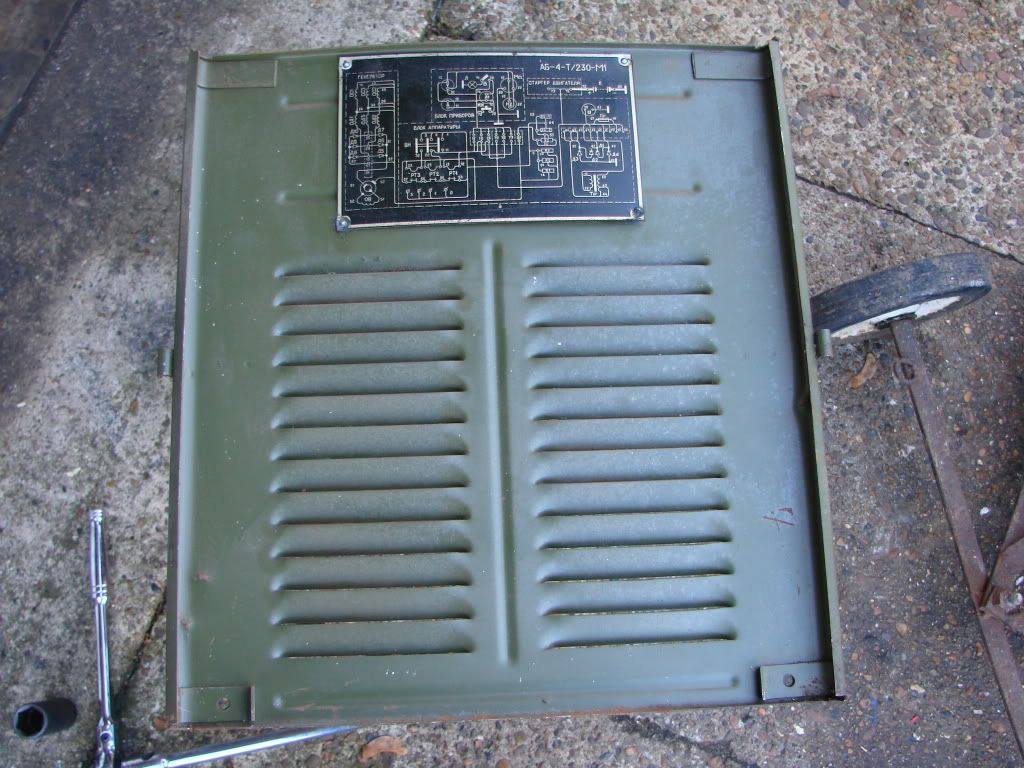

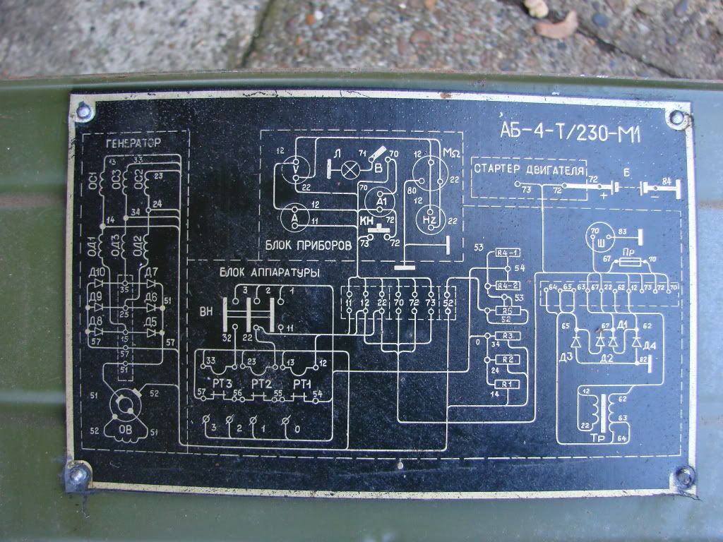

wiring plate is rivited inside the end panel still.
and inside the end plate showing the wiring and resisitors for the dummy load when its not powering the radio sets..
