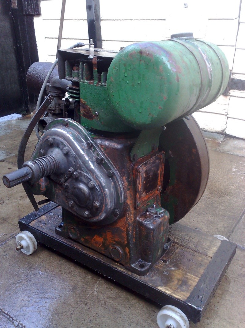

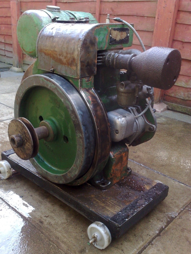

petter a1 update.
Post by earlsinclare on Tue Nov 29 2011, 12:42
the a1 is coming along nicely, a new head gasket and a replacement magneto. the engine is seen here after a good cleaning, next step is to overhaul the carb and pipe up the tank.

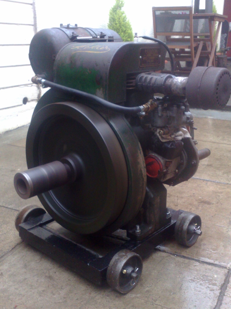

a new coat.
Post by earlsinclare on Mon Jan 02 2012, 18:38
due to the very mild weather over christmas i took the opportunity to paint my petter a1. just needs the silencer painting and the logo adding.
hope you like it.

Re: another two new projects.
Post by matt86 on Mon Jan 02 2012, 18:58
that is a superb job .
keep up the good work that man Smile
