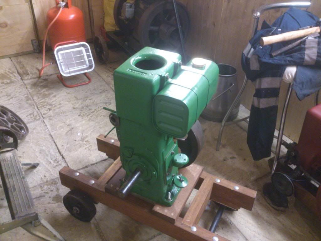

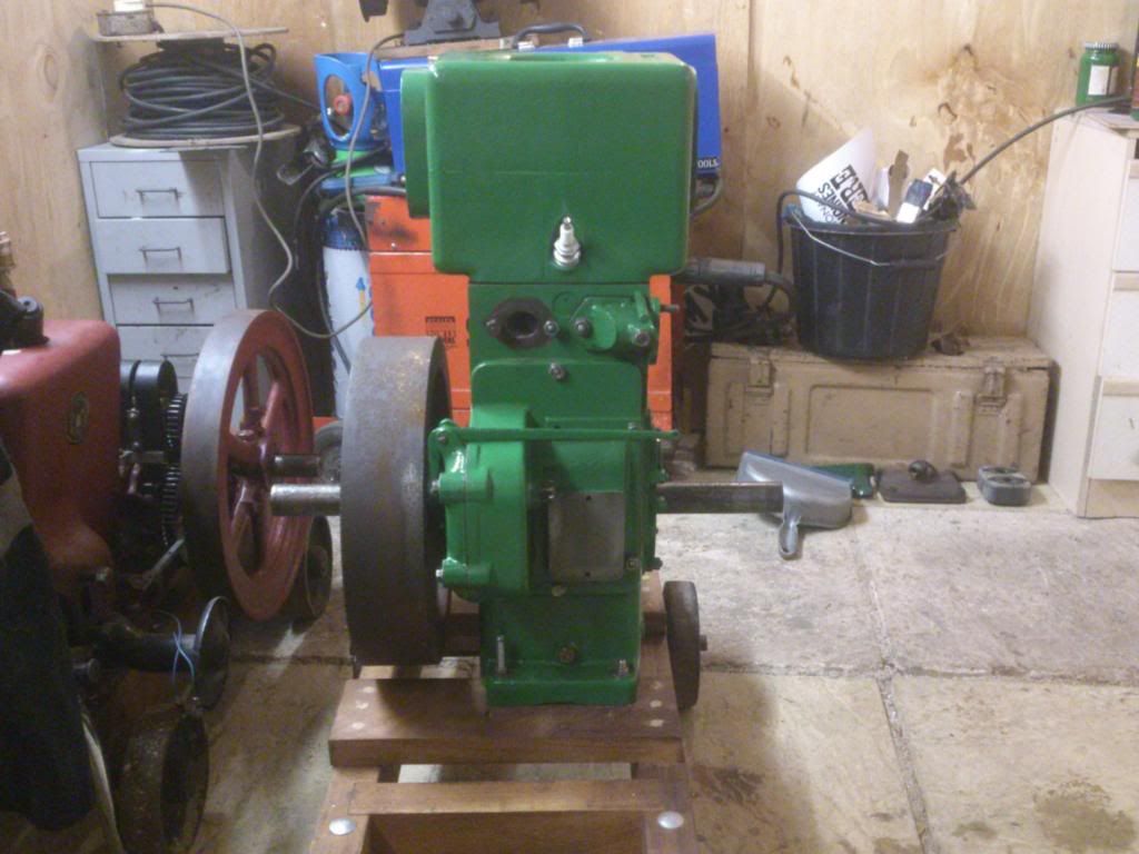

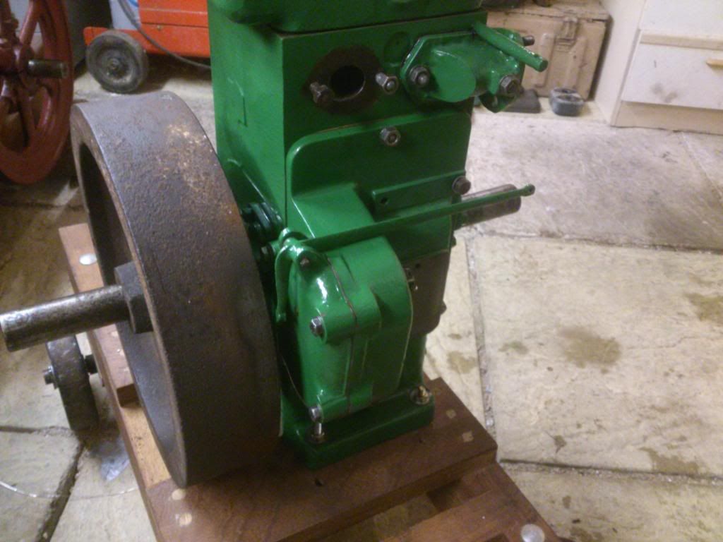

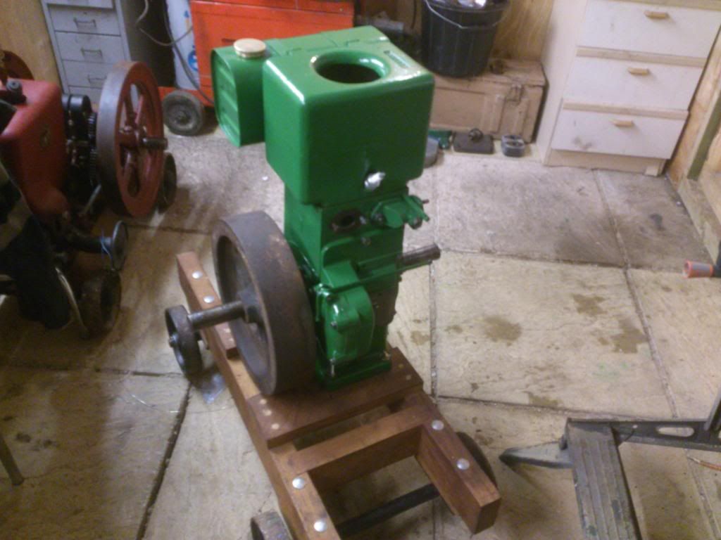

A little update ...
Been getting a few more bits done to the fowler tonight been busy otherwise decorating and getting stuck in the snow Embarassed
Managed to get the guvnor all installed with the arm and cover installed with the guvnor control pin . Fuel tank is on too since last pictures .
Here a few pictures
Just need to order a few bolts need some 5/16 x 1" BSF bolts and the guvnor spring tensor , one from a lister D would do . Oh i need to get a plunger for a lister D carb too mine is missing , if anyone has one i would be grateful.
And then All to do is get the carb put on and the mag and sqing the handle Smile

Post by fowlerfan on Sat Jan 19 2013, 23:40
Hi Matt,
Before you key on the flywheel I would leave enough space to get the governor cover off without too much hassle. I have seen a few Fowlers where the flywheel is up very close to the governor casing making access for timing, mag removal etc very difficult without removing the flywheel which can be a pain.
Its looking good...
Cheers Dave

Post by matt86 on Sat Jan 19 2013, 23:44
fowlerfan wrote:Hi Matt,
Its looking good...
Cheers Dave
Dave i had to take the flywheel off to get the casing on earlier ... Cool but the flywheel is just on there with the key just in a little bit so can turn the engine over . Turns over quite nice and smooth . How much space would there need to be between the flywheel and the bearing housing roughly ?
