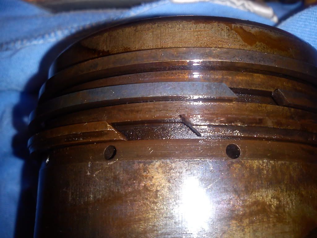

been spending a while un sticking the piston rings on the piston today , been submerging it in diesel and then applying some heat from propane torch , then more soaking a bit of taping then more heat etc etc .
Finally freed the rings off , with no damage at all so hopefully will not need to get any new rings ..
Did notice that in the bottom grove there is 2 rings in there ... what is this about a bodge or what ???
Regards , matt
Regards , matt
Re: yet another rusty lump ! Fowler 1pa restoration .
No thats your oil ring be carefull taking them off the piston if your intending to use them again
2 rings? or 1 ring with a step in it?
the end gap in the rings looks very wide compared to the ones in my petter

JONESEY wrote:No thats your oil ring be carefull taking them off the piston if your intending to use them again
Chris i am re using the rings again , I have a pair of piston ring pliers that do just the job at removing them , lent them to mike he was so impressed he had to buy a set

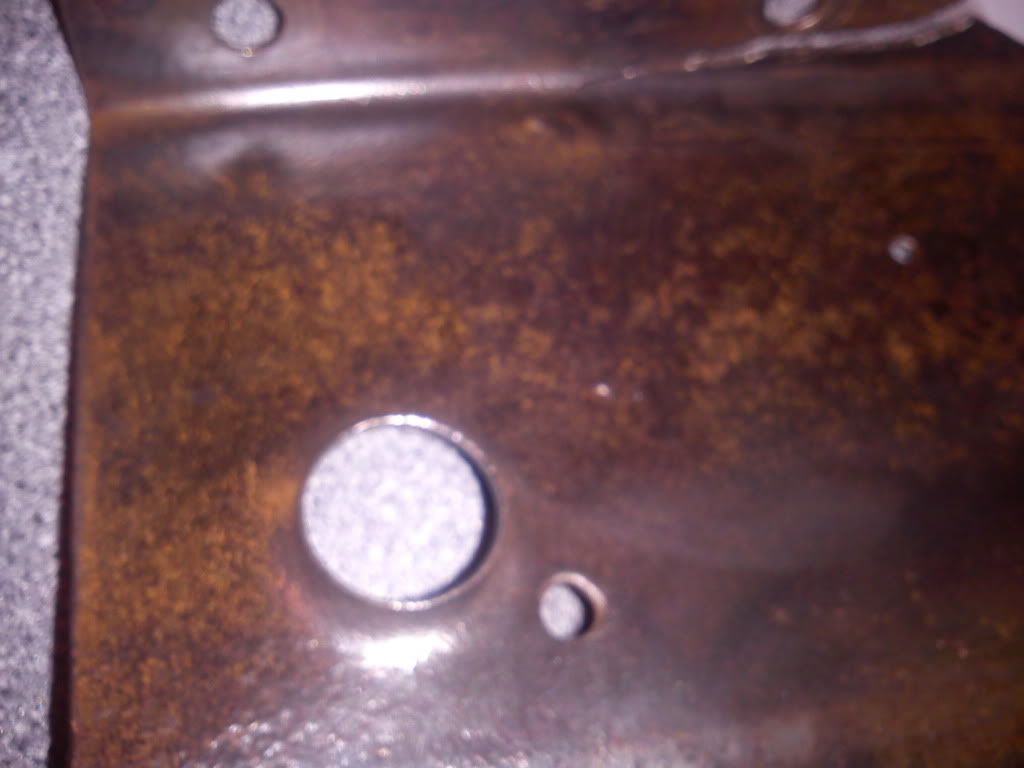

what is your opinion on rust pits on tinwork .... ?
do i skim with some filler or do i leave .... some people says adds character etc ....#

Leave them proves its done some work.

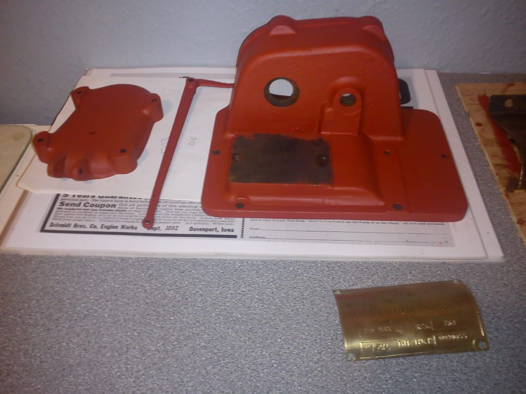

Well a little update on the fowler ... i have been cleaning up parts and painting , rubbing down panting etc .
so alot is not so rusty no more . the only rusty part left is the block . But thats another issue with having a bent crankshaft ... but one should be on transit as we speak !
here is what the final paint will look like , that is 3 coats of primer and 3 top coats . Has been rubbed down in between all coats with the top cats needed to leave at least a 3 days before doing it lightly .
Sends of a good shine , but once the engine is all together and painted you will see what i mean , at moment light is a bit dim .
Regards , matt
