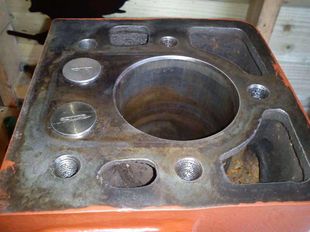

right guys i know its been some time since i have done any work on the fowler but i started to do the valves last night ,
The exhaust valve was badly pitted lapped in with batt drill and got a nice grey clean ring around the vale and the seat now I just need to finish lap in the inlet with some fine and clean out and resemble the springs and place the collets in .

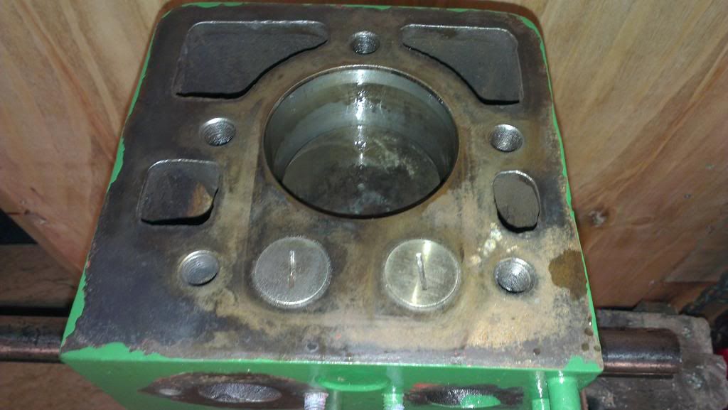

Been catching up with a few odd jobs today in the sheds and the garden i managed to get some done on the fowler .
The block is now all cleaned up and has had 3 coats of red oxide
The valves have been cleaned up and lapped in , took a while with the exhaust ... never seen pits that bad but both seal well now

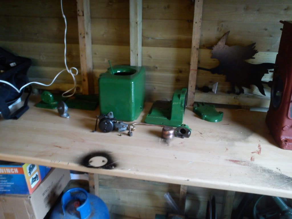

all the other parts have been cleaned up and painted , carb has been cleaned up the float bowl threads have been stripped . The only way i can think to sort this is to Tig weld holes up and drill and cut some new threads as not much meat around the holes to go next size up . The only parts to clean up now is the flywheel and the tank straps .
David S will be making me a new fuel tank . Thank you in advance David .

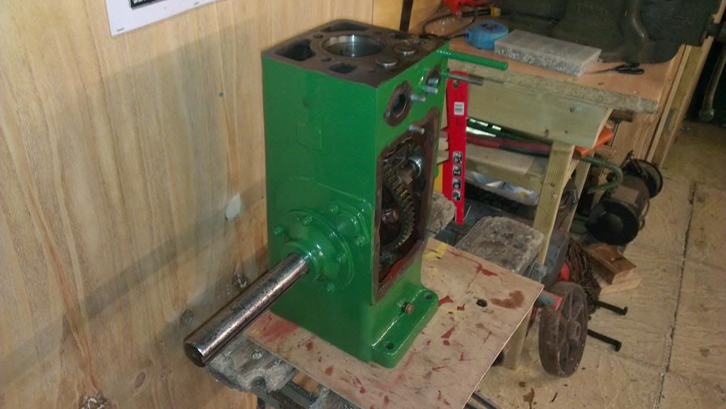

Its been months since i updated this thread , may have to go through and give the thread a good clean up .
anyway . The engine block is now painted and had time to harden off in the topcoat . everything else has been painted except the flywheel and the tank straps . Had some camshaft bearings made and a new big end made from bronze . so decided to get it all together and the big end shimmed correctly so not too tight or too loose . anyway here are some pictures ...
Had a chance to use some new tools i bought a while ago too , bought a cylinder honer and a piston ring compressor . Makes you think why didn't i ever buy these before just so much easier than using 2 screwdrivers etc .
