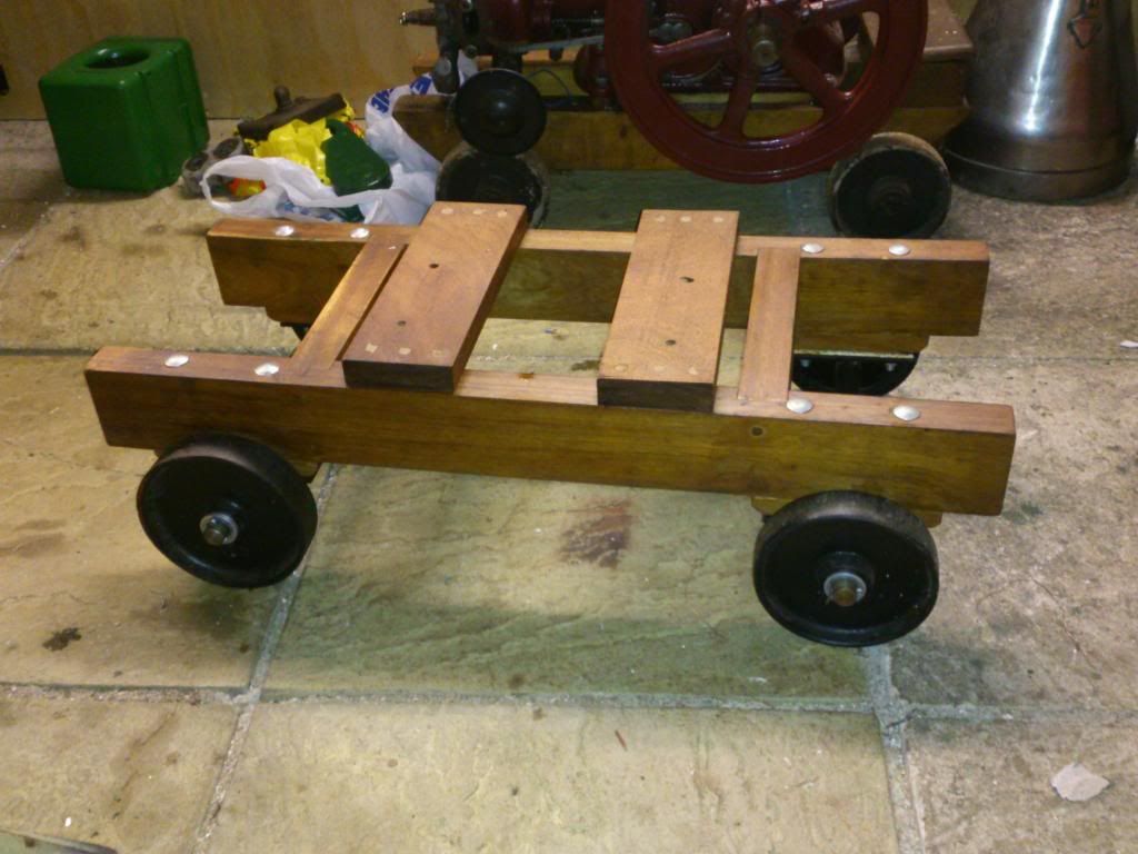

Getting back to howler i have assembled the trolley well adapted it lets say from a old trolley fitted spreader planks and oiler with 3 coats of finishing oil . Looks nice
but some numpty put the planks on upside down , so the holes are not in the right place and a few swear words came out ... Oh il have to fill them in with some sawdust and wood shavings and re drill the holes . Just because the engine is offset and got it not central on the trolley due to the crankshaft on starting side and not keen to bashing hand on trolley when cranking her over ...

You silly buggar Matt never mind it's something we all do but such a shame after all the work you've put into it. I Just hope the marks left by the hole filling doesn't look to bad.
Re: yet another rusty lump ! Fowler 1pa restoration .
The trolley is a rather rustic one anyway as a bit battered around the edges anyway and has some dowls covering up screw holes anyway lol .

That's not to bad then Matt I thought it was one you'd made using good hard wood.
stationary stu wrote:That's not to bad then Matt I thought it was one you'd made using good hard wood.
Yeah it is hardwood , il take some pictures later .

Been doing a bit more tonight in the shed .
Flywheel has been placed back on for the moment , leaving as it is until the weather is a tad warmer to paint it ... and the valve tappet block on the right way according to Fowlerfan
The trolley finished and engine placed on , just need another coach bolt and think il leave the holes might make look worse if fill them in . Im quite like the oiled look , but now and then you have to give it another wipe over .
Really brings the grain out in the Iroko too .

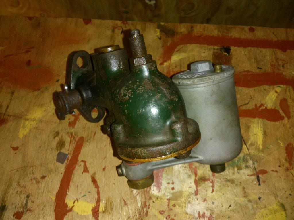

Been having problems with the solex carb and tried to helicoil the stripped threads upon doing that the carb bowl started to crumble and crack ...Yet again its Mazzak i do believe
so i have decided to do a Lister D conversion .
Been told you need to enlarge the holes for the carb to fit .
standard Lister D carb body on the right .notice the size of enlargement .

Another float bowl should be east to get hold off, it is the top part that is the difficult bit.

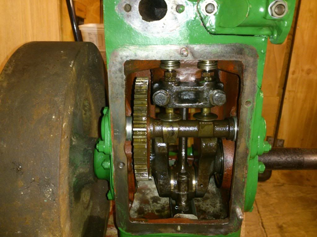

Getting back to the fowler , not much been done over the weekend , waiting to get some more washes as i have run out of 5 /16 flats .
but done a few small jobs ...
valve clearences set and locking wire all tied up
and got the crankcase cover on with a new gasket .
Thats about it , well do the new paint on the straps good and give chance to harden off . but have started to gather the parts to fabricate a exhaust silencer . anyone knowing the fowler fish tail types they are not like a common lister D . But for the 1st run have a feeling it just be a pipe from the flange .
