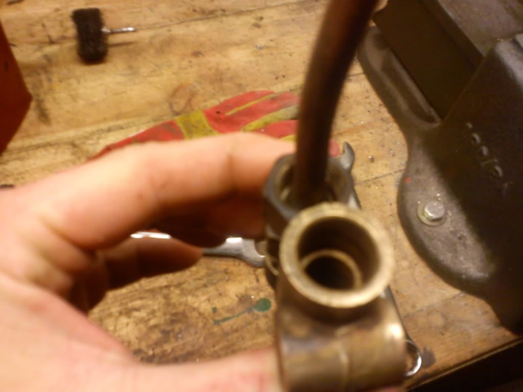

Well tonight i quickly wiped off the pump pipes and tank .
I cleaned up all the mating surfaces , and threads with wire wool and the wire wheel . hopefully they should not leak when put them back together . Also stripped the pump apart and inspecting all the parts even though i have taken it apart before , well that was a few months ago .... well a mate of mine did it . I found there is no pump packing Shocked
Here are some pictures
Im assuming the pump packing winds around the piston and sits on top of the machined shoulder in the pump body itself , then the spring followed by the piston and the pump cap ....
As well i removed the needle from the carb and there was some much / rust on the tip of the needle so i cleaned that up . Just need to blow through the jet before i assemble it . hopeful all that should cure my problem . I dont think there is any point lowering the level of the return pipe . My theory is that i have never touched it and has not been touched in 40 years and probably not touched from when it was new . All the times i have had it running in the past it has not dribbled out of the carb , so i will jsut put it back together and see . Apparently you are superposed to run the engine half on choke when not on load .
Regards , matt
