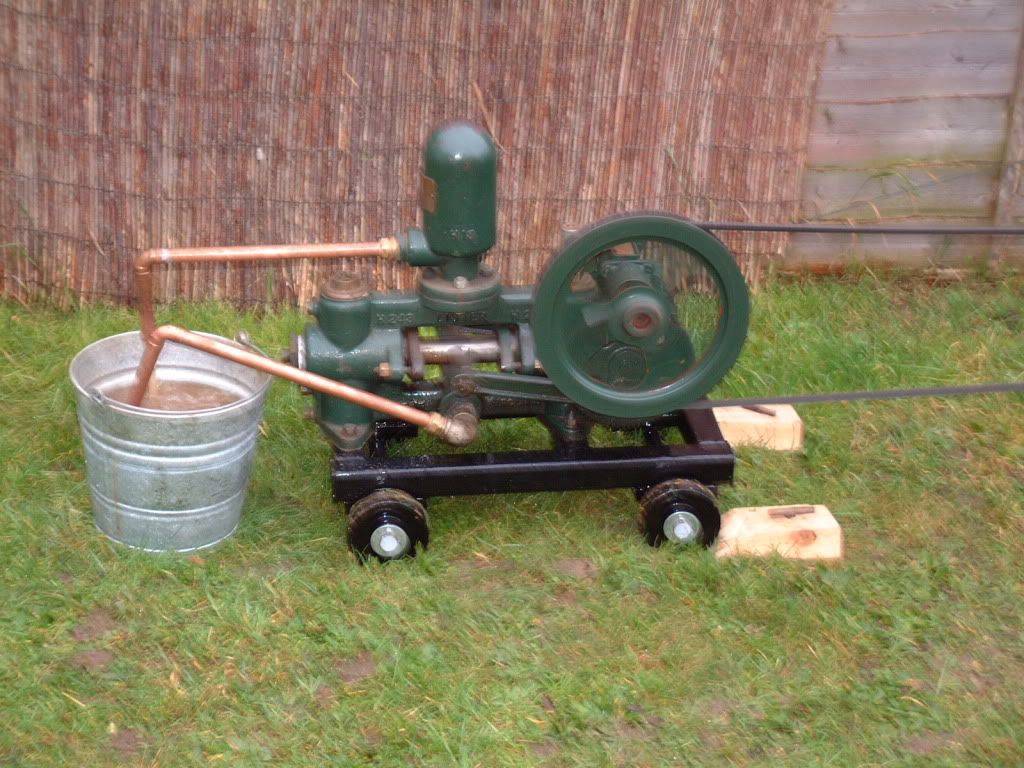

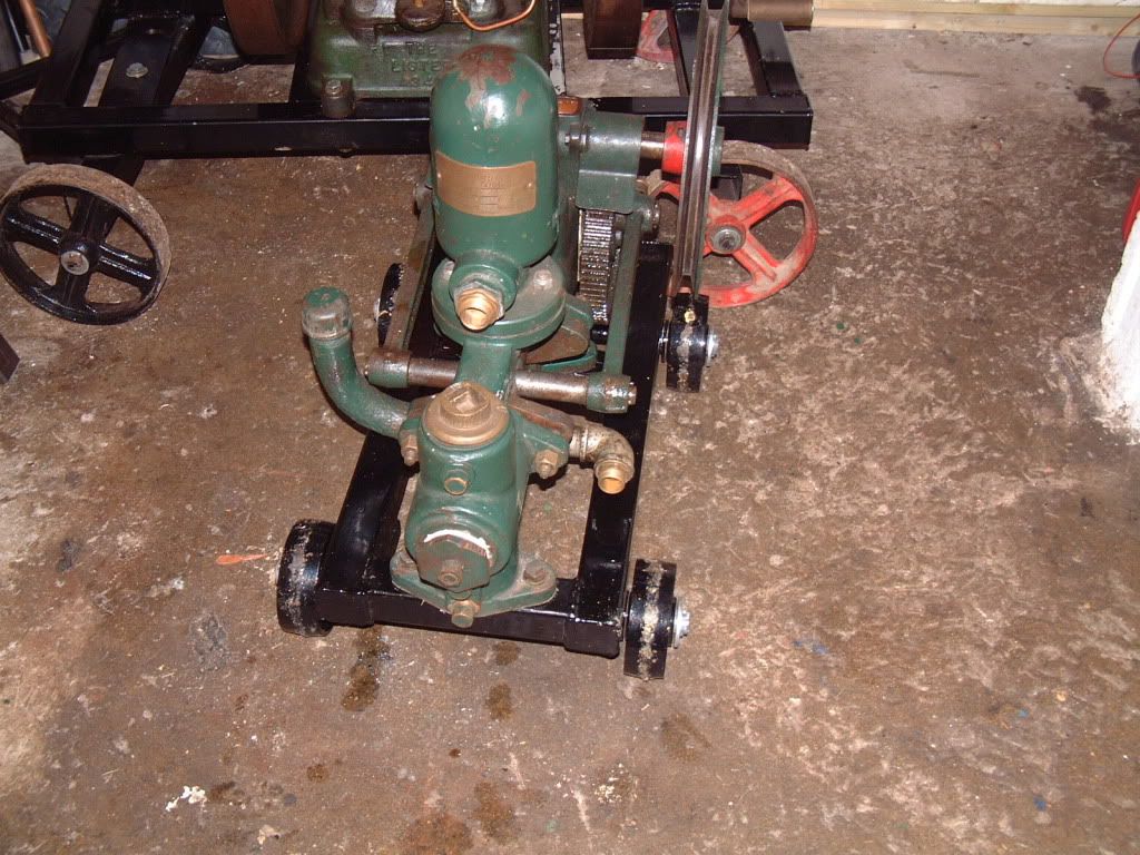

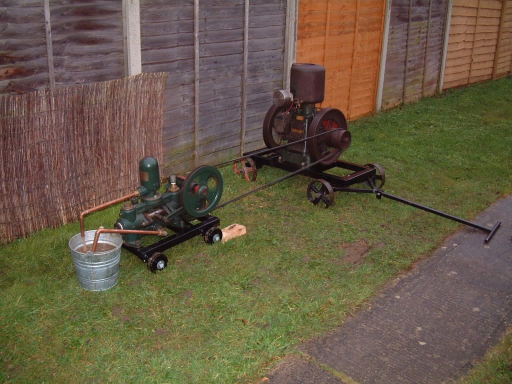

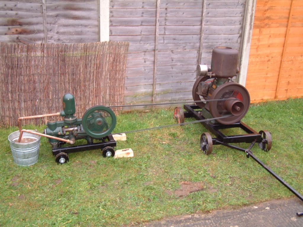

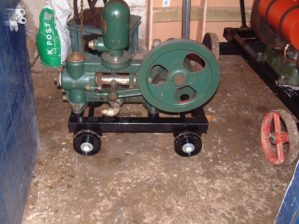

As you can see i have finally finished the trolley and put the h2 pump on it ...think it suits it quite well , all i know all that metal is a heavy lump lol!
also noticed that somehow ive broken the bracket of the steering ... I think some modification will be in order ...A different arrangement for the steering would be better i think . quite a lump to pull about .
Regards , matt

your right there mike ... us young uns can manage it , notice where your wheels are now .. lol!
hopefully soon mate you get the go ahead and can get the concrete down and the shed build started and then you will be away cross fingers mate .
When the weather gets better i must paint those wheels black as well looks a bit odd lol Laughing

Matt is the A running ok now? You happy now with it? Good to see a set up all running just miss the sounds and smell, might have to see if I can at least get a small engine out and running.(need my fix lol)
Re: A few pictures from the new year crank up of the A !
Post by matt86 on Mon Jan 02 2012, 14:41
its running alot better now , does weap a tiny bit from the carb when on load but nothing to worry about and the load wasn't a heavy one really .. It does leak from a soldered joint on the pick up pipe from the tank to the pump though so i think il have to make up a new pipe .
Does anyone know what the size of the thread is that goes into the pump where the banjo bolt goes into ?
cheers , matt
