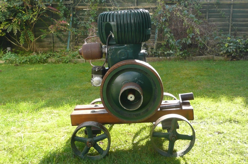

Just having a go at posting the promised pics
Couldn't resist having a peek inside the valve chest & both valves appear to be popping up & down as they should, so now I presume lack of compression must be due to valves not seating properly, so will be ordering new head gasket ready for strip down.
Cheers Tony.

Looks great thank for posting photos

hi tony..
thanks for sharing the photos with us all..
looks like you have a WD8 tank on the engine,so it mite well be a WD8...
looks like it a straight forward job for you...

mike its not a wd8 tank , looks like a petter A1 tank remember my wd2 had one on ......

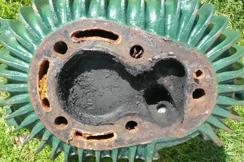

Removed the wd8 head today & inside its not a pretty site, but once I cleaned all the gunge away which was soft as sh*t things don't seem so bad. there is no burning on the valves & they seem to seat fine, my question is what tools will I need other then a sucker stick & paste to remove the valves, ( is a vale spring compresser needed ) for a wolseley.
Cheers Tony

Just a screw driver and a pair of plyers, sit the head back on then leaver the valve spring up and pull the dowel pin out
Re: My first water cooled engine.
It's a bit fiddley Tony and you need to take the side cover off behind mag (one bolt holding it) and careful you don't loss anything.
Stu
Stu

Thanks for the instructions Stu & Jonesey, I spent a few hours on the WD8 this weekend I ground in the valves & replaced the head gasket with a copper one, it's turn out to be a great success, I nearly fainted with shock when she fired up on the third swing and running a treat
Now going to start the repaint & hopefully she will be ready to show in a few weeks time.
Happy Days, Cheers Tony.
