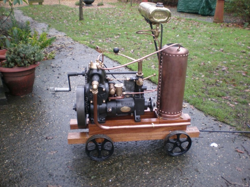

Post by Abes on Thu Feb 16 2012, 20:22
Was told to put some pics of my engines up so here you go hope you like
and my newest purchase and this one will be painted

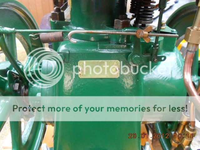

Abes, looking at the pics of your A to me it looks like the spring on the throttle linkeage is far to tight and the govenor rod/ throttle rod dont look right compared to what mine were, it may just all need setting up and adjusting,

Re: My Engine pics
Post by ian webb on Thu Feb 16 2012, 22:05
Abes look at the difference in this set up on my old engine, and this ran lovely, like i said ill come over and have a look for you

Re: My Engine pics
Post by Abes on Thu Feb 16 2012, 22:08
Think you might be right ive never been happy with how its set up when i got the engine the whole thing was in bits so its been trial and error putting all the bits together in the right order and place and not having access to another to compare its been a steep learning curve, ive only managed to get as far as i have done with help from forum members

Post by ian webb on Thu Feb 16 2012, 22:21
Abes, this was my set up, this is what makes me think yours is not quite right,

Post by matt86 on Thu Feb 16 2012, 22:33
Me and ian dont think you have the throttle / guvnor rods set up how they should be mine is like Ians , try a shorter spring , and those rods look a little on the long side too think the slide plate is closed rather than open .
Oh and ian , another thing that has come to my attention before a coil re wind is the guvnor weight springs ...! i might have a slightly weak guvnor when gets upto speed . The springs have not been touched .... left well alone . Might have a look at that but il give it a long run and do what said 1st mate .
abes if you want me to measure my rods i can do mate .
Re: My Engine pics
Post by Abes on Thu Feb 16 2012, 22:33
yer see what you mean though the rod that held your spring looks a lot longer than the one fitted to mine

Post by matt86 on Thu Feb 16 2012, 22:37
Abes wrote:yer see what you mean though the rod that held your spring looks a lot longer than the one fitted to mine
Thats adjusting rod on Ian's old A is not the original and is alot longer mate , mine has the original one , alot like a d one .

Post by ian webb on Thu Feb 16 2012, 22:43
Matt how do you know mines not the right one and maybe you two have the wrong ones, lol, whichever its gonna get sorted for him,
hope you sort yours out but dont think you have anyhting to worry about,

Re: My Engine pics
Post by ian webb on Thu Feb 16 2012, 22:45
you can also make them ive made them for D's just an old tent peg and cut a thread saves money every time,

Post by matt86 on Thu Feb 16 2012, 22:47
ian webb wrote:Matt how do you know mines not the right one and maybe you two have the wrong ones, lol, whichever its gonna get sorted for him,
shhh Ian your spoil my assumption Laughing well mine was pulled out of a shed and had been in there for 40 years .... so thats my guess your looks too new well it does the job so that's all that matters lol
But there more i think it could be the guvnor weight springs .... or thats might be trying to run it too slow ... compined with the plug issue ... but it never stops so it be fine to take to a rally anyway .
il have a look over the weekend . matt
