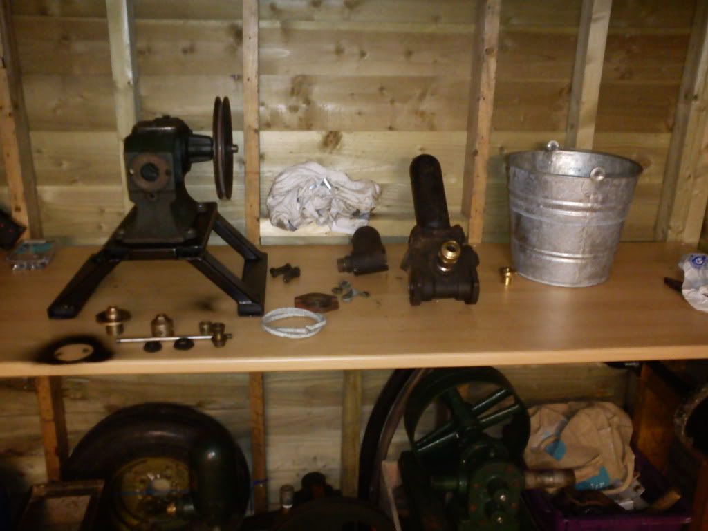

thought i should get some pictures on how the progress is going ..
all the bits i need on the bench

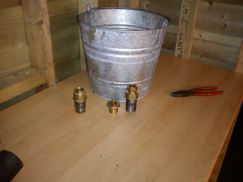

the pump bolted down on the stand , in the background is some new fittings and adapters . I have chose to go 22mm copper as easy to work with in my opinion . I have 1" nipple to a adapter to 22 mm and have a 22mm tank connector . I have the copper pipe and fitting as well .
i plan to use a galv bucket as a water tank due to only a small pump so a big galv tank would be out of place .

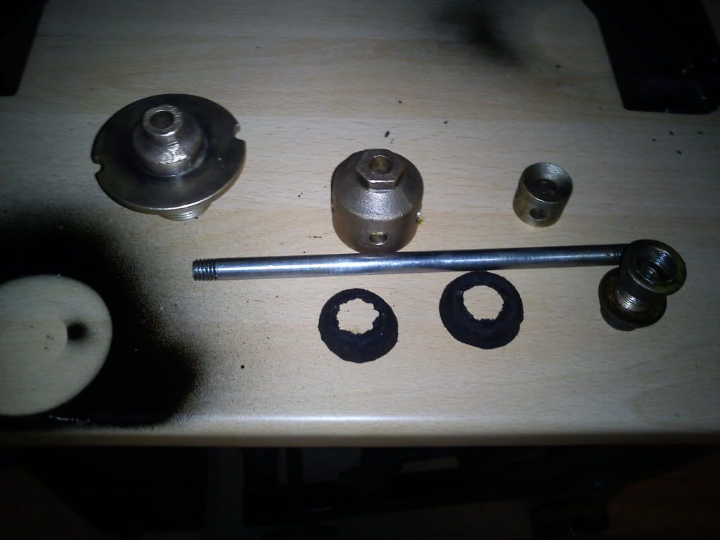

all the parts for piston , conrod and glands all cleaned up waiting for leather cups now .
As i said previous the pump is staying in original paint . Il just rag it over with a oil rag to preserve it .
Regards , matt
