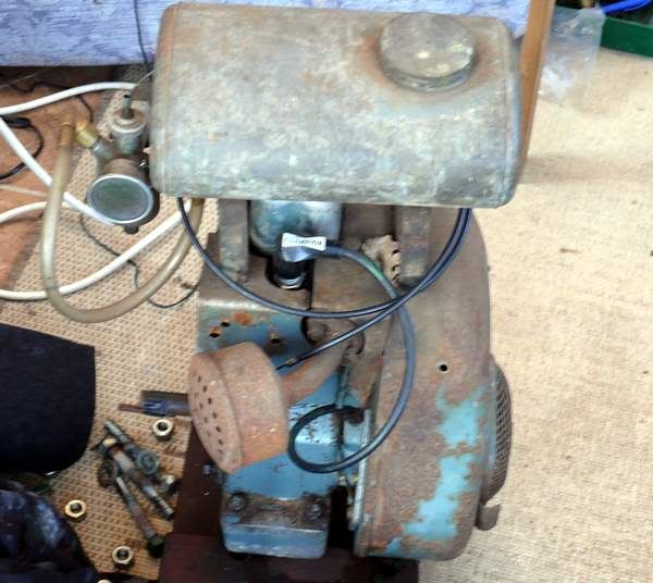

something for me to play with away from the workshops
looks like it was on some sort of rotavator
Re: new toy .......Villiers Mk15
Post by stationary stu on Mon Mar 12 2012, 11:32
Nice looking engine Neville looks to be all there and your correct it is out of a rotavator or something similar. There is a lawn mower forum that might be able to help you if you need more info on it. So is it a runner? whats your plans with it? the tin work all looks good so it should clean up well for painting.

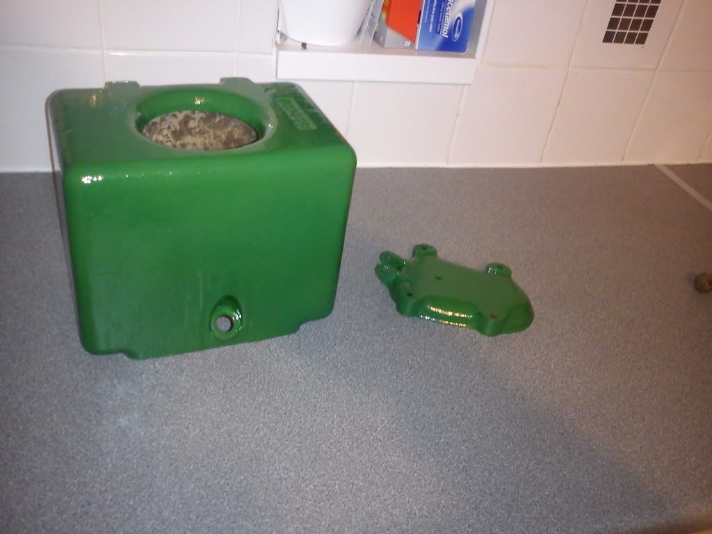

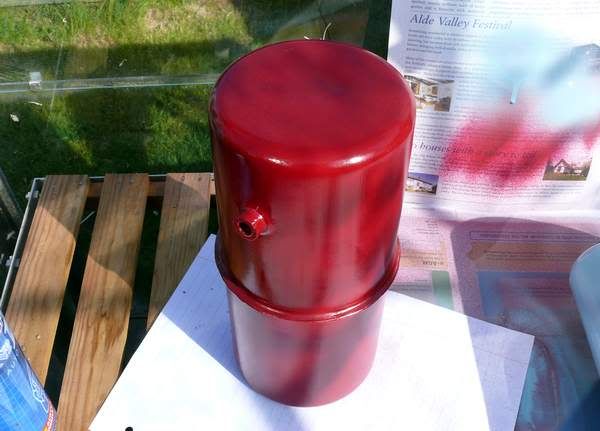

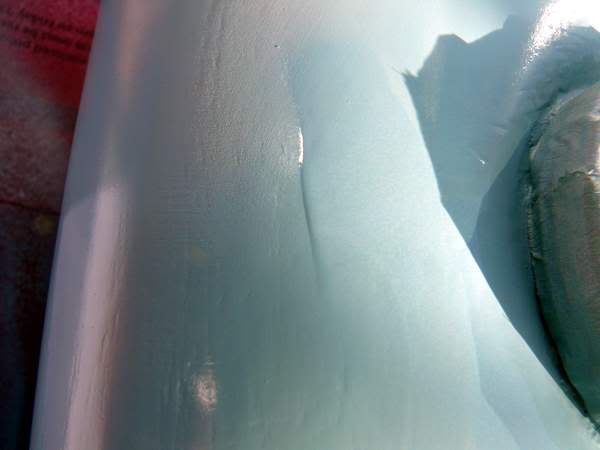

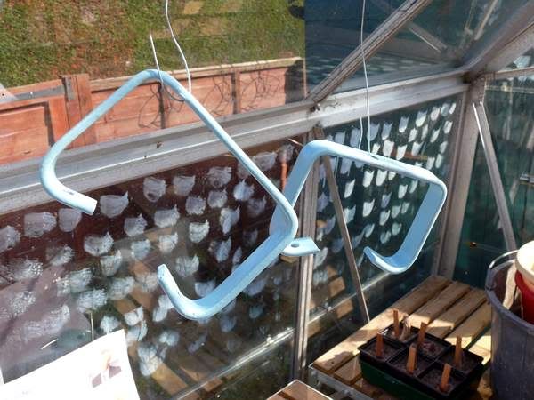

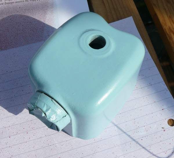

not much time to play with this so far but i did take the petrol tank and rocker cover off and clean them up for painting, after 3 coats of primer and a sand down I'm ready for my first attempt at spray painting for about 15 years Shocked
started with a petrol tank from a scrap Mk 15 i was given for spares (the spray paint is 15 years old too) Laughing
I bought a couple of cans of Ford Nordic blue for the main engine (looks about the right colour) from halfords the other day...................
the rocker box is not too bad
petrol tank brackets could be better but not too bad
not too pleased with the petrol tank though..................
i need to sharpen up my skills a bit on this.............maybe i'm holding the spray can too close ??
a rub down before the next coat should cure that though.................
Still it was nice to be back in the greenhouse though on a nice sunny day Cool (i will lose my spray booth in there in a week or two when i move about 300 plants back in there) Rolling Eyes now i have blue fingers instead of green Laughing Laughing
i was wondering, would it be a good idea to spray on a couple of coats of clear lacquer after painting to give a better finish?
A lot of fuss for a 22 quid Villiers i know but i want to get this painting lark right before i do the national F type next year.
time to put them back in the airing cupboard to harden off (warmest place in the house)

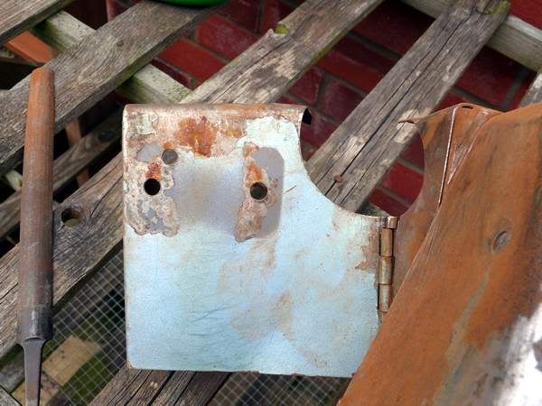

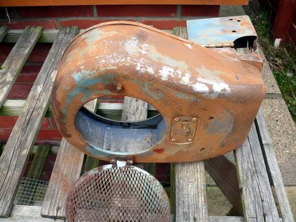

Post by hob on Fri Apr 06 2012, 19:00

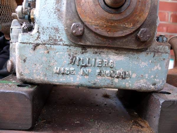

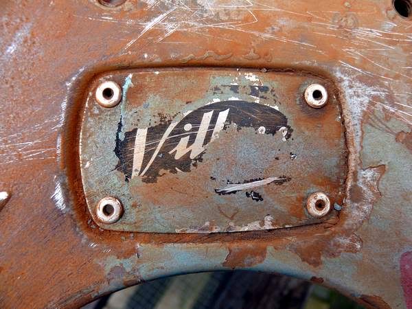

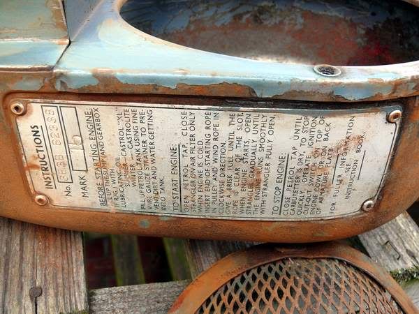

took the cowling off today, trying to sand off the rust was hard going, so i put the sandpaper away and used a small file instead............i had a bit more luck with that but its still hard going.
i managed to unscrew the makers name plate and cleaned that up.
not sure on the best way to remove the villiers plates though, may be best to drill the rivets out?
I'm going to have to try to find another transfer for that last one.
anyone know what is missing from this bit? another name plate maybe?

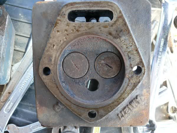

found time today for another look at this ..........................finished painting these bits and a coat of lacquer.............
took the head off too ...........looks better than i thought
i need to get the piston out for a look at the rings as the compression is not what it should be ..........
moved about 300 plants to their summer home so now i have a bit more room to play.............
looks like the barrel is part of the base casting so presumably i will need to take the sump off and undo the bottom of the conrod to get the piston off for a look at the rings .......................... not much compression when i looked at it......................... and no spark so not a simple restore ahead of me.
Neville

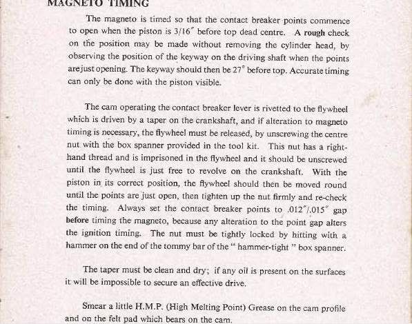

there seem to be all sorts of modifications made to the engine for use on the cultivator, i read the book i downloaded to see how to examine and set the mag.....................
timing and points setting seems to be done with the flywheel in place through some cutouts in the flywheel................
really ................ Rolling Eyes Rolling Eyes
had a look at the flywheel with the piston at TDC and it looks to be set about three eights before TDC at the moment, there is no spark at the plug either............. Rolling Eyes

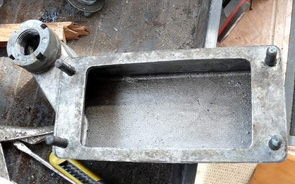

oh well i thought i'll remove and clean out the sump instead................the sump is also not an original Villiers part either Rolling Eyes being made of cast alloy of some sort poorly cast and badly finished with a Charles Munro casting number on the bottom...........bent my thick 12 inch rule trying to remove the sump plug so just gave up and took the whole thing off and poured the oil into a jam jar instead.
