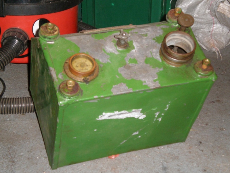

As requested a quick update on tonights progress, fuel tank and fittings all removed as is the top part of the exhaust and down pipes and the ali head cover, drained the fuel tank down as it still had fuel in it, inside the fuel tank looks spot on which is more than i can say for the fuel which was a dark brown colour and stank

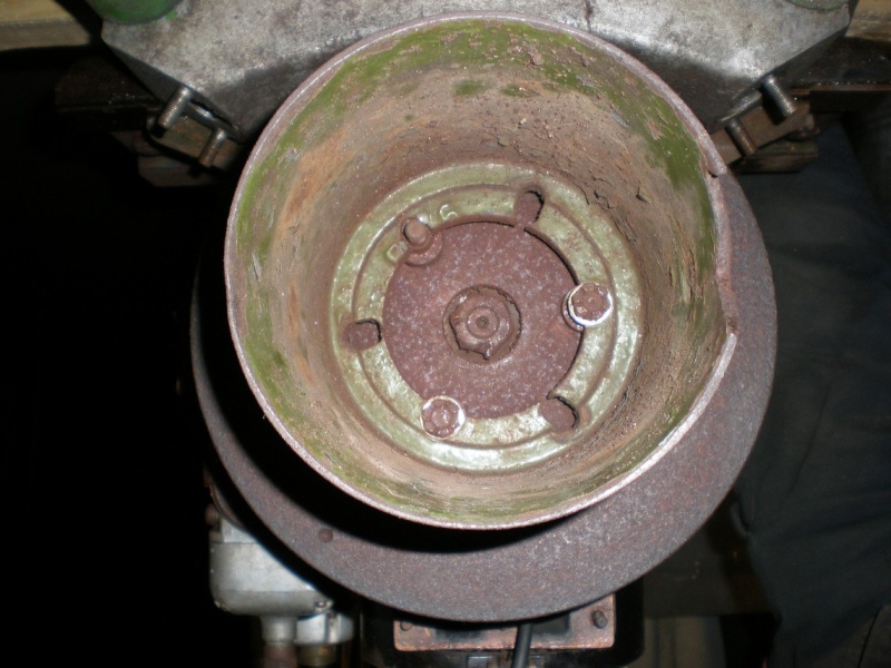

Matt many thanks for the paint colour info very much appriciated i shall chase it up when time gets a bit closer to needing it, have started stripping and cleaning the removed parts up today, have decided to prep everything as i take it off this time, see pics below, one quick one thought i would remove the pulley and flywheel today but have hit a snag manage to get one of the pulley nuts off but the other two are just rotating ie nuts not coming off, now theres no way to hold the stud to stop it rotating so that i can undo the nut has anyone got any idea's of how to over come the problem

Abes could you (carefully) wedge a screwdriver or similar between the pulley and flywheel where the nut has been removed to tilt the pulley slightly to trap the studs while undoing the nuts? Or maybe get some heat on the nuts to free things a little?
Re: Scott PAB Restoration
Post by Abes on Sat Mar 17 2012, 21:53
No chance mate as it appears the pulley is very slightly recessed into the flywheel, heat might be an option but i still would have the problem of the whole thing rotating, a mate suggested spot welding a rod between the two remaining studs to hold them but not that sure my welding is up to that lol

Abes they must be bolts not studs if they were studs they would unscrew, so is there no way you could get at the back of the flywheel? Other option is split the nuts with a sharp chisel if you can get one in.

Post by Abes on Sun Mar 18 2012, 18:09
Had a look today, checked the back of flywheel nothing visable, not enough room for hammer and chisel think welding might be the only option.

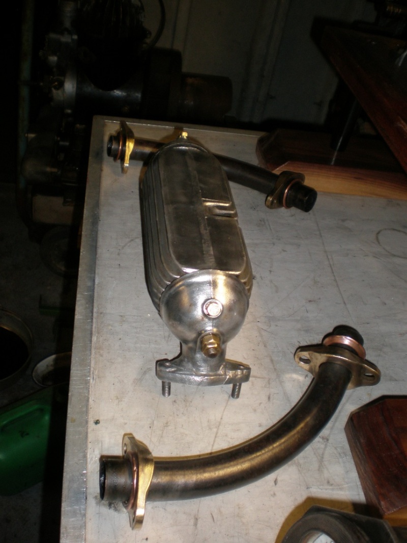

Managed to get some more done today, stripped off the exhaust system and tinware, also managed to strip and clean exhaust system, tinware and tank, pics below

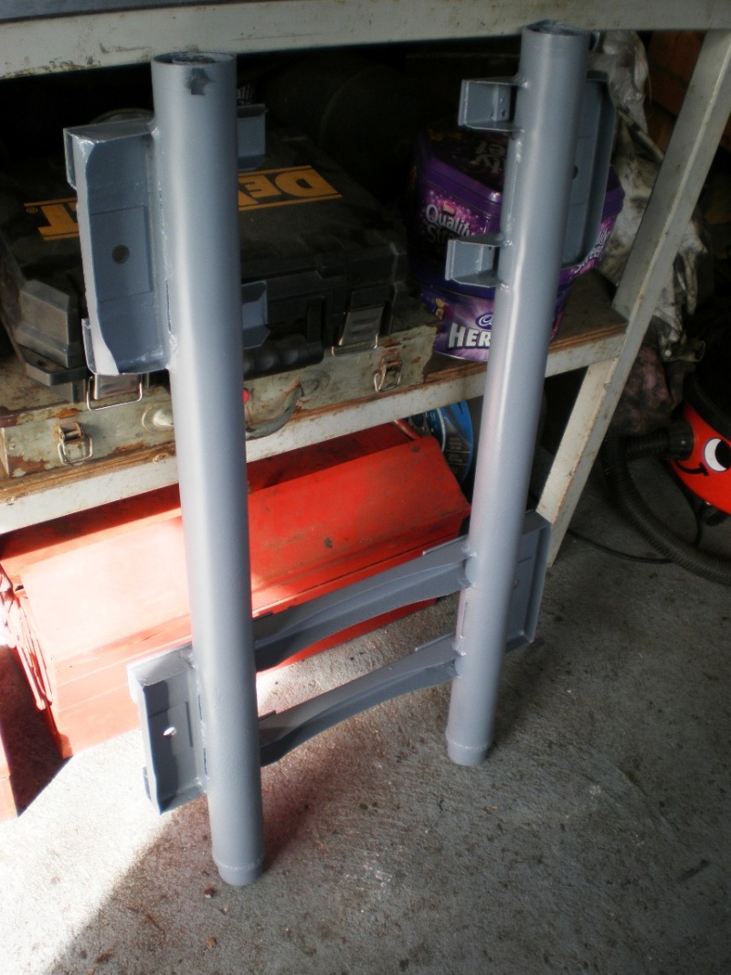

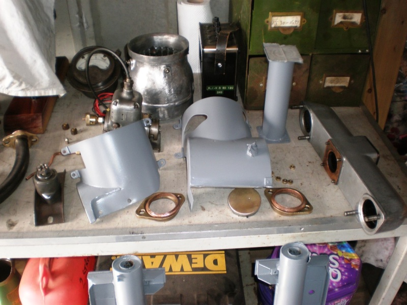

Been busy today managed to remove the flywheel and pulley (ended up spot welding the bolts to stop them turning) which have been stripped and cleaned have also managed to finish preping all the other parts that where outstanding also managed to primer everything, the only bit left to sort now is the main engine block but thats just a clean job, pics below

Regarding the nuts i would try and split the castle nuts if you can .
