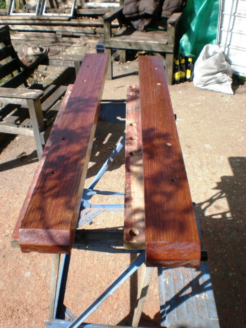

Well as promised here's some pics of todays efforts, after doing some homework on paint colour decided on "Ford dark aubergine" managed to get some from Halfords they only had a couple of tins so bought them both will still need another 2 tins to finish the job, well with the 2 tins i had ive managed to give all the tinware 3 coats of paint also gave them 2 coats of laquer, whilst waiting for them to dry thought id make a start on the skids, had some mahogany (an old door frame) knocking around the shed which fitted the bill so they where cut and planed and then given 2 coats of varnish, last job of the day was to start putting the exhaust system back together. pics below have only put one pic of tinware just to give you an idea of colour and finish

I see you've been busy again Abes and doing a great job. I like the colour of the tin ware weather it's right or wrong it's your choice mate. Nice find with the wood for the skids all I've got in my shed is a bit of 1/2 ply not quite the same.
Re: Scott PAB Restoration
Cheers mate, must admit the paint colour was a hard choice did not want to do it drab green from pics thats what the orignal colour would have been so opted for using one of the colours that Scott used on there motor bikes instead i know its not a purist thing to do but at the end of the day it was light green and black when i got it lol ref the wood do what i do mate go to most double glazing firms and raid there scrap wood piles most of them have to pay to get it taken away, ive found door sills fit the bill the best
stationary stu wrote:I see you've been busy again Abes and doing a great job. I like the colour of the tin ware weather it's right or wrong it's your choice mate. Nice find with the wood for the skids all I've got in my shed is a bit of 1/2 ply not quite the same.
