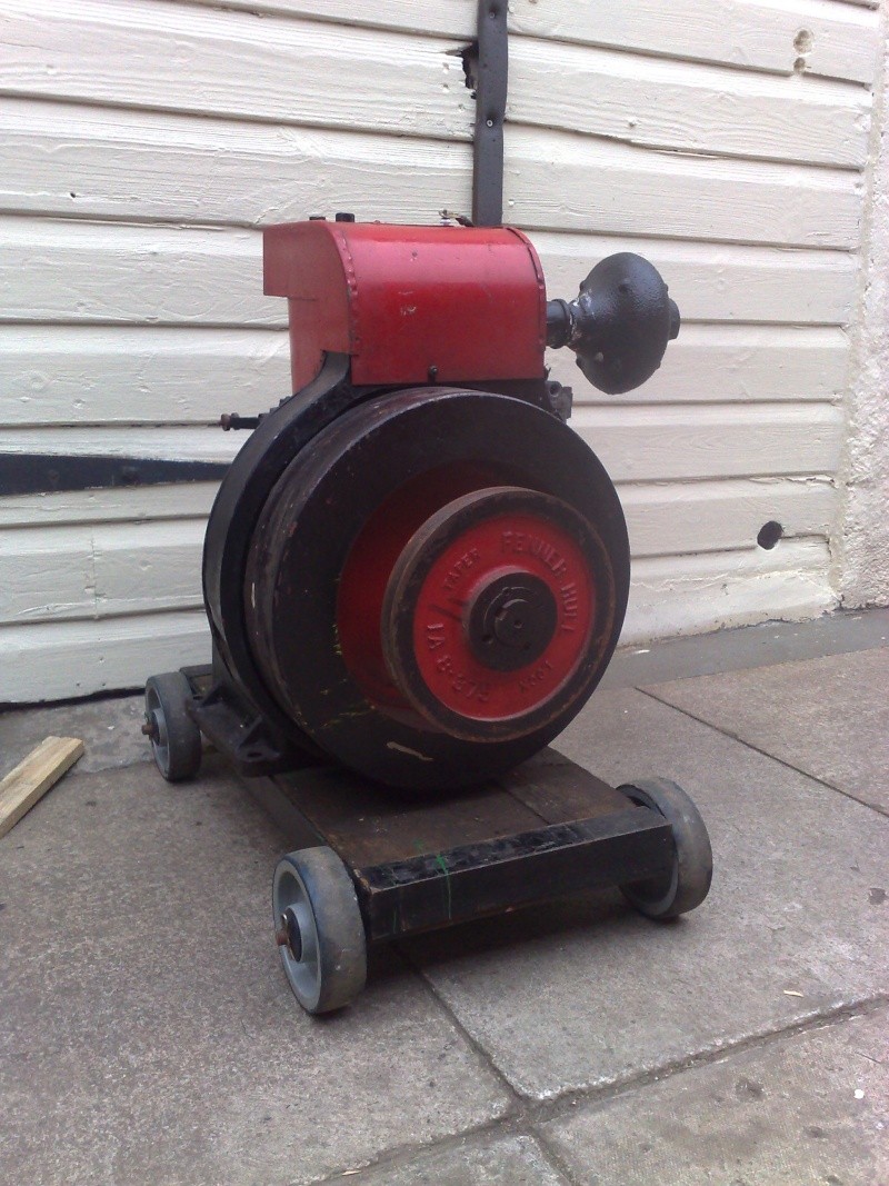

i've just bought a 1943 petter a, it spent its working life in a milking shed in the dales.
pics to follow.
richard.

the engine does have a petrol tank, its in the shed. just started to uncover the bodges i will have to overcome, firstly someone has tried to araldite the fuel line into the carb, more to follow as i find them.
richard.

complete
Post by earlsinclare on Mon Apr 02 2012, 07:45
with tank.
richard.

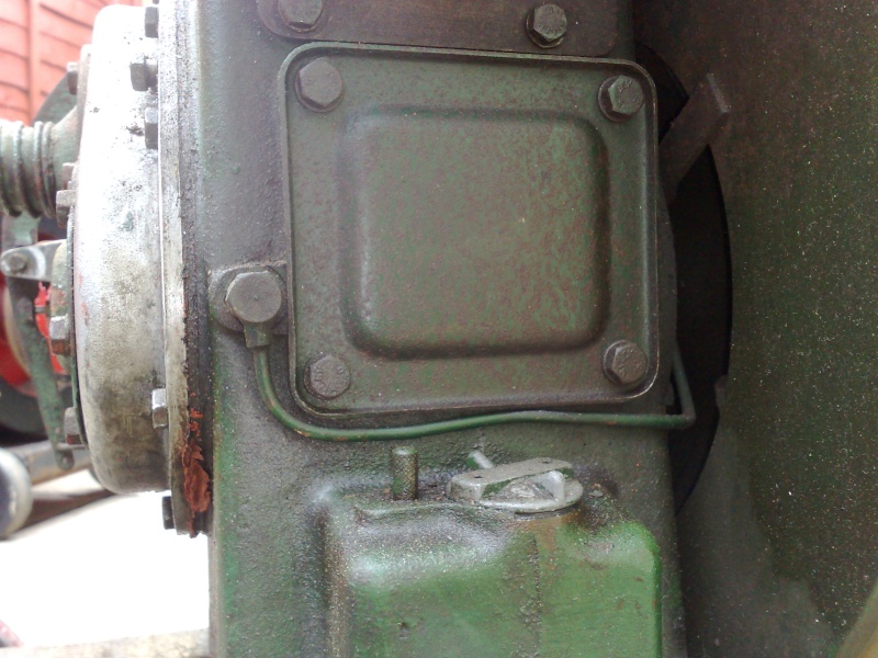

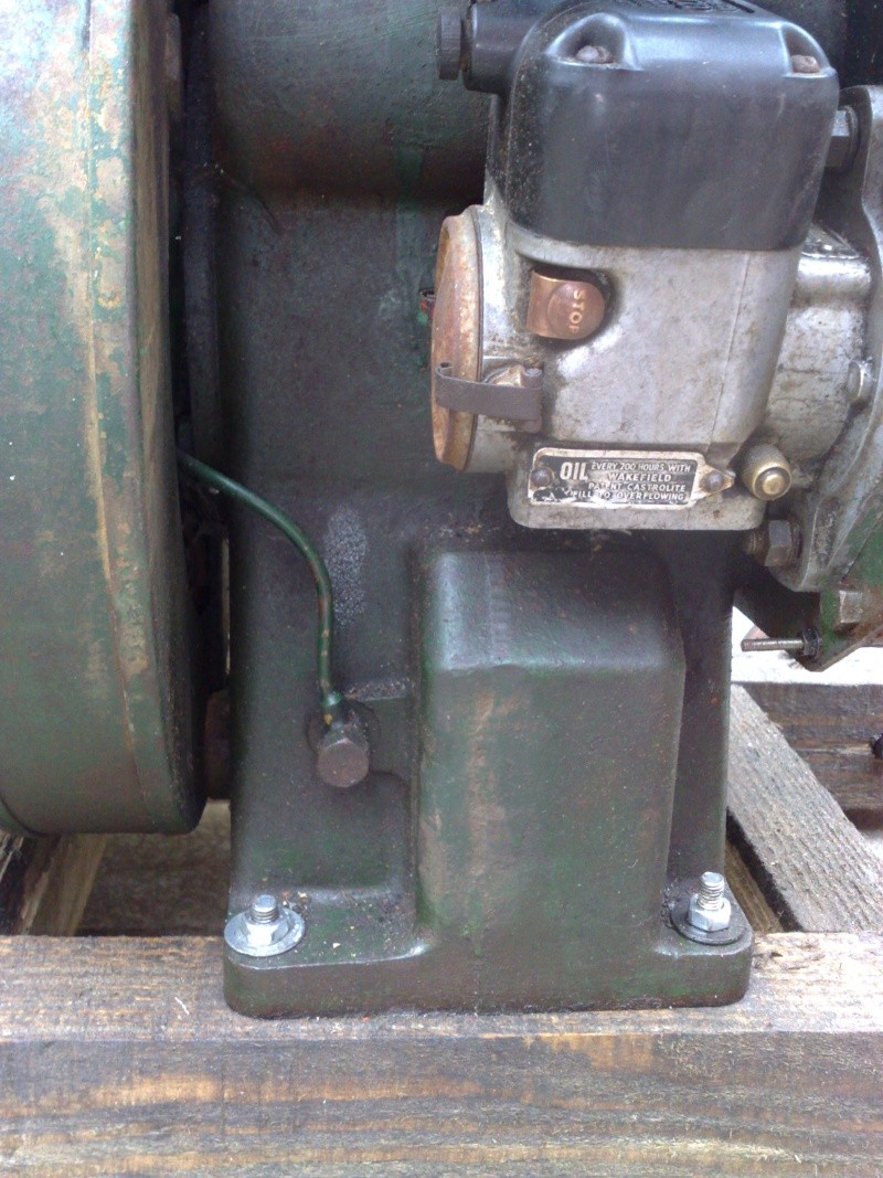

I believe that the 5HP models had the same bottom end as the PAZ1 diesels Stu, they had an oil pump and external oil pipework.
Re: petter a 1943
Post by earlsinclare on Thu Apr 12 2012, 16:47
the bottom end is the same as a paz1. the pipework is on the outside of the engine.

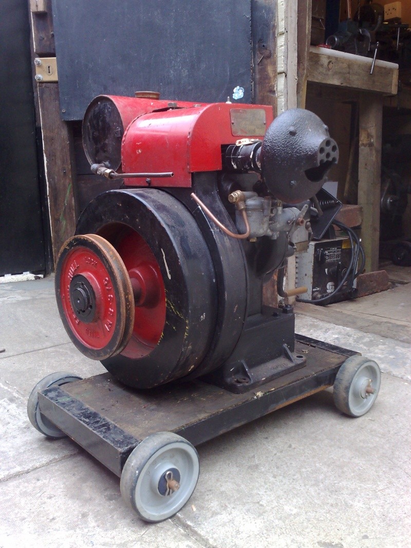

my 5hp petter.
Post by earlsinclare on Thu Apr 12 2012, 16:56
richard.

Re: petter a 1943
Post by stationary stu on Fri Apr 13 2012, 10:25
Thanks for the info guys I'll have a look and see if it has the external pipes. Are the 5hp very common or did most people go for the diesel Petter when it was the bigger hp? I'd like to find out some history on this engine as the area I picked it up is agricultural yet it also a small but busy fishing town 2 miles away so it might have some interesting history.
