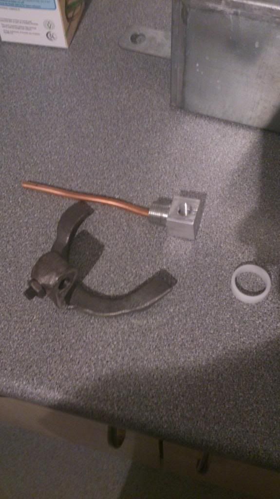

Hello all , decided to have another bash at the IHC today as it needs many parts and one of the parts needed was a new or 2nd hand guvnor bob weight carrier as was damaged and im not risking welding that with centrifugal force that sounds it could be dangerous . So i have just bought one off ebay.com , just waiting for it to get here . But the problem was that the pulley was stuck on good and proper ! has alot of heat on there soaking for months now . In end i decided enough was enough and took the grinder to it and 6 discs later it was off Twisted Evil
haha nothing will beat me Laughing
just cut the pully face off came off in a ring , then cut 2 slices opposite to each other that was just above the crank so the disc was horizontal , once the way cut a few taps with the chisel made a nice crack . Then got driven off from behind with a drift , Flywheel is off with guvnor bits .
that's all i can do for now until the bits arrive but have a few bits to assemble on the exhaust cam and rocker assembly . I did have the crankcase cover of the other side , scraped alot of the grease out as no oilers except the upper cylinder one . and had a good look at camshaft and gave it all a clean and replaced and re timed up .
Here are my efforts today ...
gave it a clean up too with a rag and some gt85 , just wanted to clean paint up and retain the original ish look without going to town with gear oil slapped over it .

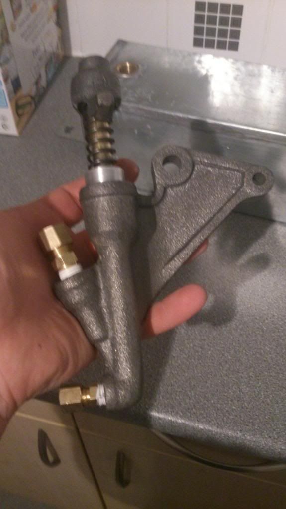

while im waiting for some more bits to arrive from the states for another engine i have decided to pull my finger out and get on with this one ....
the guvnor that got from ebay.com took it apart and lubed it up and is now on the flywheel waiting to go onto the engine . just got to put a couple of the bolts in the crankcase that holds the bottom half of the main cup on the right side . Bolts go in through the crankcase and the only way is a inspection hole and the rear of the engine Mad
bit of a tricky job and a pain when comes to tightening them up !
and i have made a list of parts also what i need , so il be sending off yet another order to US this one will be a fairly large box actually Very Happy Be around £180 worth but got lots of bits like fuel tank , fuel pump , lots of fuel fittings too lots of small odds and ends too .
Have to wait and see what the vat/ duty will be on this one Sad
