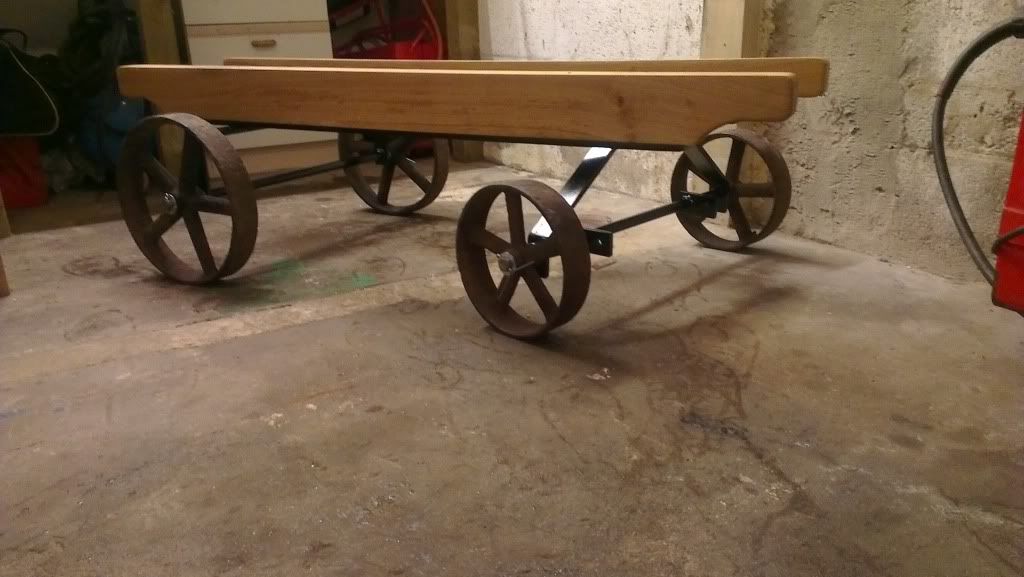

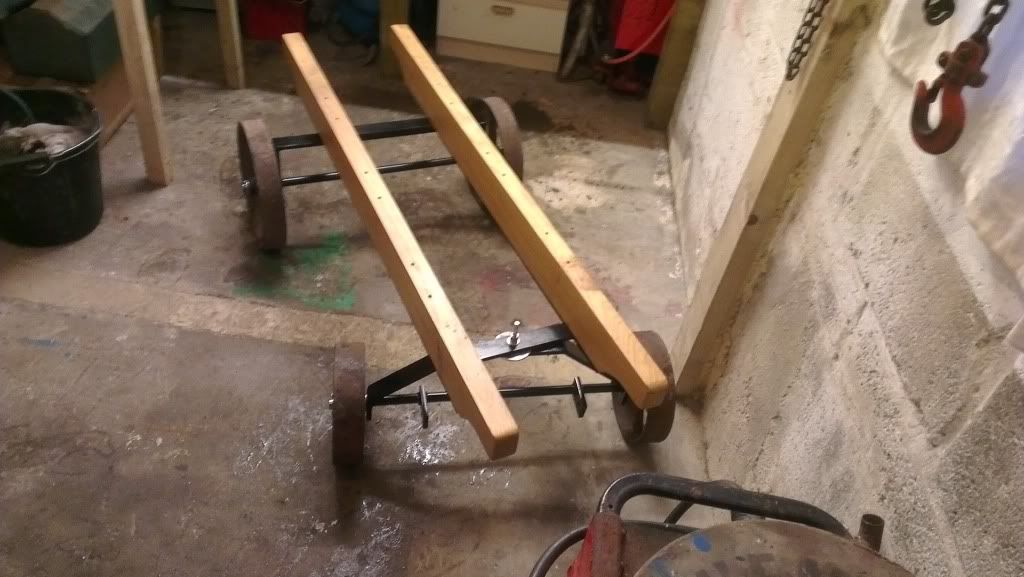

the wooden frame that had off you when assembled was 1 " wider than my gate , so im having to re design but still using the oak bearers .
Age : 30

Looking good Matt should do the job fine and you can't always stick to original plans when you have gate ways to get through.
Re: International M trolley building & restoration
Post by matt86 on Thu Aug 02 2012, 15:56
Thanks stu ..... Try to make it look like a typical american trolley design but practical .
steering is fantastic .... i shall be making more like that in future ....

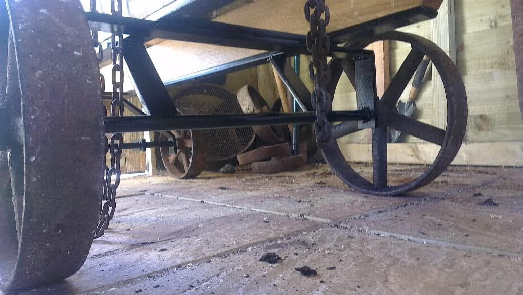

Post by matt86 on Thu Aug 02 2012, 19:36
a few more pictures lads ...
Managed to get the metalwork primed last night , gave 2 coats of black after work . Got the bearers attached to the metalwork . All i can say is that its starting to look pukka !

Post by pauldg on Thu Aug 02 2012, 20:11
Looks good.
I would have one personal reservation though, and that is the steering pivot. Pulling that with an engine on over possibly rough ground or down a ramp off a trailer or something will put quite a bit of force into that, due to the lever action caused by having the centre of the axle so far from the pivot. If I was doing the same sort of thing, I would've attached a disc at least 6" diameter to each crossmember (where you have the washer) to spread out the load and make it more of a pulling force than a bend on the pivot bolt. Or made the axle supports triangular with a flat top (axle on the bottom point of the triangle, front and rear).
To be fair, it's unlikely to be a problem and I tend to overestimate toward the cautionary side. I'd be spitting bullets at myself though if the front axle pulled out flat when a rear wheel caught on a clump of grass or sunk in a damp patch while I was pulling it. Or if it collapsed under the trolley while it was going down a trailer ramp...
Feel free to ignore me, or tell me to shut up Laughing
Age : 40
Post by matt86 on Thu Aug 02 2012, 20:20
Ok paul ... shut up ! Laughing Laughing Laughing Laughing
i can see where you coming from but how often will the engine be pulled over rough ground ???? my garden is flat grass or concrete same with the drive ... normally the rally field is not too bad ...
If you look at other american engine front axle frames are plenty like that but without the big washer welded in there just turning on the framework ..... so if that ok for many year this be well up to the job ....
If the bolt bends i will just drill hole bigger and put a bigger bolt in Laughing Laughing
Oh and Kev i would make more trolleys but its the cost .... ok if you got plenty of time on your hands as its for yourself but if making for someone else would be too expensive...
I know some point i will be making a few stock sets of the cranked axle frames . as can use them for front or back but il invest in making a jig .

Post by pauldg on Thu Aug 02 2012, 20:32
matt86 wrote:Ok paul ... shut up ! Laughing Laughing Laughing Laughing
I've seen a fair few like that, and I wouldn't trust any of them Laughing
Seriously though, I'm sure it'll be fine - it's just if I make something to carry 100kg, it's likely to be able to take 1500 - I seem to like webs and braces.......

Post by matt86 on Fri Aug 03 2012, 17:40
been finishing it off today and got the engine placed on not yet bolted due to need to lift it off when get the fuel tank ...
Anyway some pictures ...
and here is the gap that i have to get it through .... and how its easy to get through with the 360 degree steering ...
also i decided to put a few braces on the back axle to the main frame ...

Post by pauldg on Fri Aug 03 2012, 19:36
Surely that's just adding weight? tongue
Actually, Looks really good with the engine on. (That pivot still makes me go a bit 'ooh' on that corner though Laughing )

Post by pauldg on Sat Aug 04 2012, 22:35
stationary stu wrote:Good idea to brace the back axle as that may have twisted under strain but should be ok now.
Paul the front axle won't hold alot of the weight as it's more over the back axle, when building a trolley this is something you have to get right, where to place the axles in regards to the engine, not to much weight over the front axle and the engine not to far back so that it tips when going up the ramps into the van.
One hates to seem pompous but.... Laughing
Like you say, the placement is obviously important - you want the centre of gravity to remain between the axles at the greatest deviation from level it's likely to be exposed to otherwise it'll tip.
It's not the static weight that's an issue, I have no doubt at all that it'll sit happily for decades without even flexing. You could even stick the engine directly above the front axle and it probably wouldn't move given the size of the metal and the fact it's a rough triangle. It's the dynamic loading on the pivot that I was referring to. That said, once it's moving the placement of the engine has less relevance re: axle loadings, especially with such a short wheelbase.
Now, with the ramp example. I'm assuming you are pulling the trolley using the handle attached to the front axle. I'm making a few assumptions here and some of these are adjusted to keep the figures easy. Say the trolley weighs 40kg, the engine 210kg (another assumption - 202kg dry weight + fuel + water etc.) so you've got a total of 250kg. Pull that up a 45 degree ramp (very steep I admit) and you're pulling 125kg at about 6 inches away from the pivot. That's, give or take, 140lb/ft of torque trying to bend that washer - add in a bit of friction from the wheel/axle interface, a bit of a bump mounting the ramp and an imperfect surface and that figure goes up.
Also, think of how much resistance long grass gives - you could easily apply double that torque figure just to get the thing moving - then there's the momentum once it's moving and it hits a soft patch or a tuft of strong grass.......
I'm not saying it's going to fail, in fact it more than likely won't - all I'm really doing is justifying my 'ooh' statement Laughing and showing I may just have an inkling about the physical implications.
Also, it's not that I don't trust metal or welding - if I didn't trust it I'd never ride a bike.
