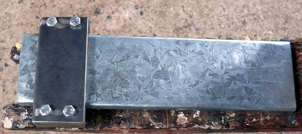

been working on the guard for the planer ..............
still needs a clamp screw on the top and the stem welded on the bottom plus a bit of paint.............
balanced it on the stem to see the effect ..............should look a bit like this when finished

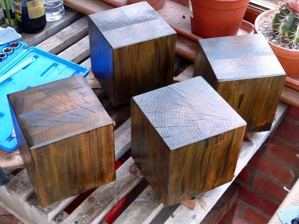

thanks guys, Its always appreciated after a long hard restoration, I had intended to remove the wheels while in use to keep it static but considered the use of blocks to save time removing the wheels
these might work

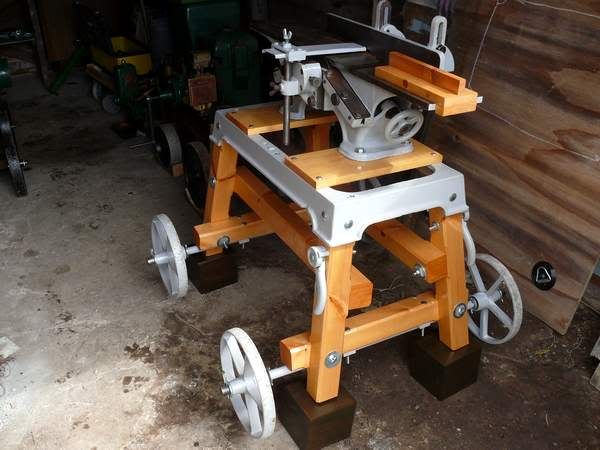

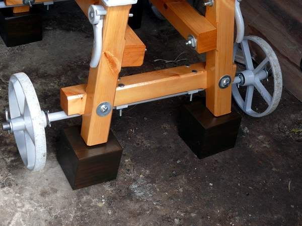

Post by hob on Fri Jul 13 2012, 20:18
well i put it on the blocks to see if they were high enough.................. looks ok to me Very Happy

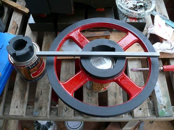

The idea of running it from the National engine looks to be a non starter at least for now as there is no drive shaft, the pulley bolts directly to the flywheel so cannot be changed for a bigger one.
Maybe at a later date when i have it running correctly i can run it from the flywheel?
In the meantime the plan is to run it from the Petter A1 at least to test it, with that in mind i have just had delivered a new pulley, some key steel and a new drive belt. I have painted the spokes red as a reminder that it is a dangerous rotating part.
I used the speed of the old electric motor (1440 rpm) and the motor pulley (6 1\4") to calculate the driven speed was 3000rpm.
The new pulley is 11.22" and the Petter tests at around 800 rpm with my smiths test meter no the resulting speed should also be around 3000 rpm.
The new guard i made has been painted and fitted.
so hopefully everything is ready for a test run once the 6" pulley is removed and the new one fitted.
