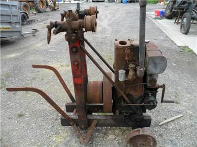

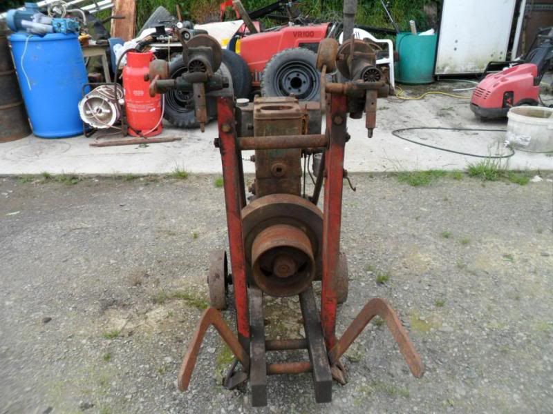

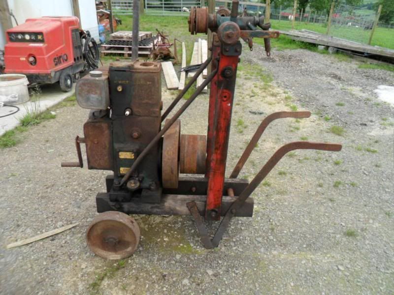

Hi, Collected my first resto project from a farm in carmarthan south wales, the gentleman i had it from said it came as part of an exchange of goods he had done with someone...some pics
have some work to do lol
well..i got the engine home ok, off loaded it into garage, had a quick fiddle, when i turned engine over i had no compression but a lovely sloshy sloshy sound from exhaust, removed spark plug and half a pint of water..... Shocked
popped off rocker cover and exhaust valve was stuck open and push rod flapping about, a minor fiddle and valve closed, reset rod and tappet and turned her over....compression there now but not great.....looks like a defo head rebuild.
took a nose in oil filler and all looks good...no water sign oil level normal.
need new HT lead from magneto to plug, points cover rusted as is cover arm, removed dented fuel tank and popped magneto cover off......wow looks old, measuring from pip that feeds HT lead to condensor end i'm getting about 9kohms? is that norm?
minor signs of damp nothing major and points look ok.

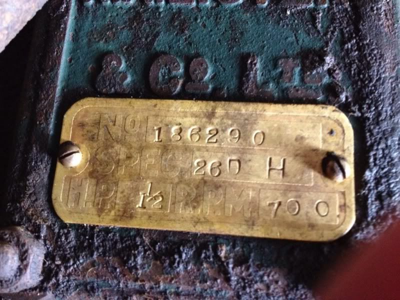

contacted that nice Mr Edgington and emailed my engine details....
turns out my Lister D was built 24-12-1943 and was sold to w j cooper of Buckingham on 06-01-1944......coopers went out of business about 20 years ago so i'm told so far, hope to find out more....
this is my first baby, only a common old Lister D but i love it...

Very nice mate and its a misconception mate Lister D's aint common everyone of thems diffrent in some way lol, all the bits your after are easily found either via the forums or via ebay, would not worry about the brass tank straps just make your own easy job

looks nice and original and all the attachments as well
on a proper Lister trolley as well..

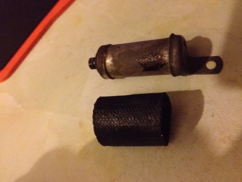

first bits arrived....just a condensor new HT lead and end,
just wanted to see if magneto is ok.
took the plug out and cranked her over for about 5 mins to work some oil about.....seemed to turn over easier after a while, replaced HT lead .....noticed some corrosion and pitting on the HT lead screw tip, maybe something to watch for if your getting ignition probs?, cleaned and refitted,

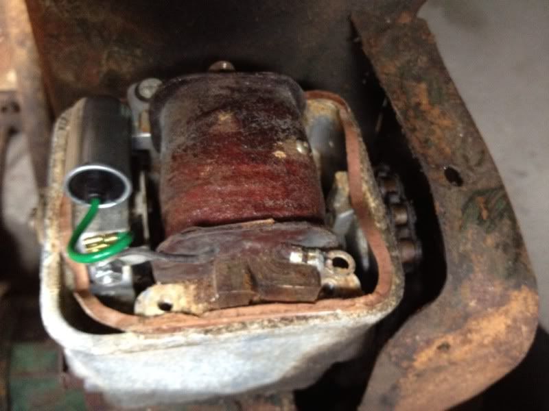

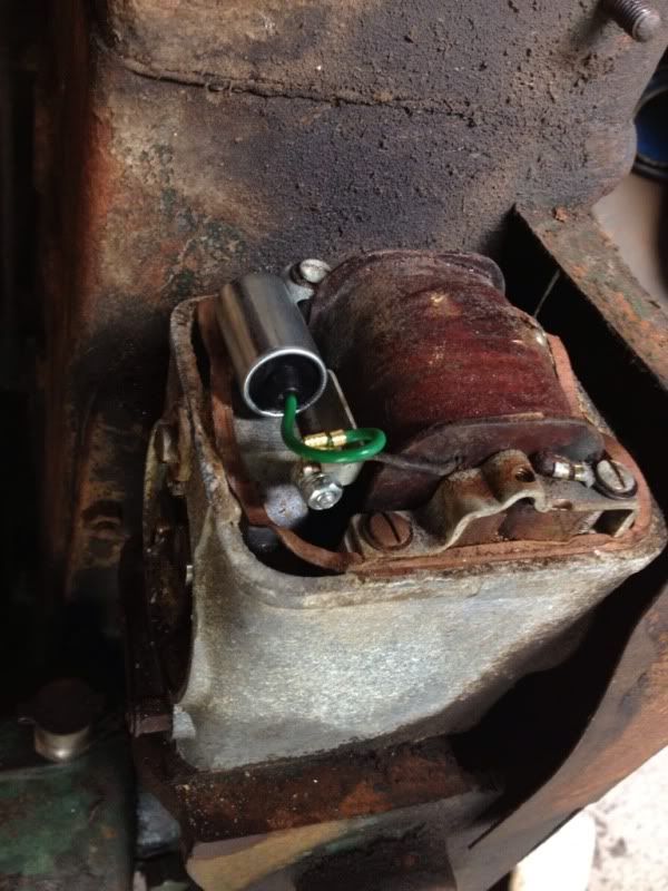

removed old condensor....looks old...
and fitted new one.....
refitted Magneto cover and turned her over, held HT lead near engine body and did see a spark....looks a little weak but yet to clean and check points area, don't see points for sale anywhere? and magneto coil seems to read 9Kohms is this normal.
refitted spark plug and cranked her again....compression seems better, need to check and clean points and carb and she just might start,

Paul the problem you sometimes get is there's a spark coming from the mag and you think all is well but once connected to the plug the spark it's not strong enough in the cylinder to ignite the fuel. So fingers crossed all is ok for you, I normally clean and gap the points first as that tends to be a lot of the problems then see if I can get it to run, sorting carb etc as needed if it will run then strip down to overhaul/paint.

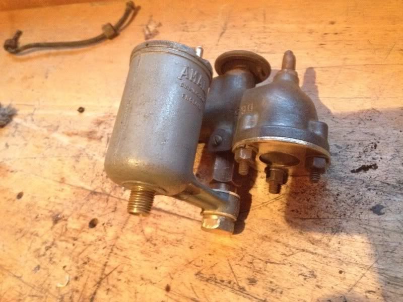

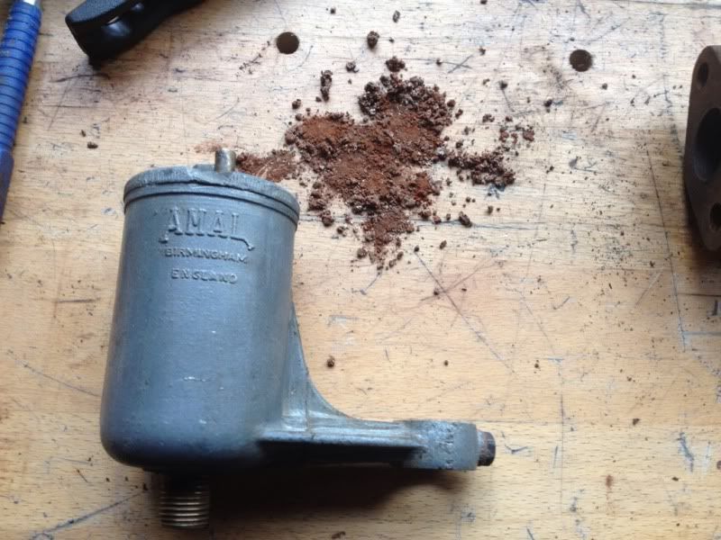

Post by Biggsy on Wed Jun 27 2012, 23:16

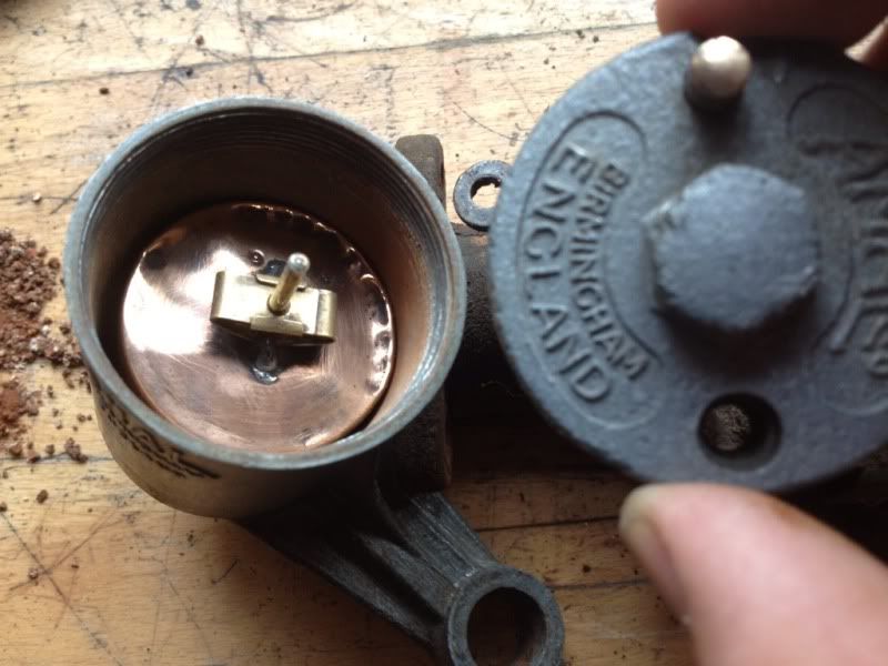

stripping and cleaning carb......boy is it full of crap, i need to replace the fibre washers, are they availible? and the mixture wheel is very loose....and engine vibration would move it....any help plz
ta

Post by JONESEY on Thu Jun 28 2012, 06:09
Paul, fibre washers you can get from most DIY shops as for your carb needle mixer if you take it out.
Under neith there is a little round plunger that should have a spring under it that pushes on the under side of the wheel. I bet the sping is rusted and the plunger is stuck in.

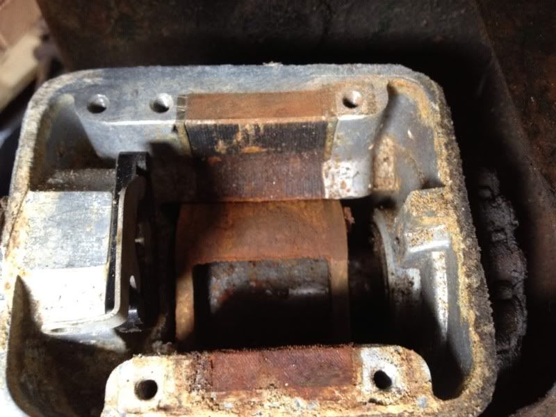

Hi, with the mag as you have a faint spark id take the coil out and clean all around in the mag i exppect the rotor in there is rusty, you need an air line to blow it all out with if not removing the mag, clean underside of coil where it screws down to mag as well, then check spark against mag body and see how good it is, they have to have a clean surface under the mag to earth for it to work correctly with a good spark through the engine, a few things to try,

Post by Biggsy on Sat Jun 30 2012, 07:45
ok, found that thingy under the mixture wheel and it was stuck down, wd40 and a fiddle and its now doing its job thanks for the pointer...
plan is to see if i can get her to run, then strip and scrub, paint etc....
carb was first..mucky
cleaned up float chamber..
and cleaned carb...
next is to clean up magneto and hopefully get a reasonable spark, fuel line from tank to float chamber has an end missing so gonna have to get a replacement, anyone know points gap? was gonna guess about 0.6mm, are replacement points availible?

Post by Biggsy on Sun Jul 01 2012, 12:53

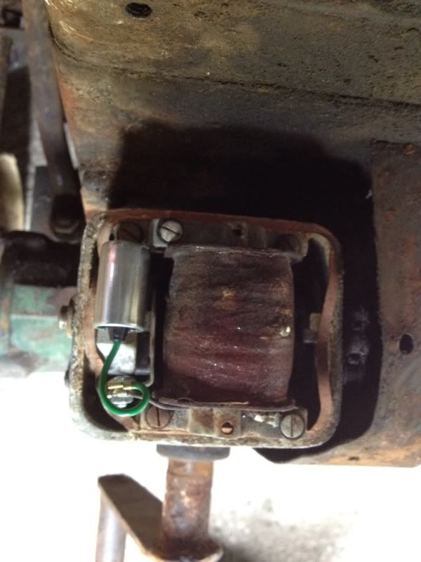

update... refitted carb, and cleaned magneto.
removed lid, condensor, coil brackets and coil, lot of muck under coil,
cleaned it up, a lot of muck between coil core and magneto body, once clean, put it all back together, striped points are and removed bugs , sheep hair and grime, reassemble and set points.
so, filled float chamber with fuel, set mixture and held down air plunger.....with a bit of fiddling.....she ran....woot, had to restrict the air...if i dont hold plunger she stops...but let a bit of air in and she ran.....
really chuffed Very Happy

Well done, bet that made you smile when she fired up. A lot of engines sold as non runners just need a good clean to get working again. As for a sockect set you'll only need a about 4 sockets so don't go buying expensive sets. Try and pick up just the sockets you need and 2 each of the popular spanners and that should do you ok.
