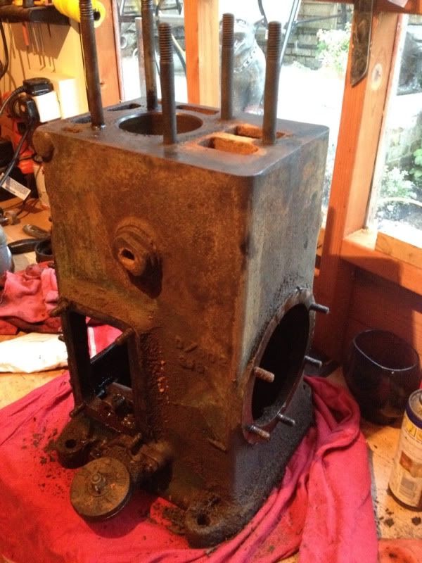

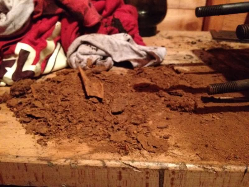

engine stripped...flywheel still stuck on crank lol, emptied hopper of muck and even found some bone in there Shocked
next stop......blasters

It's surprising how much crap you get out of these old engines and also some interesting finds, you have to remember when they needed water out in the field it came out of the pond or stream and carried in what ever they could find.

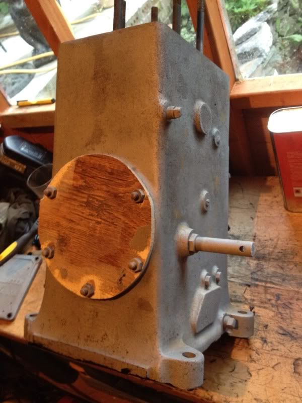

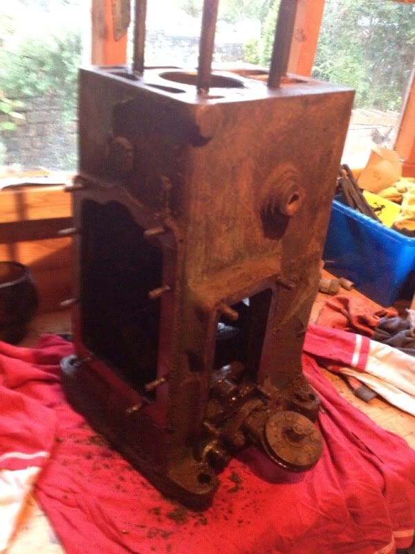

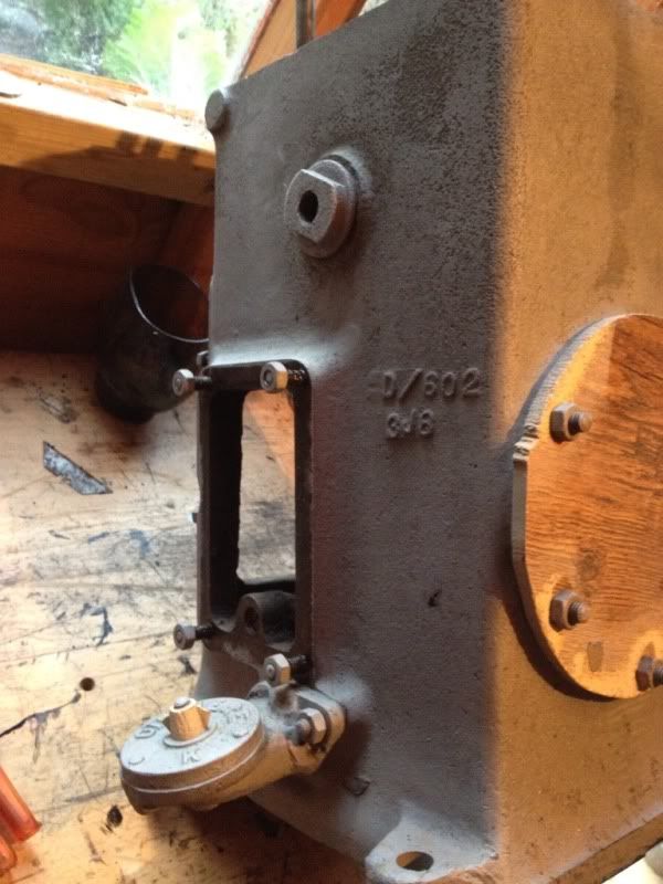

picked up engine block, wheels and trolley handles from blasters...
some painting to do now, need to flush the inside then hopefully start to rebuild. Very Happy

Post by stationary stu on Fri Aug 24 2012, 10:47
Nice clean block now, they've made a good job of the block so not long before you add some paint Very Happy it's good when that happens gives you new life into getting it finished well it does to me Laughing Laughing Laughing .

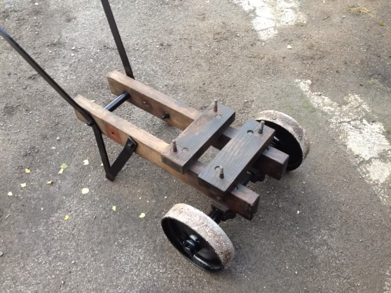

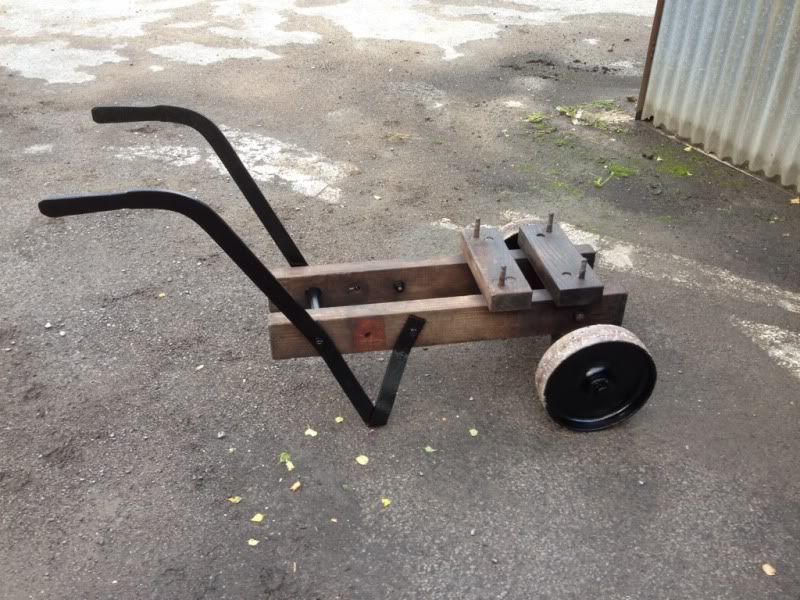

ok...trolley is restored, needed it so i can rebuild engine, i'm happy with finish, the timber was well oil soaked so just cleaned them , grain in timber looks nice and it keeps some character, want to do something with handles? maybe some leather any ideas?, the uprights for the shearing gear will be added soon,
cheers

Post by stationary stu on Thu Aug 30 2012, 10:24
Paul you might want to add some strength to the top of the handles. On the pic below all that's used it threaded bar inside some tube and it helps keep the handles ridged and not twist when moving the engine about on a field.
Re: My lister D Sheep Shear Rig First Resto....
Post by Biggsy on Thu Aug 30 2012, 19:07
thanks for the tip......where do you think i'm gonna push this thing when its finished Smile

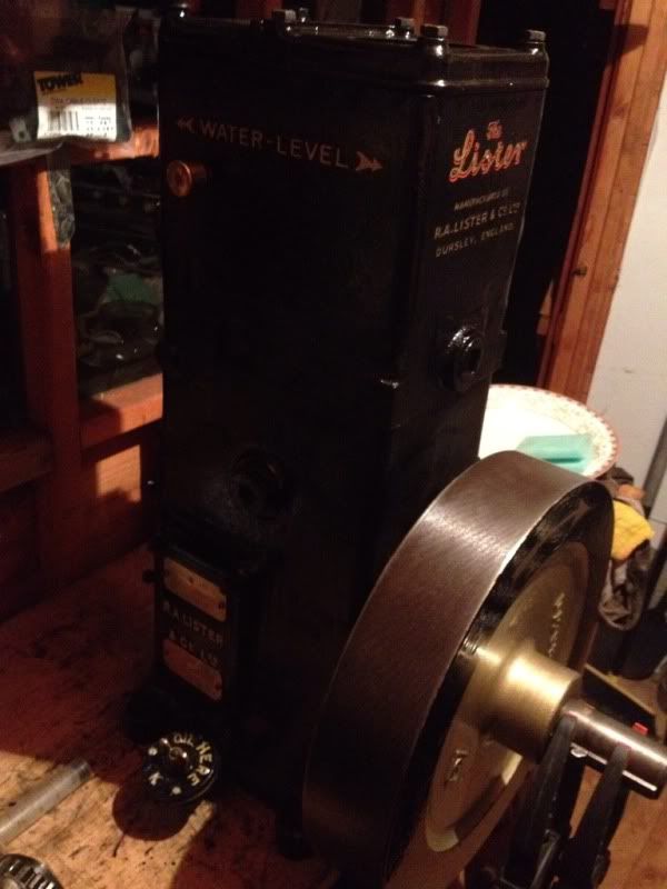

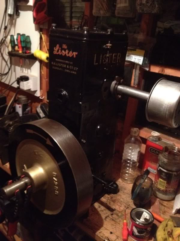

well i decided everyone has a green lister so i thought black would be cool with the shiney brass bits and i like the results so far...
need to give transfers a coat of clear laquer to protect them a bit, then its time to put things back together again, pics here show block with flywheel fitted but no timing gear or piston and head plonked on for weight while i cleaned up flywheel,

Post by nutgone on Tue Sep 04 2012, 21:57
WOW! A black Lister D!
I really like it, I think it looks smart, especially as you've gone to the trouble of having it blasted, therefore doing a thorough job on the prep. Black's a tricky colour to pull off, especially with a high gloss finish, it requires good preparation.
I've seen a pink & purple one before (although, thinking about it, I'm not so sure if that's a D or something similar scratch ) but black looks good, I reckon. (we really need a "Thumbs-Up" smiley, that's what I would put right here Wink )

Post by stationary stu on Wed Sep 05 2012, 10:41
I have to agree it looks spot on, I've seen D's in a few colours but I must say it does look very good painted black and you've got a real good finish to it. This months header pic (top of page) looks good with the black and grey, the D should look well as you can get a few brass parts (tank straps etc) so it should look the dogs bo77ox when all put back together and everything polished up. You will get a few that says it doesn't look right or it shouldn't be that colour well just ignore them, it's your engine to paint what ever you want.
Looking forward to seeing it all finished,
