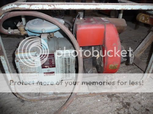

Post by stationary stu on Tue Jun 26 2012, 11:04
I've a Villiers propane engine sat in the garage, can't remember what it looks like to tell you what it needs so here's some pics don't know if you can see much.
Re: HELP NEEDED VILLIERS ENGINE
Post by kevjhnsn on Tue Jun 26 2012, 12:28
as you can now see thanks to stu
the gas goes in carb vertically via the blue diafram
were as petrol goes in horizontal same side of the carb just below the gas fitting.
this is the at a glance differences,
there are more internal differences but thats when you take it apart
but for now
any questions just ask on post or pm me
