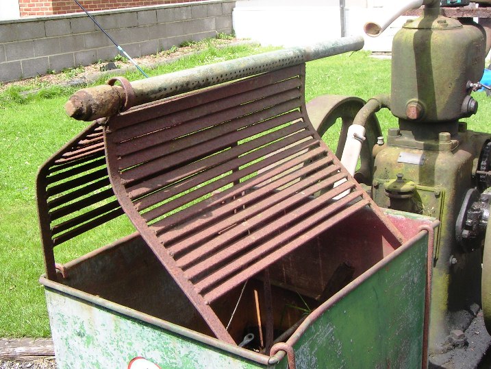

Well as promised here's the pics, have hit first snag as said now stripped down the only thing is how to get the piston out, its nearly at the bottom on the stroke and there's no access from the top any and all help much appricitaed scratch

Quick update on progress so far the engine is now fully stripped down with the exception of the piston and the valves which are well and truly seized in the head both of which are submerged in a big bucket of diesel at this very moment, the main block has been stripped and cleaned and at the weekend had its first couple of coats of paint, all bearing housings, governor, cam shaft and carb have been stripped and cleaned, cam has been refitted , have found that the bearing on the pulley side might need replacing due to wear in the middle of the bearing but intend to mic them up and see how much wear its got will put pics up later this evening
Re: Lister L Hedge Find
Post by Abes on Tue Jul 03 2012, 17:44
Here's the pics as promised
