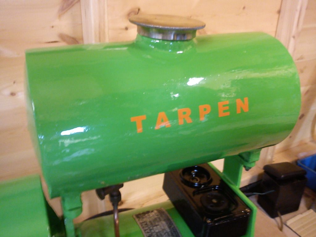

Post by stationary stu on Sun Jul 15 2012, 11:25
There not the best of pics to see the difference but you can tell one looks better then the other so you work wasn't wasted. One way I've managed to get rid of runs in paint is to let it dry then cut it off using a razor blade, (very carefully) makes it look a lot better even though you'll still know where there at anyone a few feet away shouldn't be able to see them.
Re: Nutgone's Tarpen
Post by nutgone on Sun Jul 15 2012, 11:38
No, you're right, the close up shot doesn't look very good, it looks better from a distance.
Trouble is, the plaque is quite badly worn anyway, I'm gona still play with it a bit, as some of the letters haven't come through very well. It's going to be an ongoing thing, I think.

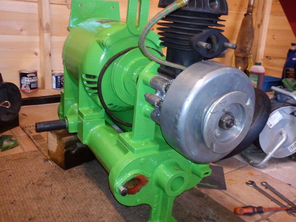

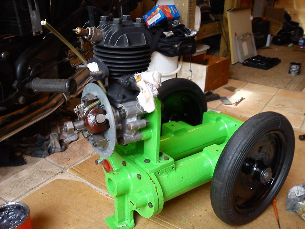

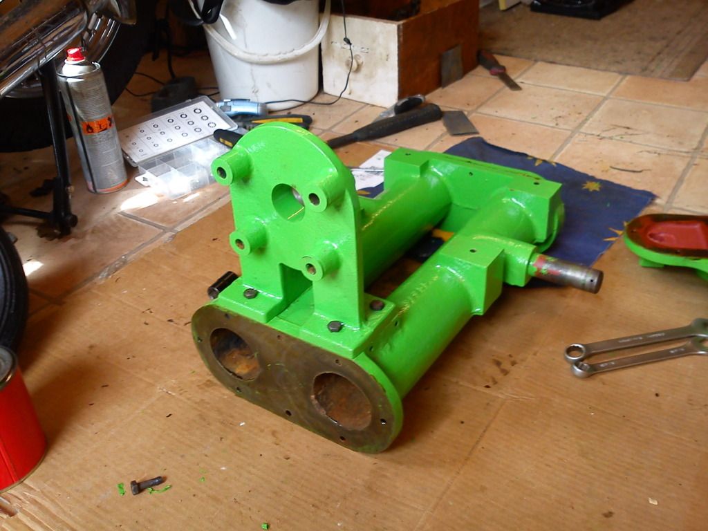

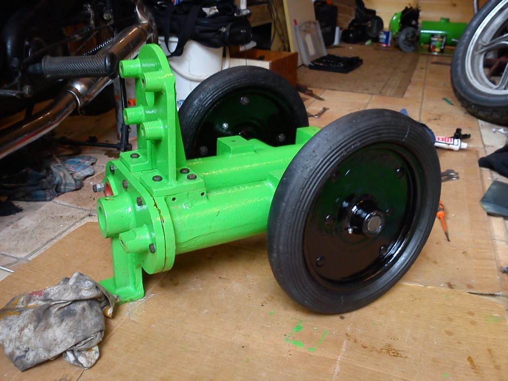

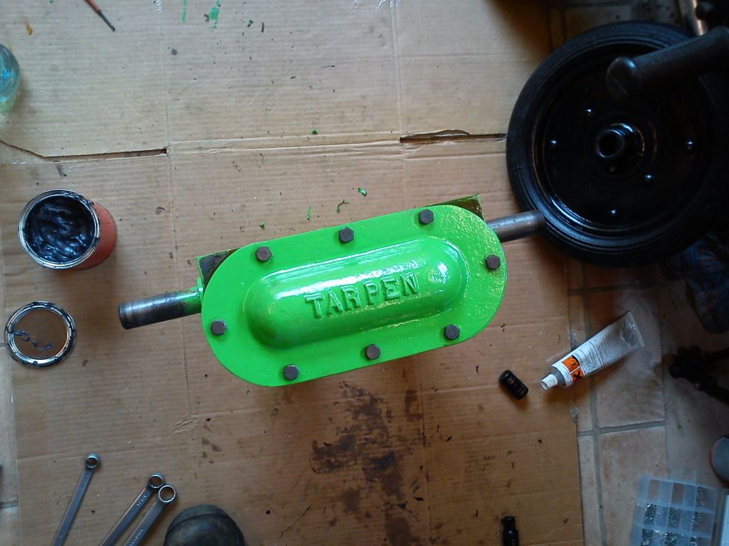

Right. Today I thought I'd take it easy, just do a little bit. So I began by putting the wheels back together, then I got carried away again Rolling Eyes
The wheels have roller bearings, like big needle rollers, a bit OTT but nicely engineered. They're pressed steel split rims with solid tyres. I couldn't find any satisfactory new tyres & the tyre & bumper restorer bought the old ones up a treat anyway. Also the side walls were quite badly bashed about, but only on the outside faces, so I turned them round for re-assembly & they look really good......
Once together I touched them up with some more black Hammerite Smooth & put them to one side.
Then I thought I'd start putting the end caps on the chassis. I've decided to use some instant gasket type stuff on them, as they form much of the exhaust system. I used something called "Wellseal", it's reckoned to be one of the best & is quite expensive (it was my dad's, with his permission)......
The Wellseal takes 5 minutes to dry, before you can assemble, so the first end plate I just had a fag & greased up the threads of the bolts, but the next one was too soon for another fag, so I put the engine mounting bit on instead......
Then I realised I'd done this in the wrong order. I should've put the front plate on first, then done the rear (Tarpen embossed one) on once the wheels were on, but it's not a massive deal, so on goes the front plate & wheels (the wheels will be on & off a few times, I guess, so I won't open out the split pins until I'm sure I'm ready.......
So then I'm thinking "how many bits can I get on this thing without denying myself access for painting up the nuts & bolts?" The answer was "engine & governor mounting shelf" so on goes the engine......
Oh yeah, while I'm at it, I might as well put the flywheel back on, & the coupling flange on the other end (Of course I re-checked the points gap, just to be certain)......
Now it was time to paint up all the nuts & bolts & various scuffs, & put it to a safe corner of the workshop.

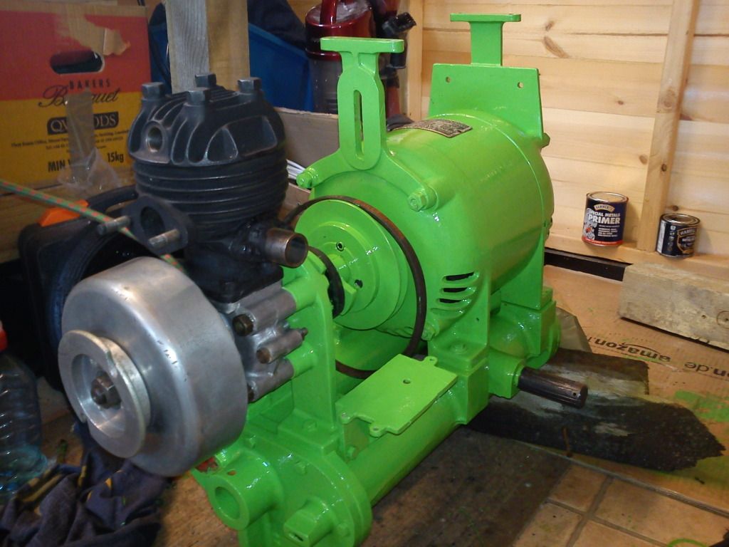

Might as well make a start on building up the generator whilst I'm here, I suppose.......

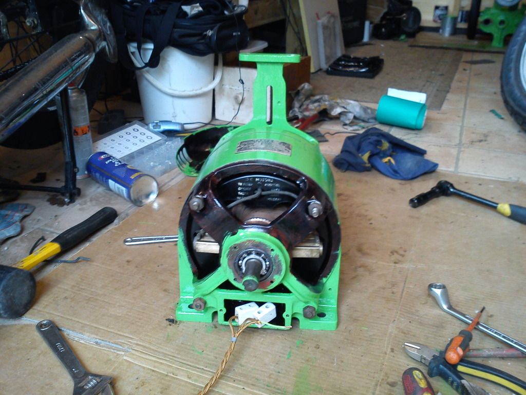

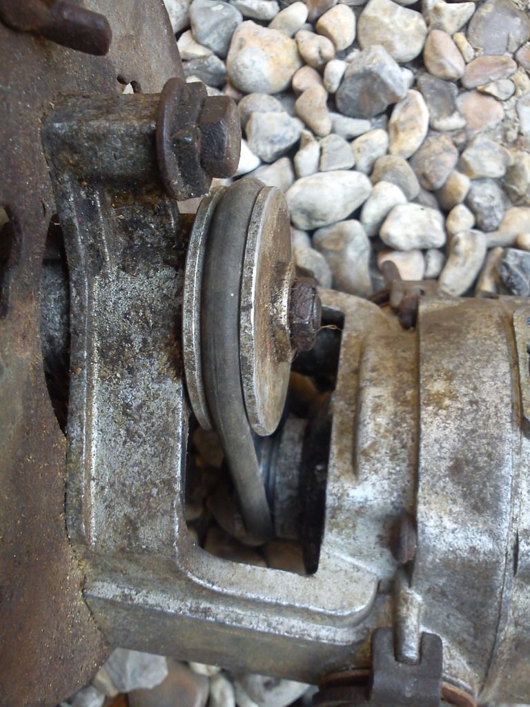

Now this isn't as easy a job as I thought. It turns out, all that bashing to get the pulley off has pushed the bearing along the shaft & now the brushes aren't correctly lined up. So I've just got them as best I can, just hope it's OK.
Then it turns out all that bashing has splayed the end of the shaft out a little where my new pulley & the other coupling flange have to go on. I filed it down for ages but still managed to split my new taper-lock bush in half tapping it onto the (very tight) shaft! BUGGER! I thought that was it, but it still goes into the pulley & locks onto the shaft, so it'll just have to do. It's not like it's under much strain.
I also split the coupling flange (BUGGER!!!) tapping it onto the shaft (DAMN that shaft's tight!) It's only got one split in it, along the line of the key-way. It's still on there tight & it's not like it can fly off anywhere, it's attached by the rubber coupling. So I've left it be. If it does break up I'll have to find another or get it welded.

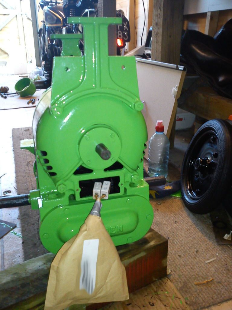

So, off come the wheels & on goes the generator. I did up all the coupling bolts, only to realise I'd left the fan belt off! (BUGGER!!!!!). Off it all comes again, just to slip the fan belt over......
She's really beginning to take shape now. I had to connect a length of that special flex, as I didn't know if I could get to the connections on the back of the genny, after shortening them during the tidy-up of the old wiring. I put it in an old Jiffy Bag, so it doesn't get dirty (I'm turning into a bit of a girl with this one, aren't I?).......
I painted up the next lot of nuts & bolts & put the wheels back on.

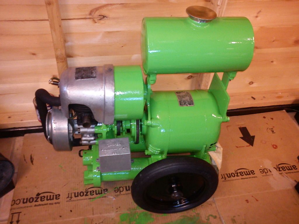

I stood there looking at it for a while, than I thought I might as well get the fan & cowl back on. I'd already had it on once, to get the pulleys lined up, & I'd already greased up the bearing.
So on went the fan, then it's shroud, then I thought I'd put the exhaust pipe on & the engine cowl. I rested the governor box on it's shelf, dropped the petrol tank into it's holes (haven't bolted it down yet, as it's gotta come off again) & took some more pictures.....
I'm a bit annoyed with myself at splitting the bush & coupling flange, but all in all I think she's looking great!
Next I've got to polish the petrol tap, rebuild the plug socket, put the governor back together (it doesn't actually work, but is needed to hold the throttle linkage), put the carb back on, petrol pipe on, connect up the electrics, handle back on, spark plug shorting strip back on (my version of a stop switch), plus a little plate with 2 holes (with new grommets in) on the back of the genny, than I suppose I'd better try to start it.
I haven't checked for a spark yet, as there was still wet paint & I didn't want to have to touch it up AGAIN! I suppose I'd better check that tomorrow. I haven't polished up the carb either. I have cleaned it up VERY thoroughly with almost a full tin of carb cleaner (albeit some weeks ago), & I'm fed up with polishing stuff, so as long as it works it'll do me for now.
Also I've got the petrol tank to sort out. I went to give it a 2nd coat the other day & completely messed it up. I think I will have to sand it down & do it again (3rd coat) before I'm happy enough to put the new "TARPEN" badges on. I'm going to have to be patient though, as that'll mean waiting for the paint to fully harden, which takes a good week, possibly more.
Right, I've rambled on long enough for now. Will let you know how I get on tomorrow.

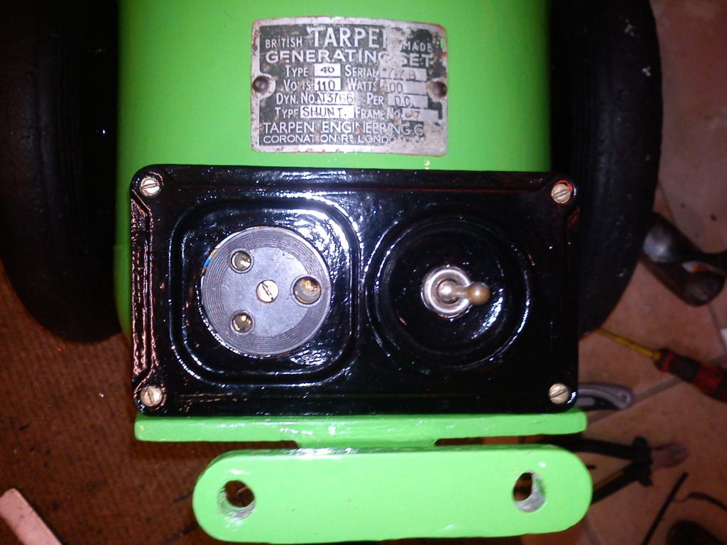

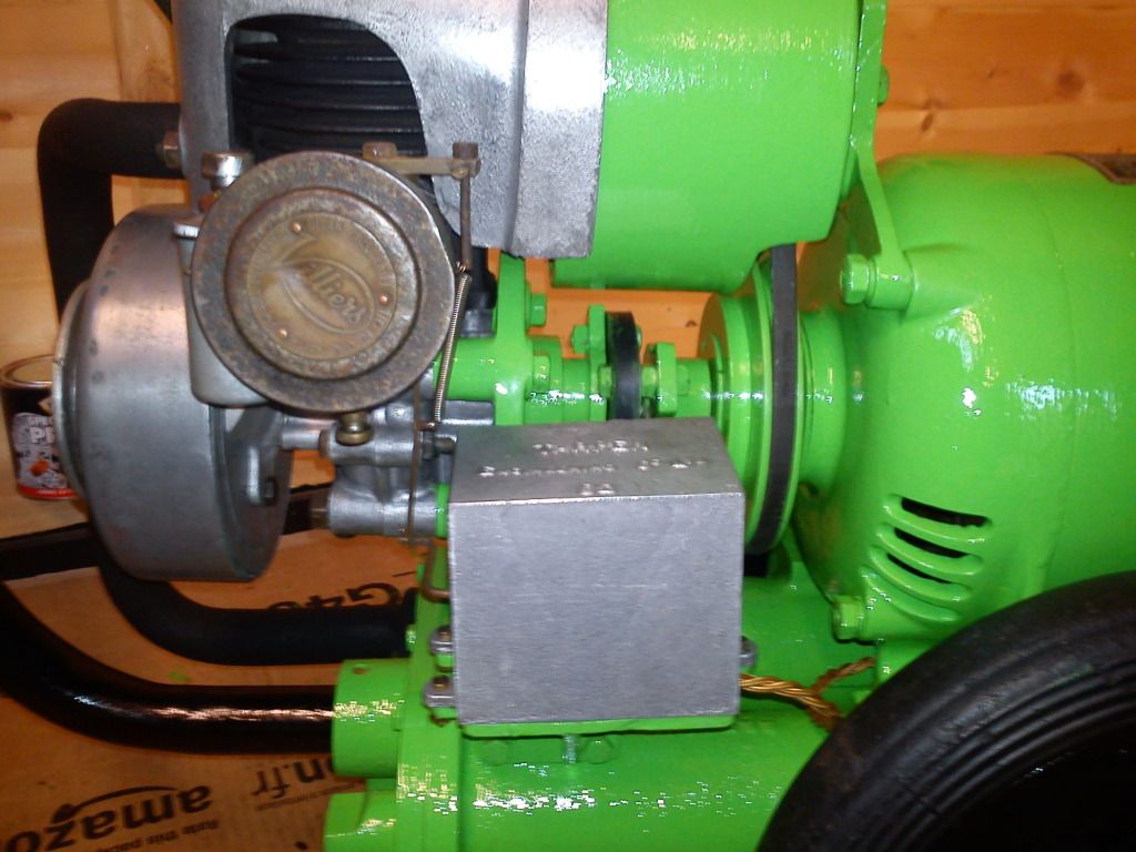

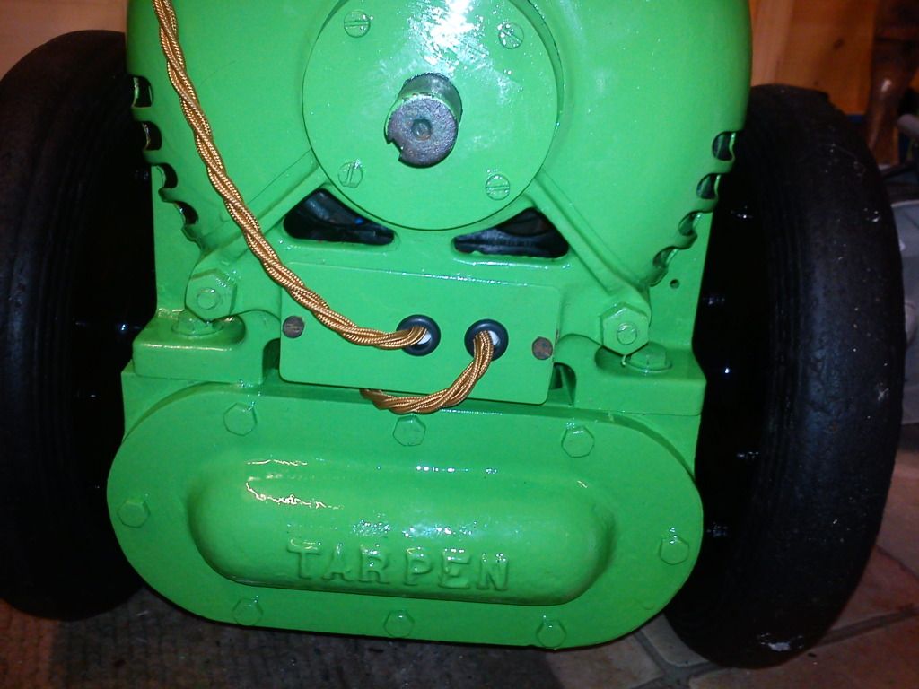

I put the plug socket & switch back together, wired in some of that lovely "antique" (effect) flex, hack-sawed & filed down some M6 bolts & fixed it on....
Then I wired a length of flex to the governor, put the guts back in it, put the carb on & connected it all back up (the governor doesn't work, but you need the guts in it to hold the throttle linkage in place)....
Then I carefully put it all back into the generator outlet point, feeding the flex through the new grommets (I'll touch up the screws later, during the final paint touch-up session). I think the "Antique Gold" flex looks quite good against the green....

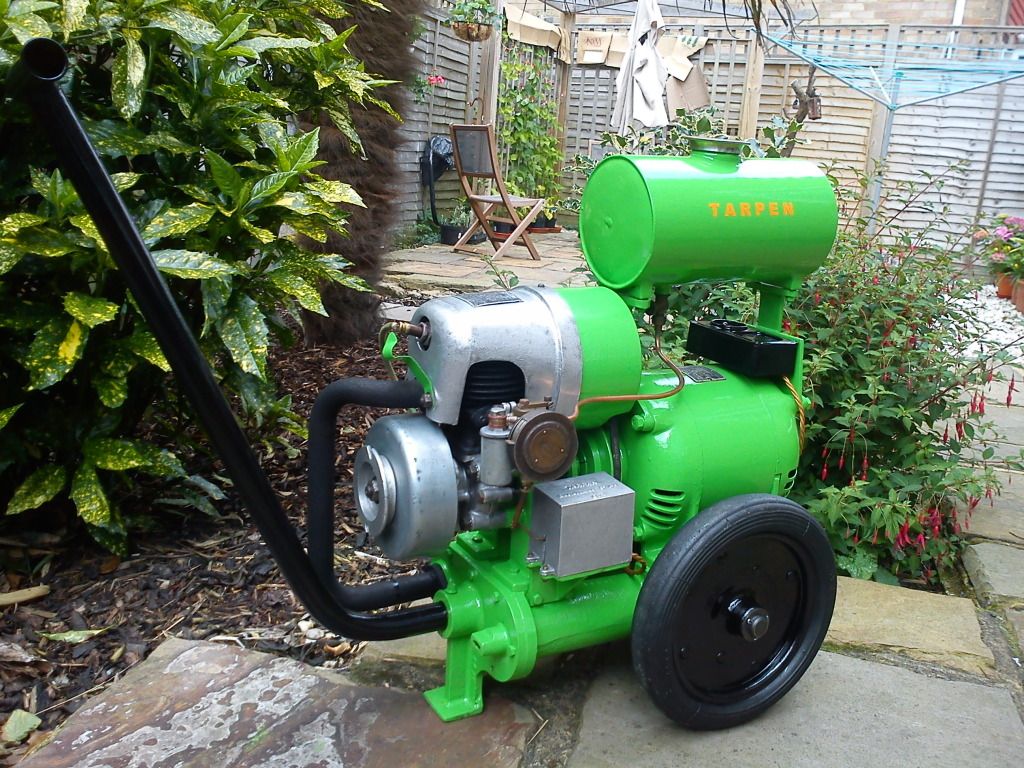

So, from this....
To this....
In 13 days.
Quite an intensive job, I wouldn't want to be under pressure like this on another one, so I need to sort some storage out & just bring bits home to tinker with.

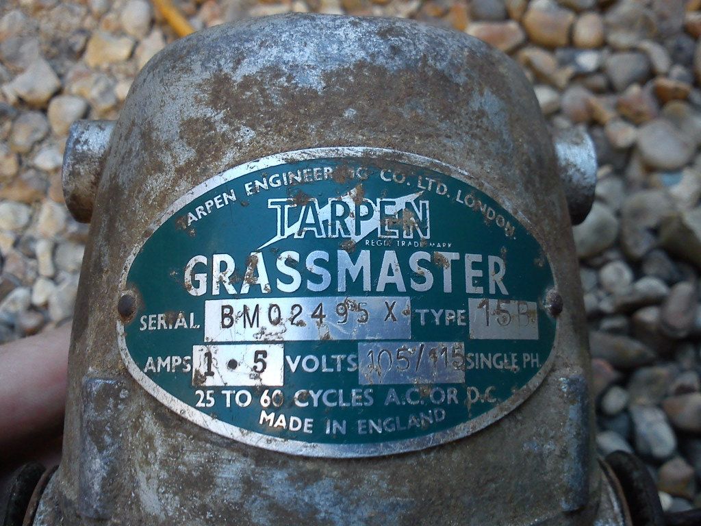

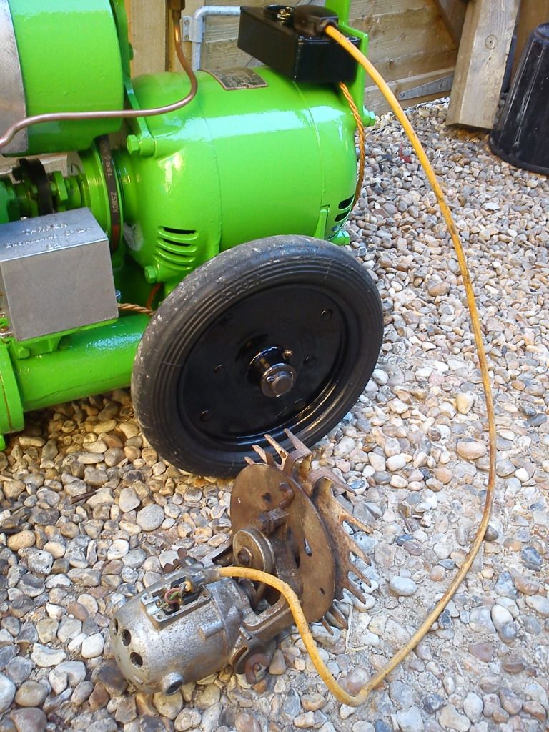

I thought, seeing as it had the right plug on it, I would play dangerous; start up the Tarpen & plug it in, see if it works.....
It didn't! Crying or Very sad
A quick test with a multimeter reveals high resistance through the switch, so I decided to dismantle it. I got the head off the handle, an interesting device, it runs off a round section rubber belt....
This one doesn't have wheels on it. I've only ever seen them with wheels, but I'm told they were built without.....
All these pics & more will be on the same album as the Tarpen pics, on this Photobucket album:-
http://photobucket.com/nutgonesengines
So, I got the head off, & I couldn't resist it. I got the plug off the flex from the handle & put it onto the end of the flex which was previously inside the handle. I thought I'd get the engine running again & try it out without the switch (well, there's a switch on the plug socket Very Happy ).....
& success! It works! How pleased am I? bounce
So Nutgone's a happy bunny with his new Tarpen Grassmaster. I'm going to get some new rubber flex for it, paint her up & get it back together. Does anyone know where I can get a new rubber belt from???
It looks like an over sized hoover belt, the belt looks ok in the picture is it cracked or perished? Maybe try a belt supplier the people that normally sell v-belts etc apart from them I can't think of anyone else ATM.
Great news that it does work and won't take to much work to get it fully operational again.
