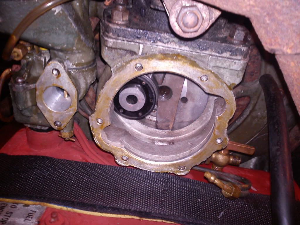

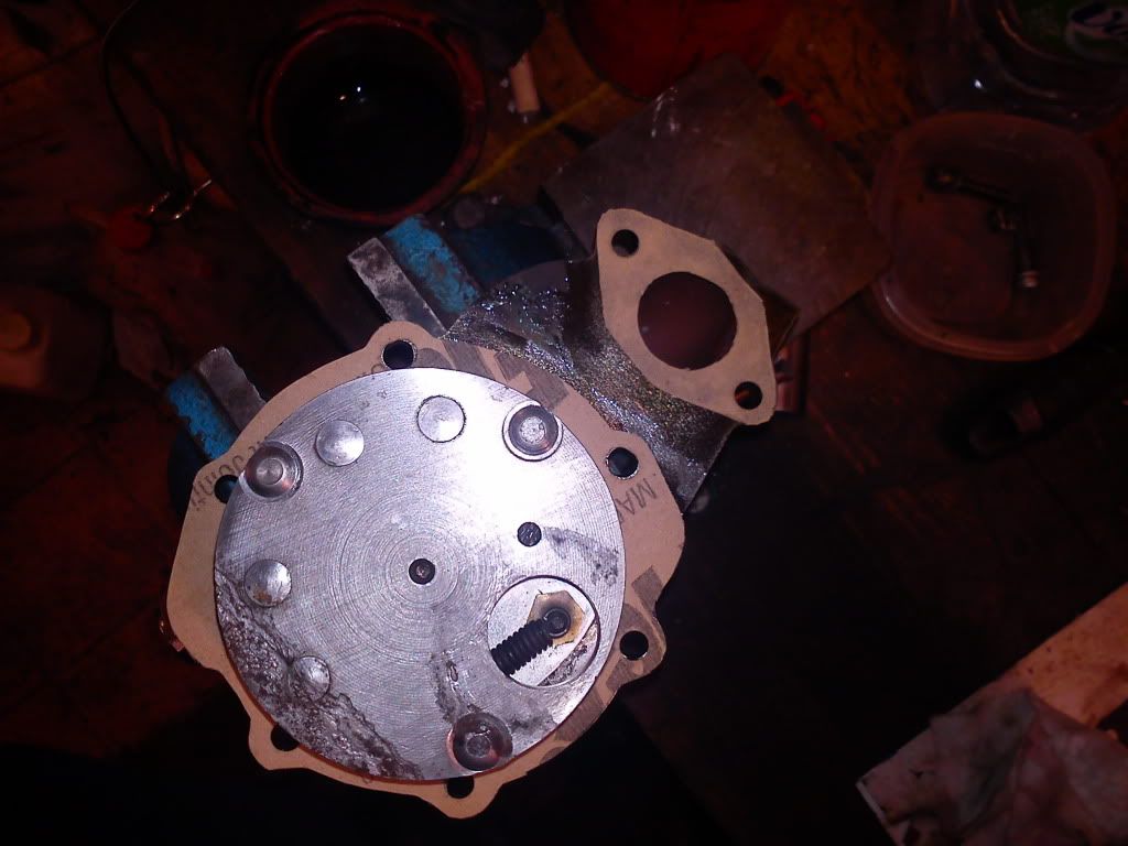

Here's some pics I took while working yesterday. I took the front end off & made up some new gaskets (I'm glad to see my gasket cutting has improved quite a lot since I cut the old carb gasket for this engine)....
Anyway, today I decided to have another go with it. I managed to get it started again, without too much trouble.
Now, some time ago I had to replace a section of the primer pump tube, as the original brass one had broken. So I found some very small clear flexible plastic tubing which slides over the original 1/8" brass pipe (you can just make it out in the top left of the above picture). This is how I knew that the engine was sucking raw fuel straight into the intake ports. The trouble is there is a missing spring from the primer pump, this spring holds down the small ball bearing in the pump itself, there is another ball bearing with a small spring in the outlet section as well, but this still has it's tapered spring. The one that's missing is a stronger spring & I guess is there to stop the engine sucking fuel straight through the primer pump.
So, after I started the engine, I made sure it was running reasonably well & I bent the small flexible tube over to block it. This seemed to help the running & the engine continued to run well. I opened the crank case drain tap occasionally & very little fuel came out (it is possible to open it whilst running without stopping the engine).
I then stopped the engine & decided to remove the primer pump tube. I took off the clear plastic tubing & removed the compression nuts from either end of the old brass pipe. I put a small ball bearing in each pipe union & did up the nuts, therefore blocking the pipe unions, like so (these are 1/8" pipe unions)....
I started it again & she ran fine. Also, the adjustable needle jet on the carb now has a direct effect on the running of the engine. If I wind it right in the engine stops, as I wind it out it hunts on the governor, until the mixture gets stronger. Then, if I wind it out too far the engine starts to stall as the mixture is too strong. This all happens in about 2 or so full turns.
Anyway, I'm not counting my chickens just yet. I've now lost the primer pump, so cold starting could be an issue. I may have to rig something up with a small fuel tap in the line, so I can still use it.
Do they make 1/8" petrol taps???

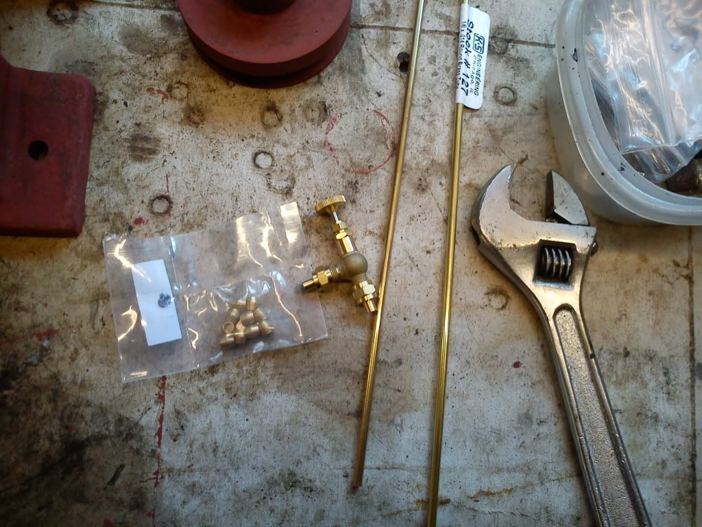

I have ordered one of these....
Some of this....
& some of these....
All together it's cost around £20, which I probably shouldn't be spending, but I want this thing finished & working properly.
All those bits are very small, the pipe is brass (not copper) like the original & is 1/8" OD (which is about 3mm), so it's all miniature stuff.
The valve is supplied with soldered on ferrules (soldered nipples) but may well work with olives instead, I'm not too fussed, I can solder just as well as slide an olive onto the pipe, it's just that the rest of the pipe unions are all olive compression fittings, so I would prefer to keep it all the same.

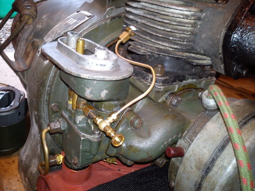

OK, so I've had the valve for this for about a week now, & the pipe olives turned up soon after. The brass pipe however has taken ages to get here, but finally arrived yesterday, so i got on with it....
Got all the bits together (not happy with the pipe, the wall thickness is very thin, but I thought I would give it a go & try not to kink it)....
the valve is tiny....
I managed to get the S bend in the pipe without any major kinks, then cut off the ends to suit. I soldered the ferrules on & used the new olives on the engine connections. I left the main body of the carb in place so I would know my limits, but took the air cleaner & top cowling off to get at it all....

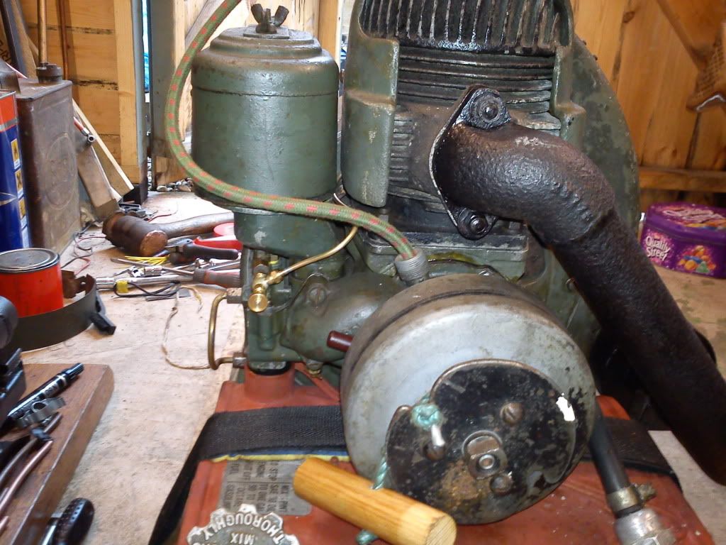

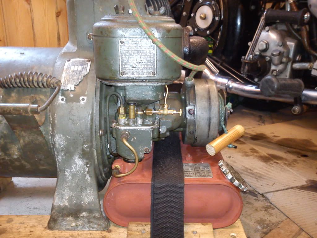

Air cleaner back on & here's how it looks all assembled....
I think it looks quite neat & it doesn't get in the way. It seems to work well & does it's job nicely.
Just need to make up some replica spring mounted skids for it now & it will be complete.
