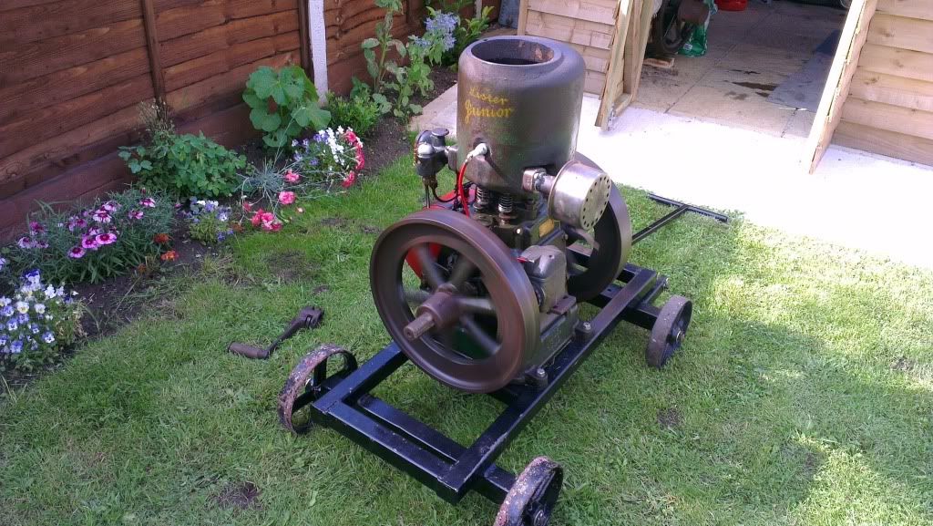

Here is the Lister A
Nice clean transfers isnt it .

matt86 wrote:Billy my Lister A is in working clothes .
cleaning took a while but alot easier than painting . Think its when i paint i take time and a bit of a perfectionist .
i left my lister a in it working cloths after i removed the crap restoration paint and found a nice old coat under neath with decals still
just restored the old trolley as well as it looked rotten but just very cruddy and painted on over ocrud before
heres before
and after
Age : 40
