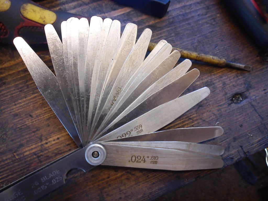

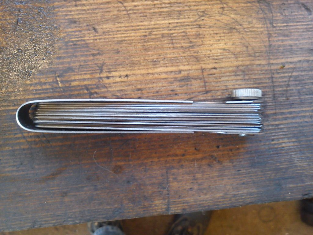

Well, the set I got I am very pleased with. They look a little untidy on the hinge, but not too bad everywhere else. (let's see if I can get a pic to show you what I mean)....

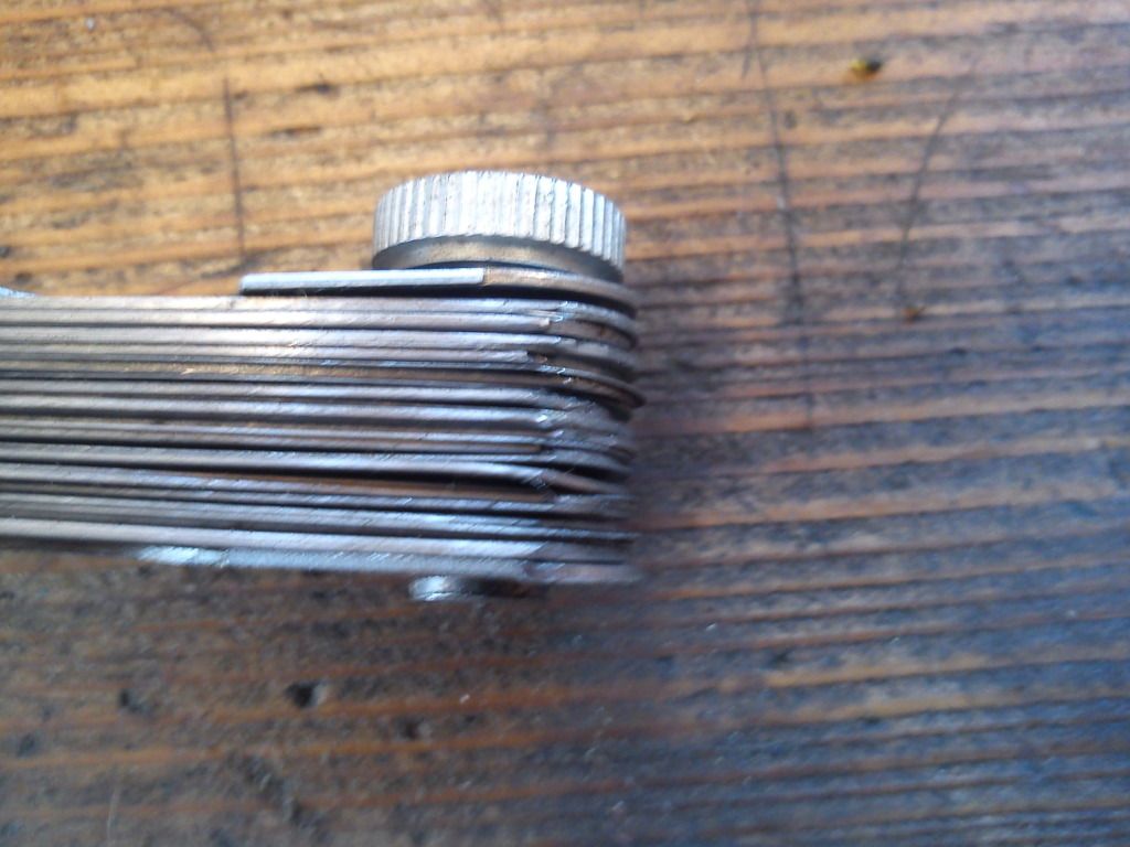

Also, there isn't much spare thread on the thumbscrew bit, but then there never is on feelers.
I'm happy with them, although I would say they look a little rough round the edges. But then I think it's difficult to get a large set of leaves like this looking tidy, as there's so many of them.

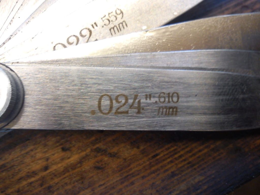

The markings are clear though & they are all easy to find, also there is EVERY single thou from 1.5 right up to 25, so no maths to do. The Metric markings are secondary, so they are an imperial set foremost, with metric markings on each leaf.
Up to you at the end of the day, I'm just letting you know what I think & giving my honest opinion. Wink

Like you say the hinge end doesn't matter, one of the main bug bears with feeler gauges are that the sizes are difficult to read even on a new set but they look clear and easy to read. Look as if they would do the job for me.
