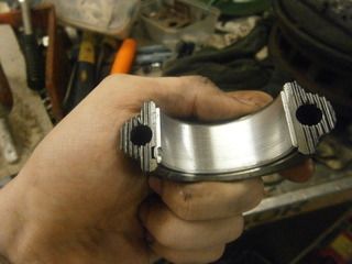

Since I have to wait for the extractors I decided to take the sump off to look at the bottom of the engine, due to the outside appearance of the engine /9rotten cowling and all) i wasn't expecting much but I was very pleased to find that it was all nice and clean inside. I took a look at the big end as well and it looks good.

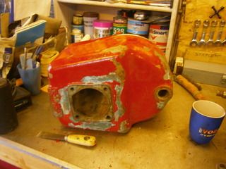

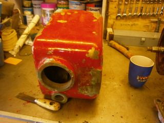

Here's the fire pump that was connected to the engine. at the minute its just a shell (albeit an extremely heavy one) and I need to see if I can find the bits for it. I think its made of bronze. Shown next to the trusty mug for size

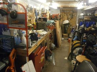

And if anyones interested, heres a photo of the "man cave"

The corrision looks a bit nasty due to the salt in the atmoshere, makes me wonder what the piston would be like after drawing in a salt air mix. I have to say the big end looks spot on doesn't show any signs of wear or is it not showing up in the picture?

The pump must have a large output looking at it's size.

Lovely workshop, bit on the messy side but still lovely. I'm very envious.
I'm looking forward to seeing the rest of this restoration, you might be surprised on the age of the engine, I know I have been before.
Re: Ruggerini RF 120
Post by 110samec on Tue Aug 28 2012, 17:37
It won't be messy for long Smile we've had a new garage built on to the house so a lot of things like the welders, tool chests and the press will go in there. Means I will have more room to put engines in then Very Happy I think its fair to say our stuff gets used
