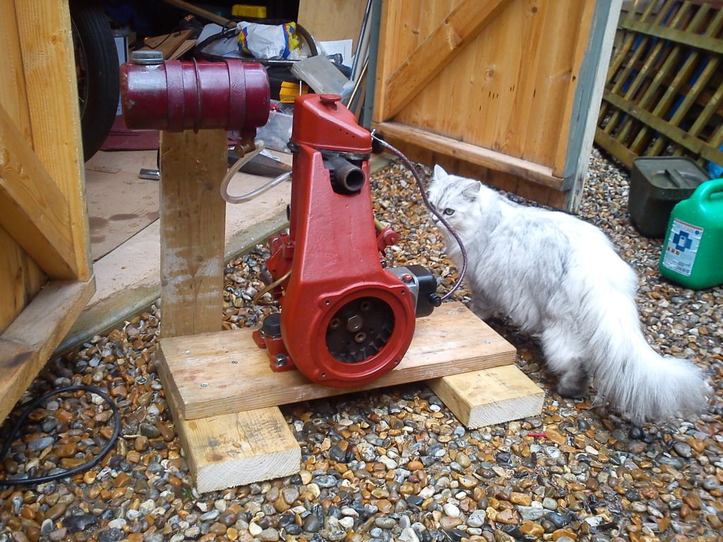

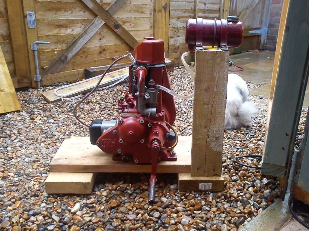

OK, prepare yourselves for perhaps the best piece of carpentry you're ever likely to see! I don't want you all getting jealous of my skills when it comes to mounting stationary engines to platforms, but I'm going to show you all anyway, I will explain a little more after the pics....
OK, so as you might have guessed, I got her running! (you've also probably guessed I'm no carpenter, well that was obvious, but this is only a temporary mounting, made from what I had handy).

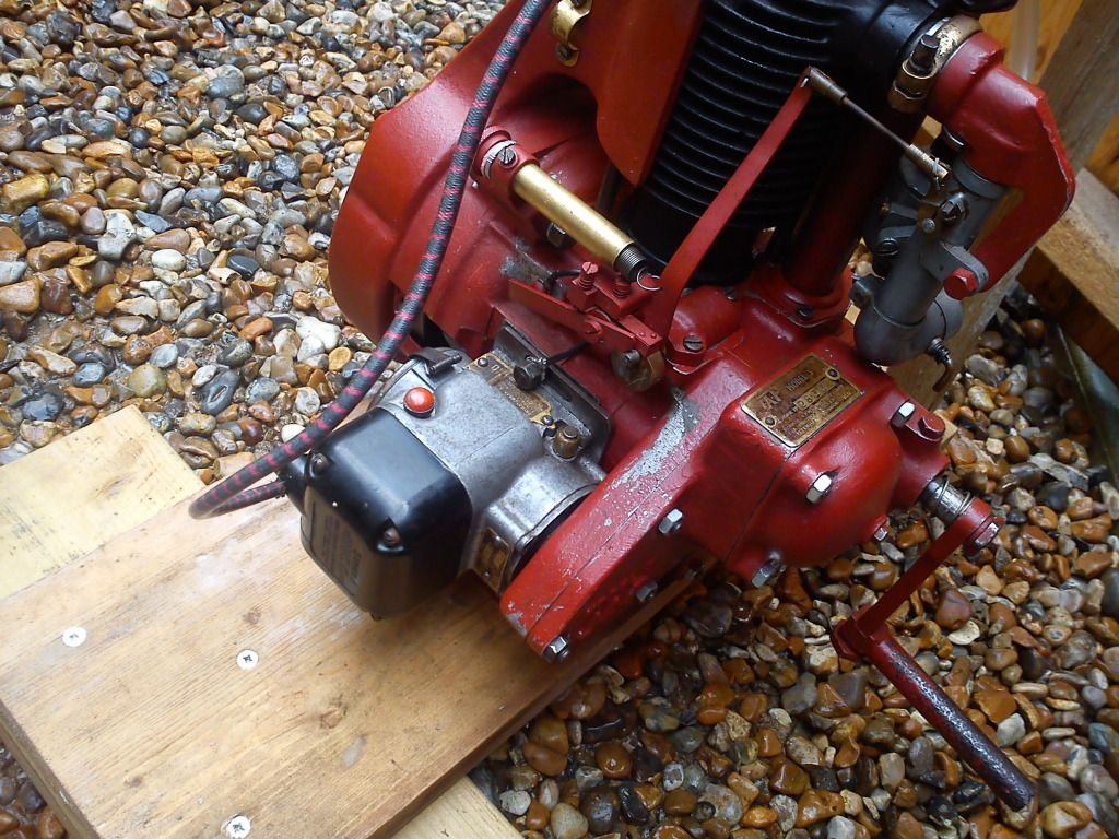

As you can see from the final picture I got the mag sorted. My mum put me in touch with a local guy (literally less than a mile away), he's pretty hot with magnetos & is into stationary engines & old stuff like that, the only trouble is he is profoundly deaf, so communicating is a little different than normal, but fortunately I've had some experience with this in the past, so it wasn't difficult for us to understand each other.
I've still got the original top for the screened mag, but I see no reason to put it on, as I haven't got a screened lead to go with it, so it would only be a lash-up. The black Bakelite cover looks good for now.
The rest of the mag is the original one which came with the engine, I had put it all together & got it all timed so perfectly I wasn't willing to remove it again. I also applied some Loctite "Stud 'n Bearing Fix" to the end of the cam shaft, so it's not going to be easy to remove the timing cover now, as the cam shaft is stuck in there. But I was more than happy with both the ignition timing & the valve timing (both of which are not marked & required some careful measuring & application of my own "Tipp-Ex" timing marks in various places).
I'm also more than pleased that my condenser worked! My original 150nF capacitor was only giving a weak spark, so I ordered some 330nF 400v capacitors from eBay, which seem to work very well, & I've still got 4 left for the next time a condenser decides to pack up.
I'm getting a little backfiring through the carb, but I've yet to sort out an exhaust or air filter, so until these are sorted I can't expect to do any fine tuning, not that there's really anything to fine tune, the carb's not adjustible, nor is the valve timing now, I can adjust the ignition timing a little by moving the points carrier on the mag though, it's currently advanced to the full 23 Deg, which is the set firing point according to the manual, I reckon I can get about 5 Deg in either direction with the slots on the mag. I'm not likely to move it though as it seems to start pretty well & hasn't attempted to break my wrist yet!
I'm off to an autojumble tomorrow, it's mainly bike stuff but there'll be all-sorts there, maybe I'll pick up something for the exhaust & the air filter there.
Right now I'm just happy to have finally got her started, I just need to remember it's only got flushing oil in the sump! (not that I can run it much, with no exhaust!)

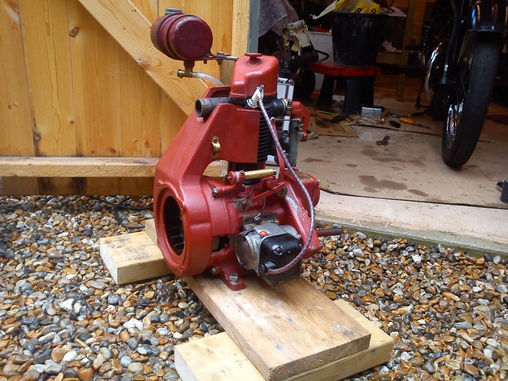

Oh yes, you may notice the fuel tank "borrowed" from my brother's Stuart Turner (well, he shouldn't leave it round here for so long!)
The engine is still in it's red primer, another mistake! It's Hammerite "Special Metals" primer, which is water based & although not bad, it needs a completely clean, oil free base or it won't coat! Which is quite difficult on old engines. An oil based "Etch Primer" or "High-Tack" primer would be a much better proposition, that's the last time I buy anything with the Hammerite name, as I've now been let down by every one of their products I've had the misfortune to buy. It'll be a Rustoleum product next time, or I will try & get my hands on a decent industrial grade etch primer, NOT a water based one!
As you can see in the pics, this "Special Metals" primer has failed to stick to much of the aluminium castings, which should be an easy task for it. Not exactly a sound base for any further top coats.
Still, we live & learn. The "Plasticote" High temperature paint on the head & barrel seems to be doing well, now that is a good paint, one I would recommend to anyone.

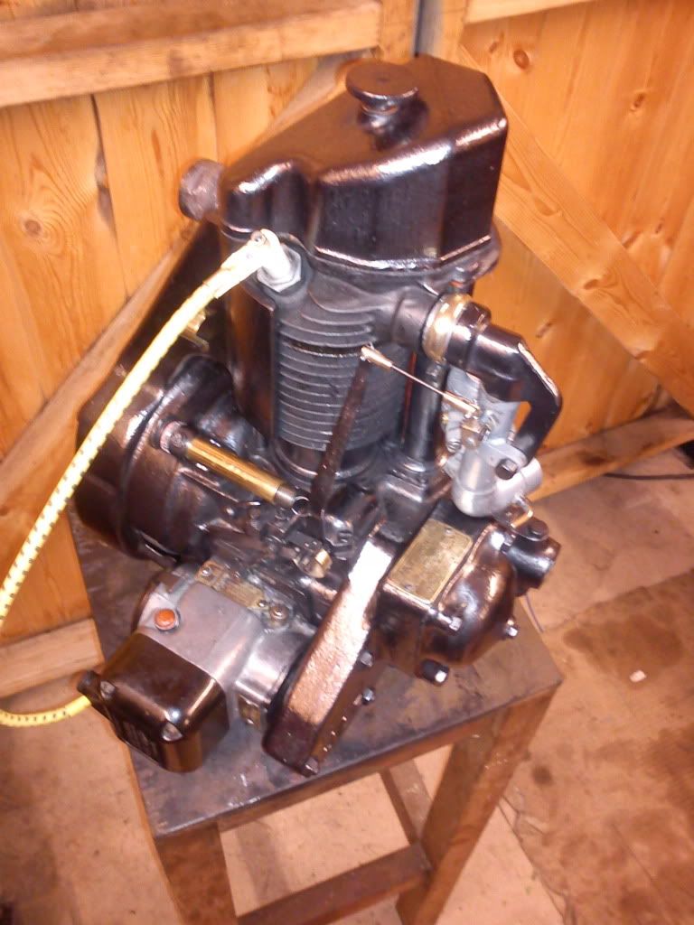

Right, after the successful first running of this engine at the Hassocks Crank-Up I have decided to give her a final paint job. (Also, I'm so bored, waiting for the varnish to dry on the new Tarpen light board, honestly, it's worse than watching paint dry, & a lot slower!)
I haven't got the money to go splashing out on new paint, this one would have to be Khaki anyway, if it were to be anything like original (or possibly Air Force Blue, but I'm told that very few, if any, engines of the war were painted Air Force colours, everything was Khaki). So, I've decided to go along with what someone else has done. I can't remember who it was, but someone said they had painted an engine with blackboard paint, then gone over it with stove black polish (or Grate polish, as it's sometimes known).
I already have a tin & a half of blackboard paint, so all I needed was the stove black polish, which I've been out & got this morning. There are only a couple of problems. 1- My blackboard paint is water based. The engine has some oil on it from running, so I will have to prepare it carefully, as water based paints don't like any oil or grease whilst applying (fine once they are dry though). 2- the supposed "special metals primer" from Hammerite (seriously, if anyone ever tries to sell you this product, do not buy it, it is rubbish) has failed to stick properly to the aluminium parts of this engine, for some reason it is water based, it is supposed to be a special metals primer, which means it should stick to just about anything, but sadly it will only stick properly to steel, & even this must be absolutely spotless & clean, & even then it's a bit of a lottery. This stuff is completely unsuitable, so much so I am considering writing to Hammerite & asking for my money back!.
luckily last week I bought some proper special metals primer, which is oil based. I have given the engine a good clean down with brake & clutch cleaner, to remove as much of the oil & grease as I possibly can, & I've wire brushed it to get all the loose Hammerite rubbish off. I've just finished giving it a rough coat of the decent primer, as soon as that's dry I can start to go ahead with the blackboard paint.
You may think I'm slightly mad, but I have tested this out on a small piece first. Keen followers of the Tarpen 2 thread will have noticed the rocker box cover, sitting next to my newly varnished lighting board. This has now had 2 coats of blackboard paint & a treatment of the stove black polish & I reckon it looks good.
Will upload a pic later on tonight.
Re: Nutgone's little JAP (JAP Model 3)
Post by nutgone on Thu Nov 15 2012, 16:30

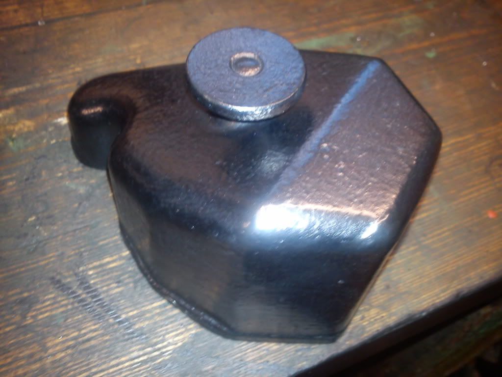

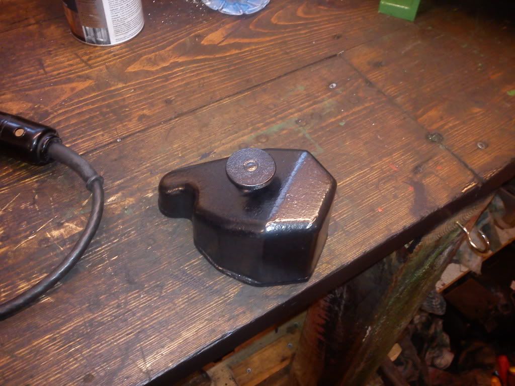

Here we go, a finished rocker box cover....
It's got a lovely sheen to it, without being too glossy (sometimes I think modern high-gloss paints are not really in keeping with what these machines would have originally been coated with).
The good news is, when it starts to dull, or gets a minor scratch, I can make it all better with another coat of the polish.
there are a few brass bits on the machine, which I will keep brass & polish up. I won't be painting the magneto or the carb. I would like to paint the flywheel red, but I haven't got any red paint, so I think I will paint it silver for a bit of contrast. Although I'm told many of these old military engines had their flywheels painted white. I do have some white gloss left over, but it's interior paint for woodwork. Think I will stick with silver & see how it goes.
I might end up hating the whole thing, in which case I can just get some khaki & re-do it. All I've paid out for is the tube of black polish, which was £5.27. Not the end of the world. I got the blackboard paint when a cafe I was working in (& living above) closed down a couple of years ago, leaving me with 3 days notice to find another job & somewhere to live! They did a moonlight flit leaving me to deal with the psycho landlord from hell. Basically I took anything of value which wasn't nailed down as compensation Twisted Evil which included the 2 tins of blackboard paint. (don't worry, that wasn't the highlight of my haul from there).

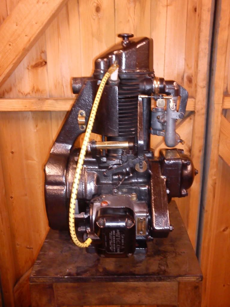

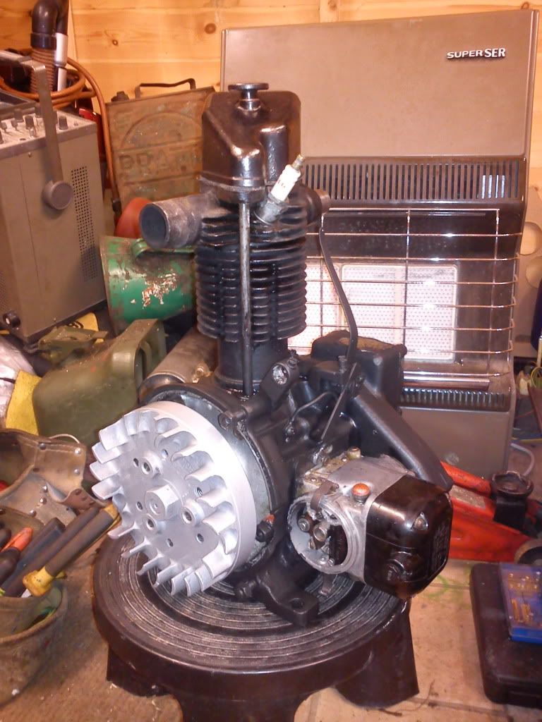

Seems I've been having trouble with all my engines lately, what with the Tarpen refusing to start, the Lister D magneto being seized solid, now a simple idea for a paint job on this engine has just turned into a major chore. Luckily it's a chore I can fit in around other jobs.
The main problem has been getting a water based paint to stick on an oily engine. I gave the whole thing a good clean down with brake & clutch cleaner, as it's good at getting rid of oil & grease residues, but then I decided to give it a coat of primer. A good special metals primer, but an oil based one.
Now, I don't know if I rushed things a bit, maybe I should've given this primer longer to dry, but it seemed dry to me, but still the blackboard paint was having trouble sticking. The first coat just made the engine look like someone had thrown up all over it (the primer is beige, showing through in spots through the blackboard paint), the second coat left a little more on there, but still there were areas where it wouldn't stick & seemed to take ages to dry out.
So this evening I put the heater on & left the engine next to it for any wet spots to dry out. When it was all dry I went over the whole thing again with the brake & clutch cleaner & some clean "blue-roll" tissue paper. Then I gave it a final coat of the blackboard paint, which seems to have stuck really well this time. I'm going to let it dry properly before I apply the black stove polish.

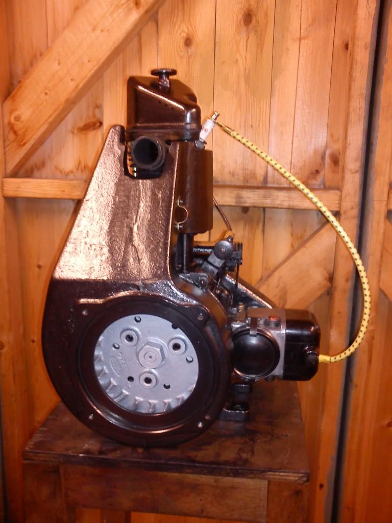

I also took this opportunity to paint the flywheel silver, & placed it in front of the heater again....
I didn't have any of this trouble with the cowling, the rocker box cover or any of the other bits, they've all been painted, thoroughly dried & polished, ready for reassembly....

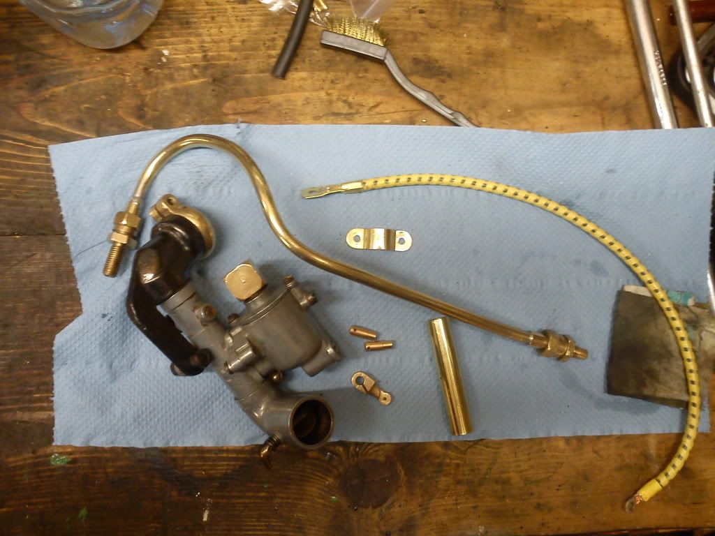

I've also gone to town on the brass bits, they've been treated to large amounts of Autosol polish & all the small bits have been given the battery acid treatment (which is more labour intensive than it sounds, but still worth it IMO), they should contrast the black very well (along with the yellow HT lead)....
Oh yes, the carb got another polish-up as well. All i need to do now is remove any black paint from the more decorative parts of the engine (I wasn't very careful, so it needs removing from the brass plate & the magneto Rolling Eyes ) then I can give the engine a coat of black polish & get it all back together to see how it looks.
It'll probably look bloody awful & I'll have to get some Khaki, but at least I've tried. We need to get some Khaki for the Douglas anyway, unless we paint that in desert sand colours.

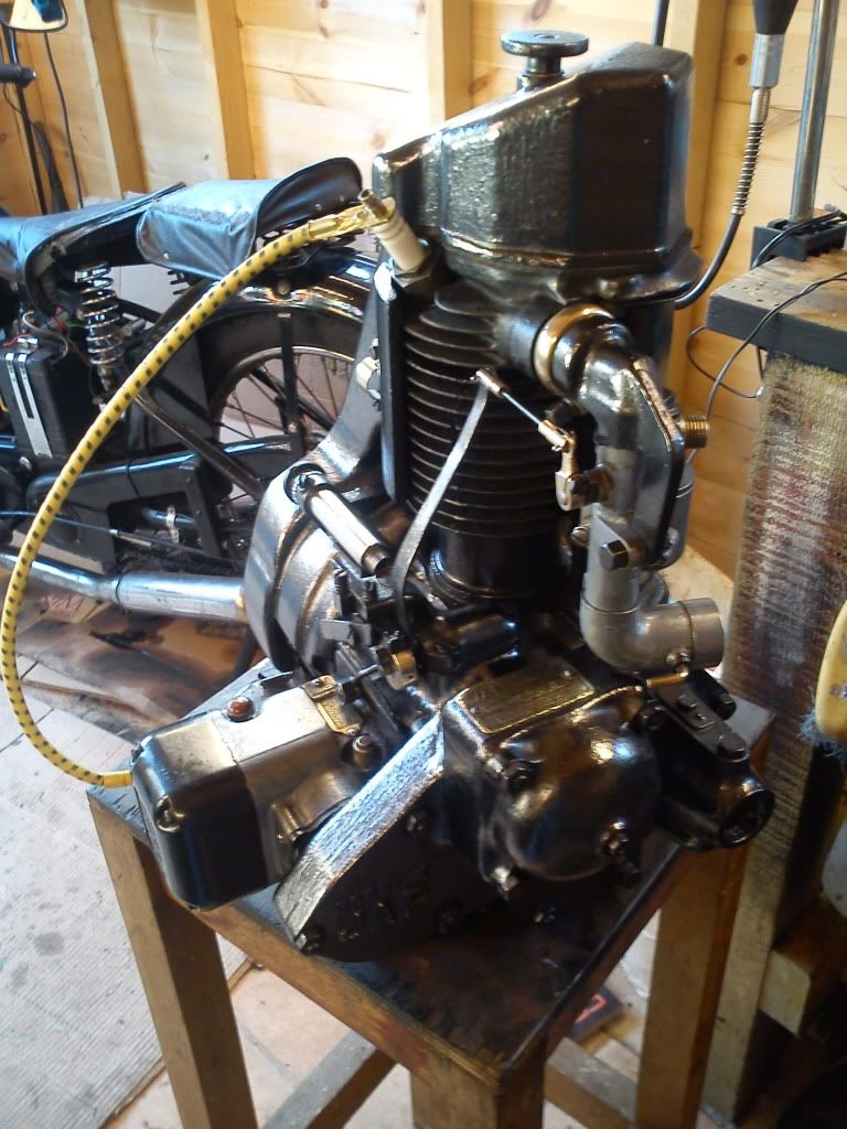

Post by nutgone on Sun Nov 18 2012, 18:19
Not sure my paintwork is up to Abes standards.
I had a look at it this morning & decided to get it polished up & back together. I've been trying to get a decent photo of it, but they all seem to go a bit blurred & none of them seem to look as good as it does in the flesh. So there may be a lot of pics here, but I couldn't choose between them, see what you think....
I wasn't so sure once it was finished, but it's growing on me, & I've gone to a lot of trouble with some of the detailing. I think I will leave it & see how it weathers. I like the idea of being able to go over it with polish when it weathers, dulls or gets a slight knock/scratch.
