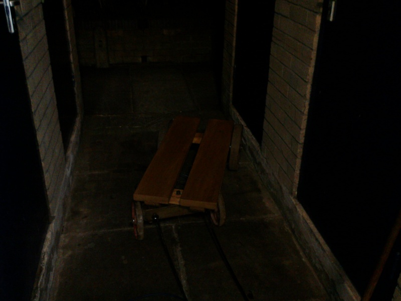

heres the steering trolley under construction for the pearn pump
still waiting for the bar to arrive for the rear axle
so trolley is not sitting level yet, but only clamped loosly together to see if it turns enough

Trolley looks good kev shame the wheels don't match but when there's so much difference in size you'll have a had job finding a set of 4 to match.

the trolley is now ready for the pump to start going on ,as long as the weather holds as it was earlyer before the rain started and went dark 1 1/2rh earlyer than yesterday Rolling Eyes
so the pics are in the glume sorry lads will do them again as soon as
2x oak 8" wide 1 1/2" thick planks on a ash and ceddar frame
with old cart front axle and wheels as found last year, just treated the old timber
solid bar rear axle made today from lengh off fleebay Very Happy

Looks to be a good strong trolley Kev.

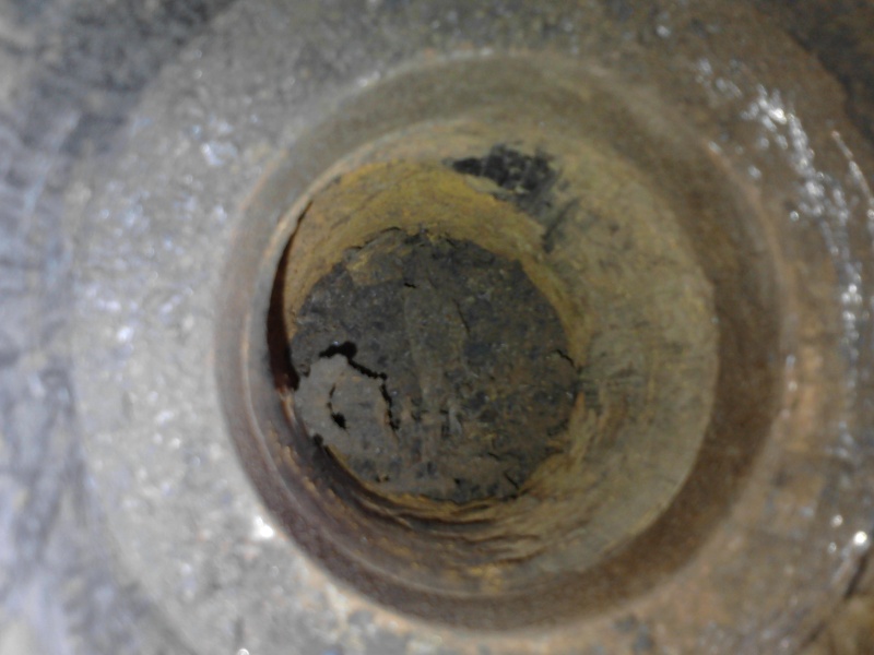

ripped out the old glad packing, well rotted and stuck in place
after sneaking out with the hoover and sucked loads and loads for fluffy rotten crumbs of gland
then in with the new 1/2" x 1/2" seal, had to hammer it all the leath as to tight to get down as it was
so with a little oil ,wooden punch , and the trusty leather hammer perswaided 6ft of gland down the bore Smile
this is the 14" long off cut
then tightened down the glad compression/retainer sleave, Smile
