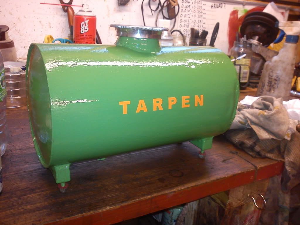

I also had a bit of a sort out & found the only spare "TARPEN" tank transfer I had made for the last one. I know it's probably too early, but I couldn't resist putting it on....

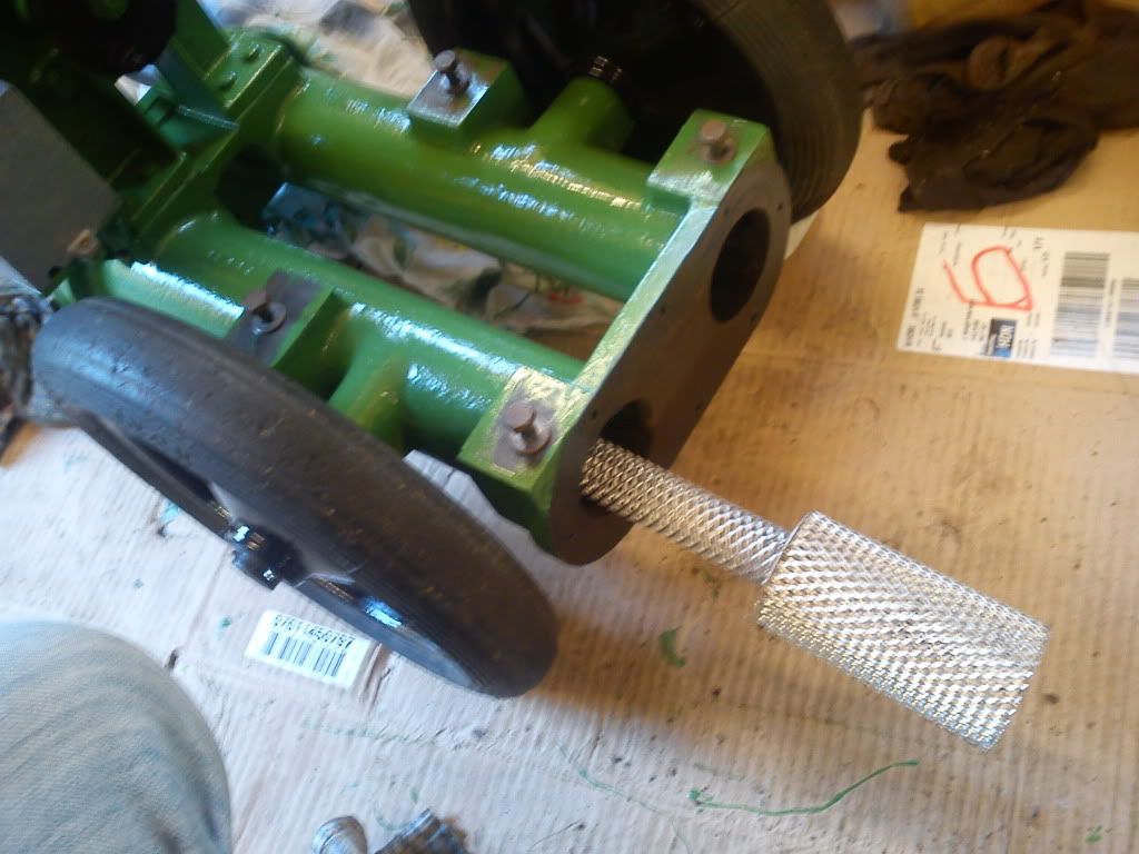

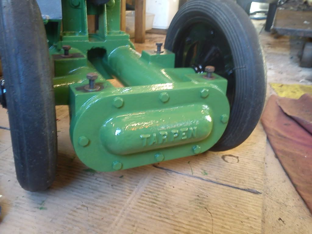

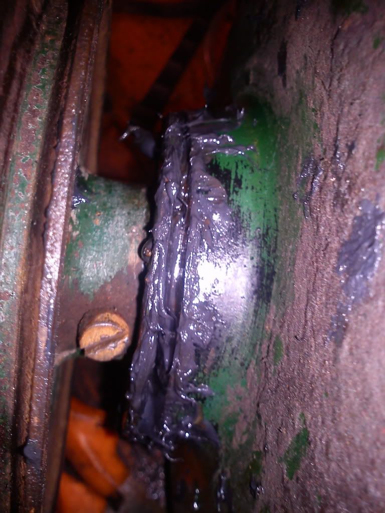

So, off came the back flange from the chassis. Sounds easier than it was, I put it on with Blue Hylomar & it really took some getting off. But off it came & in went the silencer....
Bolted it all back together, touched up the paintwork & job's a good'un....

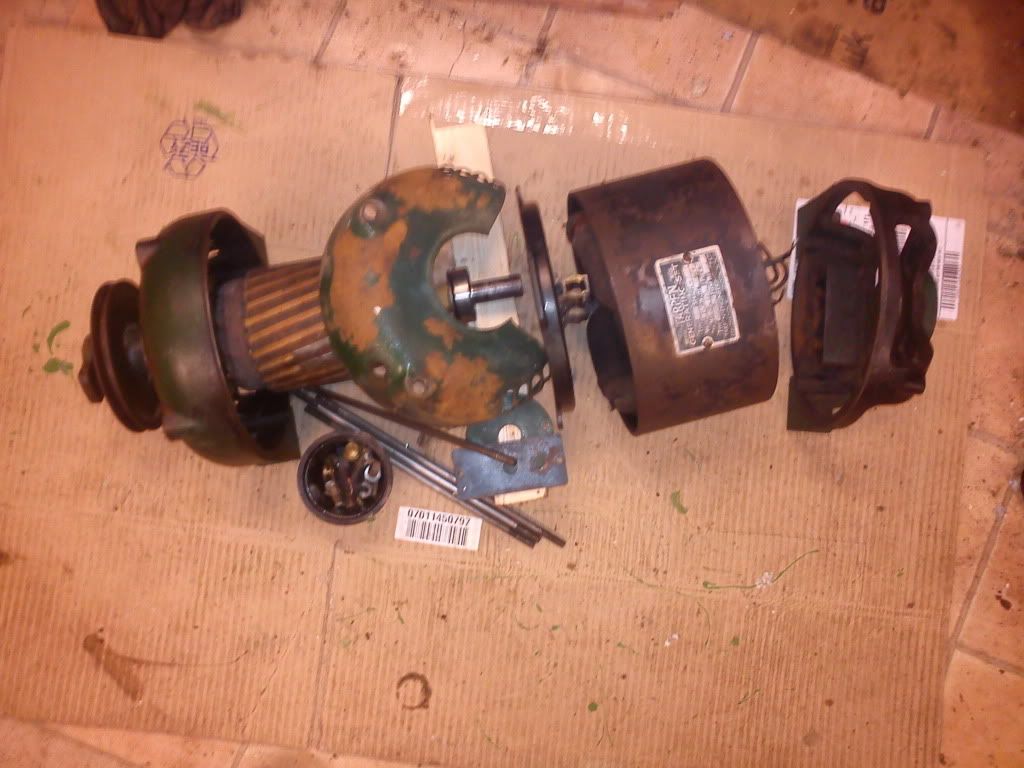

So, then Ian arrives with the other bits & I set to work dismantling the genny. The main problem is getting some grease into the bearing at the engine end. This isn't easy with a pulley & drive coupling flange firmly fixed to the shaft. I decided to have a good think about what to do. Then I spotted a big syringe & had an idea.
I managed to take the bearing plate off by removing the 4 screws with pliers to reveal a tiny gap where I could get to the bearing. It was here I decided to inject grease in through some small flexible tubing....
Hey presto, it's all back together, nicely packed with grease (a messy job though)....
I cleaned up the commutator, scraped & cleaned the crud off & degreased the various bits as best I could, then wire brushed all the little nuts & bolts, bits & bobs ready for tomorrow....

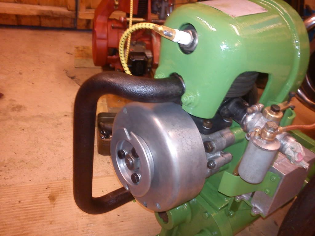

I've been busy reassembling & painting today, will upload some pics in a bit.

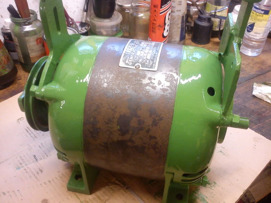

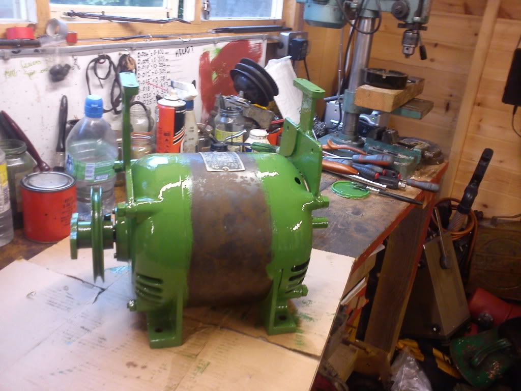

Right, I'm getting tired now, it's all catching up with me I think. Anyway, I put the genny back together this morning....
Painted it up....
then wiped the green off where the black's going to go....
Then Ian came round with the Briggs, my parents went to the vet with the dog, so I was helping him & running in & out trying to cook the dinner at the same time.

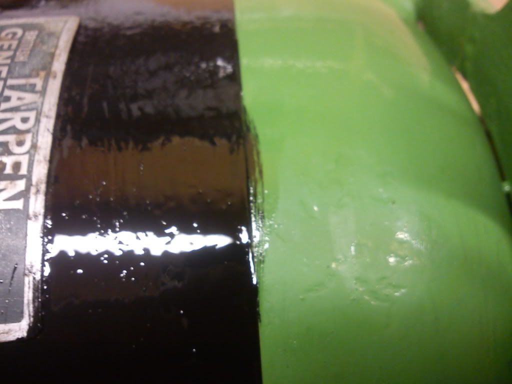

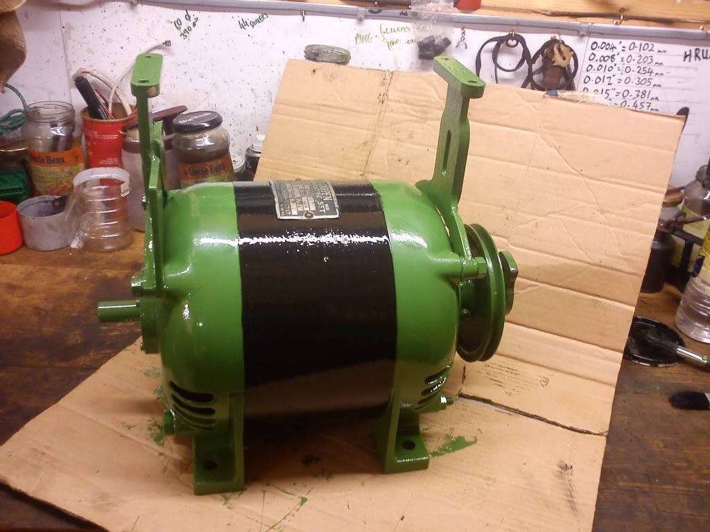

OK I've done it, I've painted the black stripe on the genny....
I only made one slight mistake (the "bloom" on the green paint is just condensation from my breath)....
I am now officially knackered! I didn't attempt to put the mistake right as the green paint is still quite tacky, so it'll either have to stay like it, or wait until it's dry to put it right.

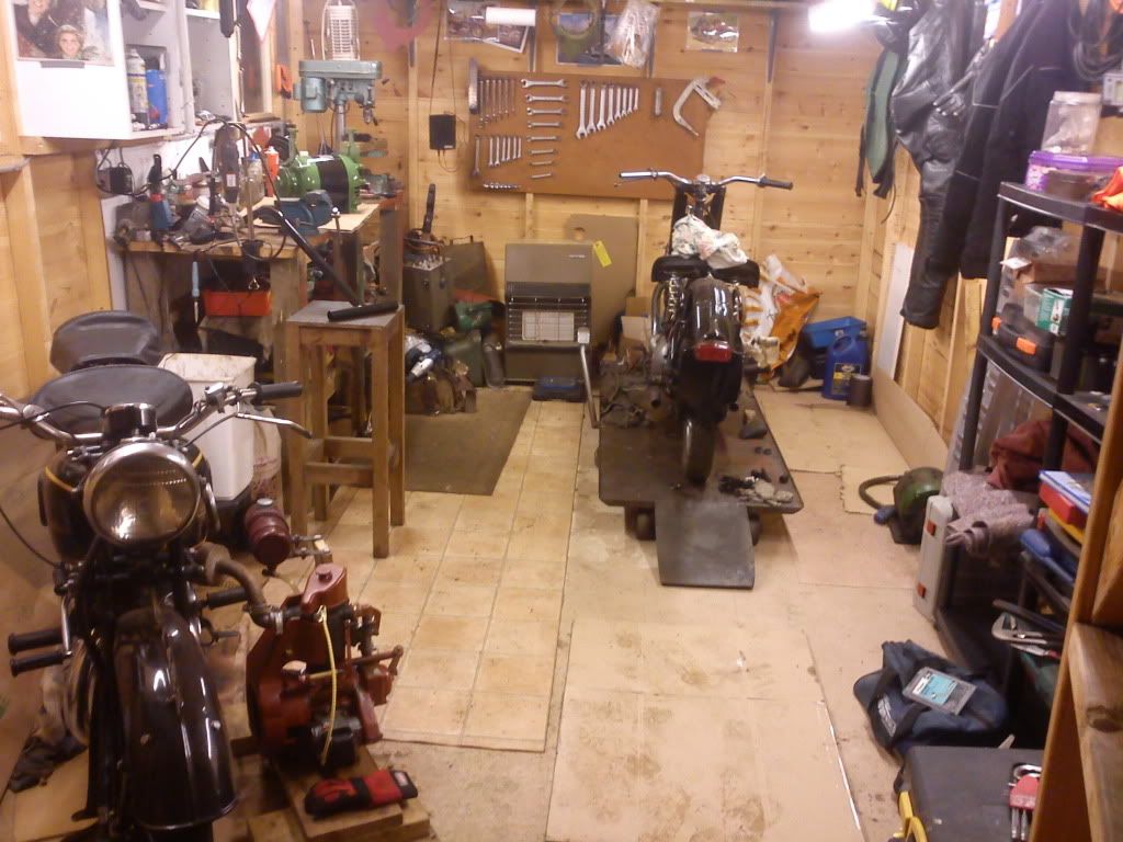

I managed to find the energy to give the workshop a good clean-up though, Ian left quite a mess behind....
The calm after the storm (should keep my dad happy at least)....
& yes, that is what I call tidy. Admittedly the far corner needs a sort out, but I'm looking for a filing cabinet to go in there. It's getting there anyway, trouble is it's me doing all the sorting, so whenever my dad comes to do anything in there he always has to ask me where everything is, then my payment for having use of his workshop is usually to tidy up after him as well! Rolling Eyes

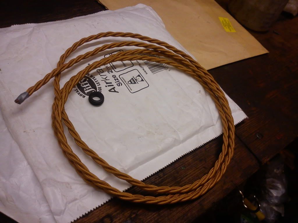

Right, back to business. Today I went off shopping, I got myself some black rubber flex, some brass lampholders & some wood. Then I ordered a fan belt & set to work on the genny wiring. I had already prepared the ends of the old wires from the genny & sleeved them with heat shrink sleeving of appropriate colours.

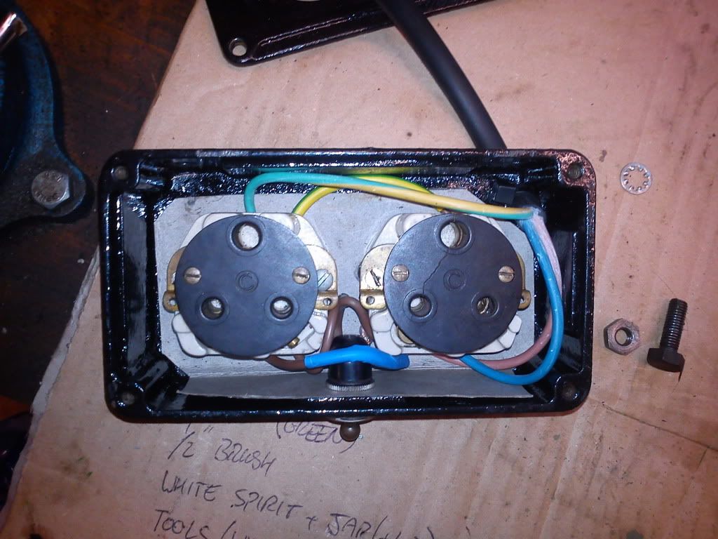

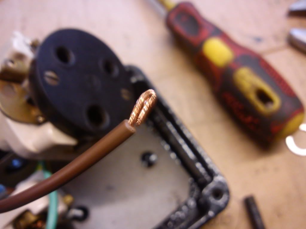

I started with the plug socket. I've already made up a new paper gasket to replace the old one which goes between the connections & the metal box (they shouldn't touch anyway, but it's always better to be safe)....
I had to solder new wires to the old switch then somehow manage to squeeze everything into the socket box....
One thing I would like to add, if I could ever pass on one piece of information, as an electrician, it would be this: Terminals. It is important to get as much copper (IE: the wire) into the terminal as possible, hence it's always best to do this....
Terminals are an electro-mechanical connection, they should always be done up as tight as possible & be of the best quality. If you can fit the wire in with the end doubled over then you should. Braided or multistranded cables should always be twisted to collect the strands together, this makes them more rigid, but you shouldn't twist separate cables together (unless they are to be soldered) as this is bad practise & makes for a bad connection (I know we all do it, & if you do then make sure you give them all a good tug when the terminal screw is done up, to make sure they are all tight in there).
Electrical terminals, in operation, will get hot or warm, then go cold again, then warm again, then cold again. Over time, this heat/cold cycle will expand & contract the metal & loosen the terminal, so this is why I think it's so important. The looser a terminal gets the hotter it will get in operation, until one day it catches fire.
OK, electrics lesson over for today.

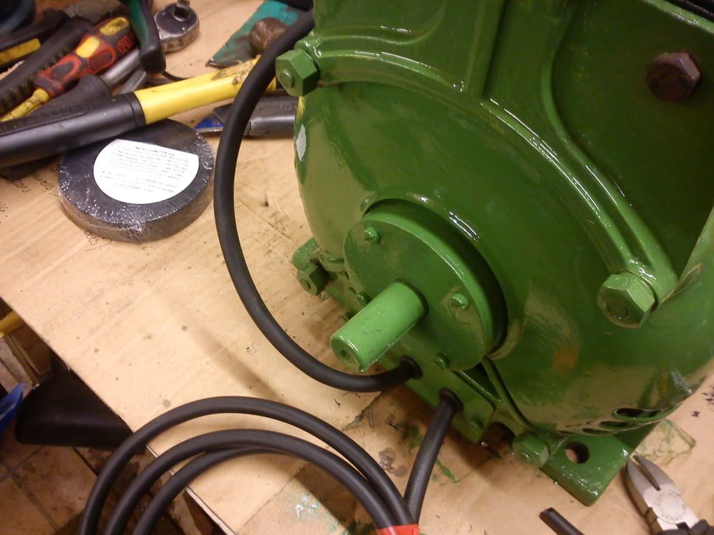

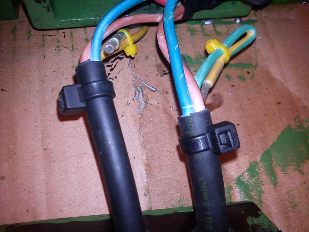

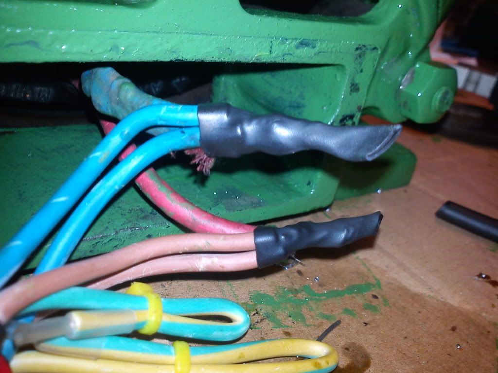

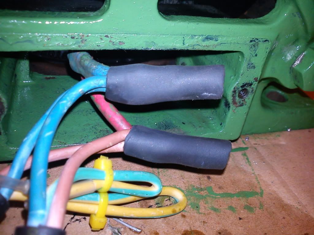

The original genny connections were soldered with rubber tubing stretched over, so I decided to do this again & use heat shrink tubing instead....
I didn't like the idea of a thin layer of heat shrink tubing on its own, so I stretched over some of the rubber from the outside of the flex to give better protection, much more like the original....

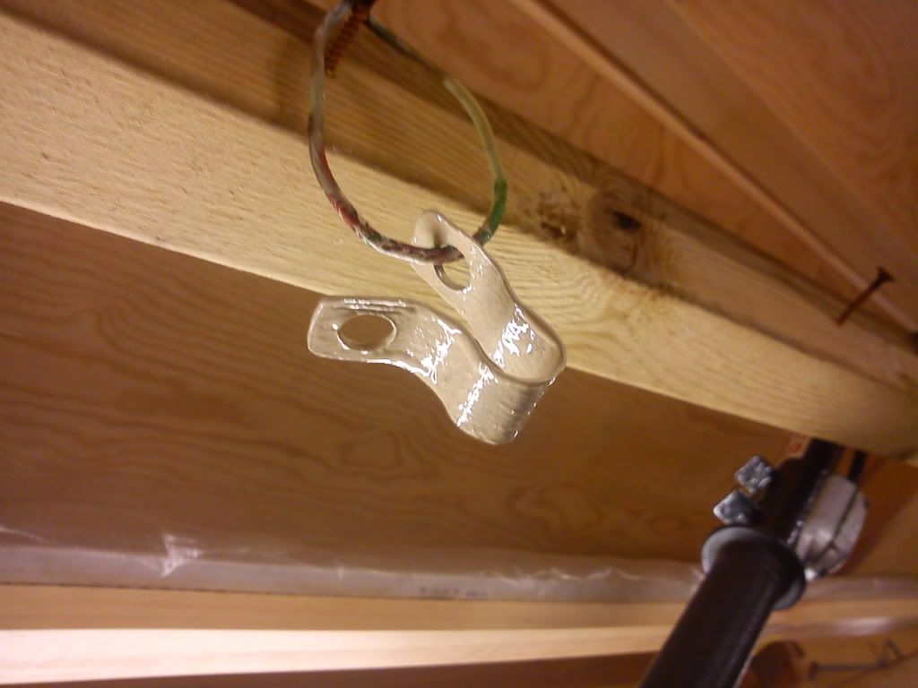

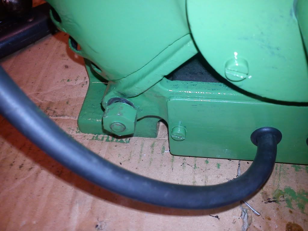

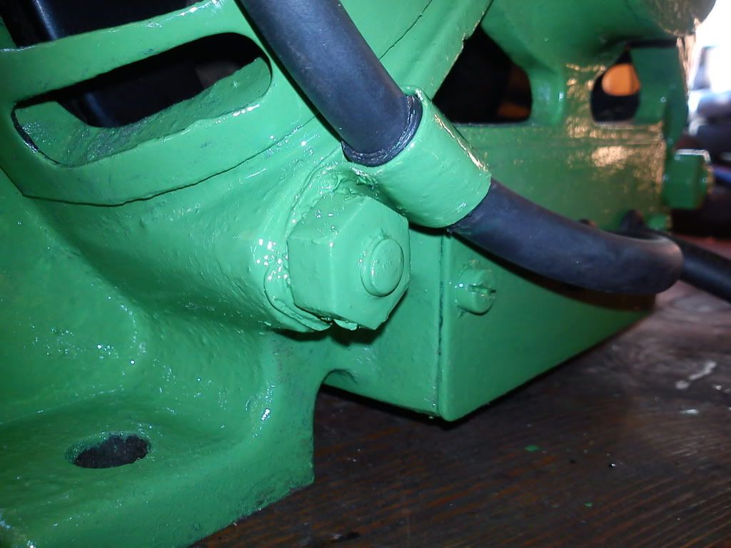

Another little trick I like to use, I like to have cord grips of some sort on anything with flex, so I put a cable tie round the flex & pull it nice & tight, just in case anything should ever yank the lead....

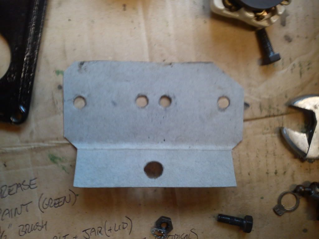

Now, I wasn't very happy with the flex here (from genny to socket), it's likely to get in the way or get caught up on something....
So I've made up a small aluminium P clip, which I will fasten onto the generator bolt (when the paint's dried)....
It'll fasten on here....

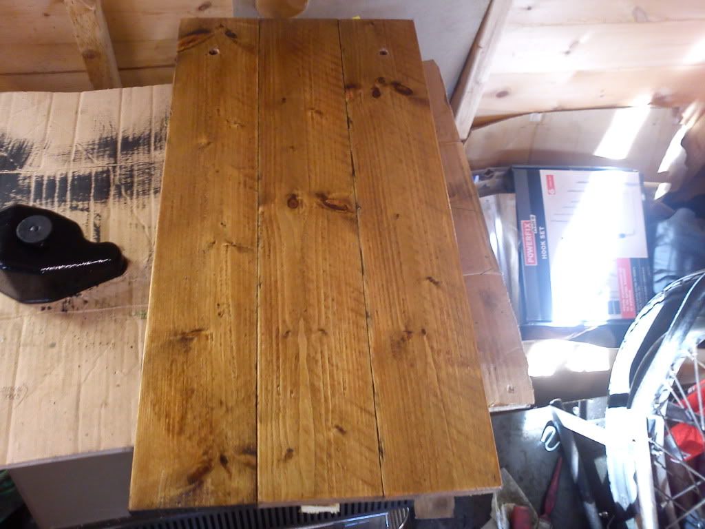

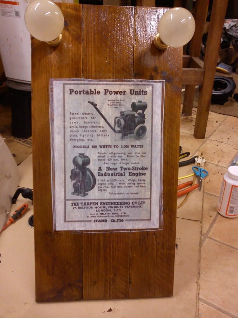

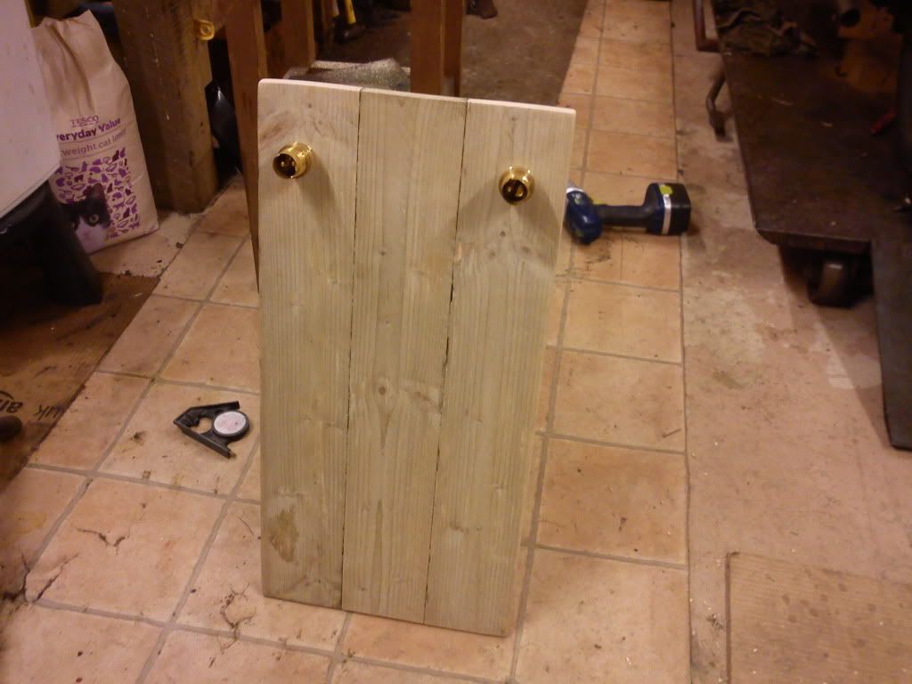

Now I set to making a lighting board. I got my cheap timber from Wickes, a 1.8m length, which I cut into 3 pieces & used a piece of batten (also purchased today from Wickes) to join it all together....
I've spent ages since that pic sanding it down to try & make it reasonably presentable. I will pop to my local hardware shop tomorrow & see if I can get some cheap varnish & stain, or an all in one. I've wired the lamp holders to short flexes & wired a plug to a longer one (all made from my leftover braided flex from the other Tarpen). I should have it all together tomorrow. I'm going to put a print-out of an old Tarpen advert from the 1930s, featuring this particular generating set, onto the board & seal it with some special hobby glue stuff my mum's got (which looks & smells suspiciously like PVA) & that'll go with the engine to make up an exhibit.

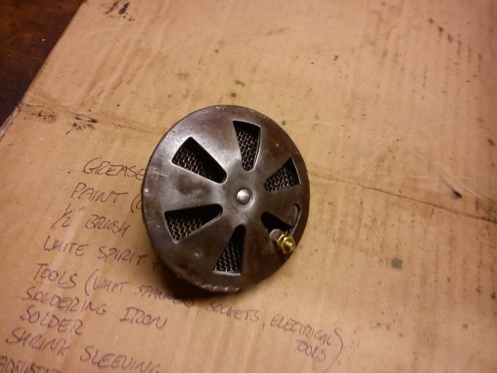

Oh yes, I really need one of these....
This one one has had it, I'm not kidding, normally I would repair anything, but this is beyond repair.
The hole in it is just under an inch (internal diameter), but it's difficult to measure as it's been knocked about & bent. I haven't got the carb here to measure, but it's a pretty standard size, usually found on Villiers carbs.
Anyone got one or know where to get one???

i did have 2 of these and i only need one, if i still have it around the villiers spares shed shelf
will have a look for you
mine were fitted tovilliers mk20`s off atco ride on cylinder mowers
give me the external front diameter and try and get the carb mounting measurment off your mate storing the other one for you,
so were dealing with the right thing to start with as there are 6 different carb filter mounting diamentions that i know to off the top of my head mate

Cheers Kev, I'll get some proper measurements for you off the carb, or perhaps Ian can do it for me, as it's in his garage. The one on the other Tarpen actually has Villiers written on it, so I'm not too bothered about it being an exact match, just as long as it fits & has a built in strangler for the choke.

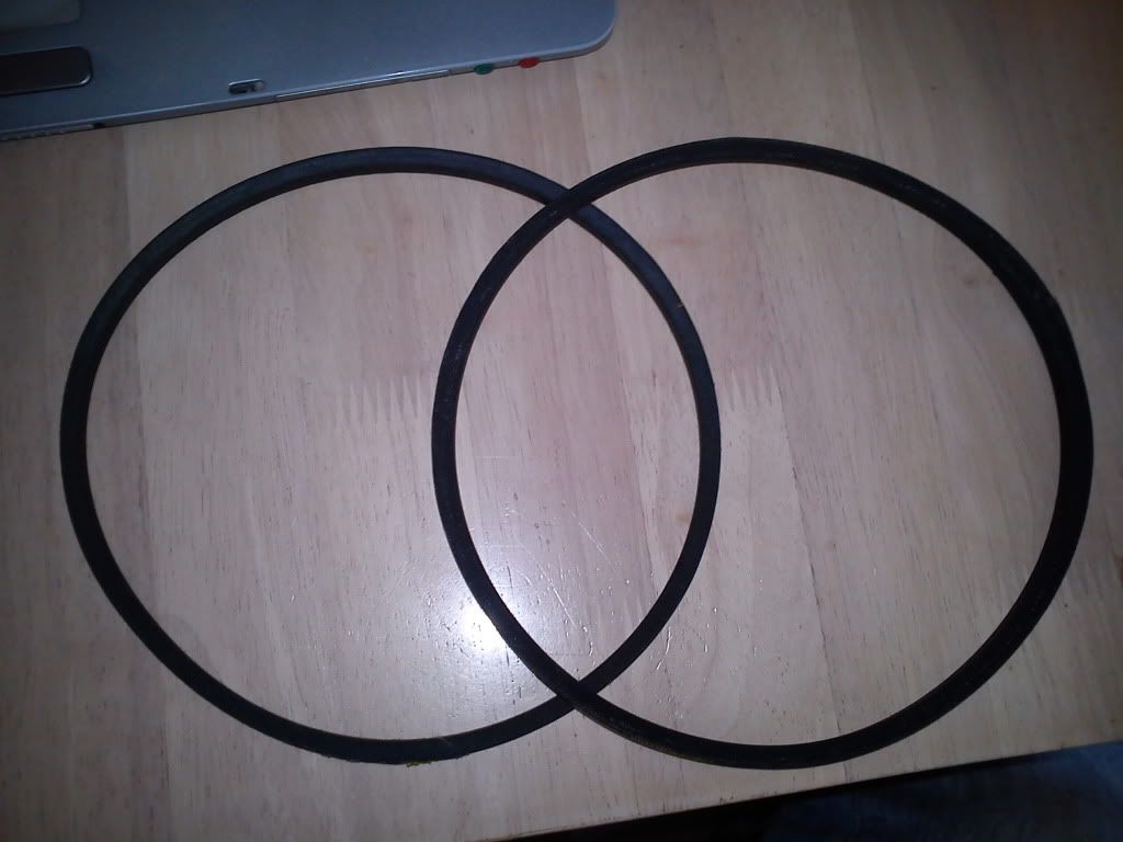

Anyway, the fan belts arrived today (that was quick, good old Beltingonline, I would always recommend them for any belts, pulleys, sprockets & taper-lock bushes etc etc, their service really is brilliant & prices very reasonable)....
I ordered two as I wasn't sure on the size. The belt on the other Tarpen is a 580mm, but beltingonline only sell Z section V belts in inches. I emailed them last week & they said I either wanted a 21.5" or 22" belt. As they were only about 86p each (plus VAT & P&P) I thought I would order both & fit whatever goes best. In reality there's very little between them, so the other one can serve as a spare for my other Tarpen.
I've just got back from the hardware shop with some stain/varnish in one, so am just about to finish off the lighting board & other bits & bobs.

Sorted the flex from genny to socket problem....
I put a couple of layers of self-amalgamating tape over the flex, to protect it from the metal (would've been fine anyway, but it's the electrician in me coming out again) & touched up the paintwork....
Also put a coat of stained varnish on the light board....
Damn stuff takes 16hrs to dry before I can apply the 2nd coat, then it'll be another "God-knows-how-long" until I can safely handle it (I'd forgotten just how long varnish takes to dry).

I'll pop down to the garage now and measure the carb.................
0.95"/24mm
So, just under an inch, something like 15/16ths although I'm sure a 1" could be made to fit Wink

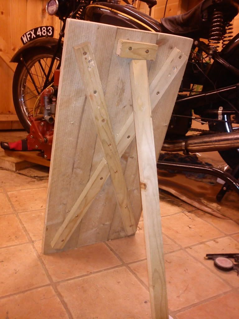

There is a hinged leg on the back of the board, so it's a completely self contained unit, ready to rally with the engine.
So, it's off to Ian's tomorrow, to put it all together & take some pictures. I've got a little job to do on the JAP Model 3 first, but I should get out there just after lunch.
