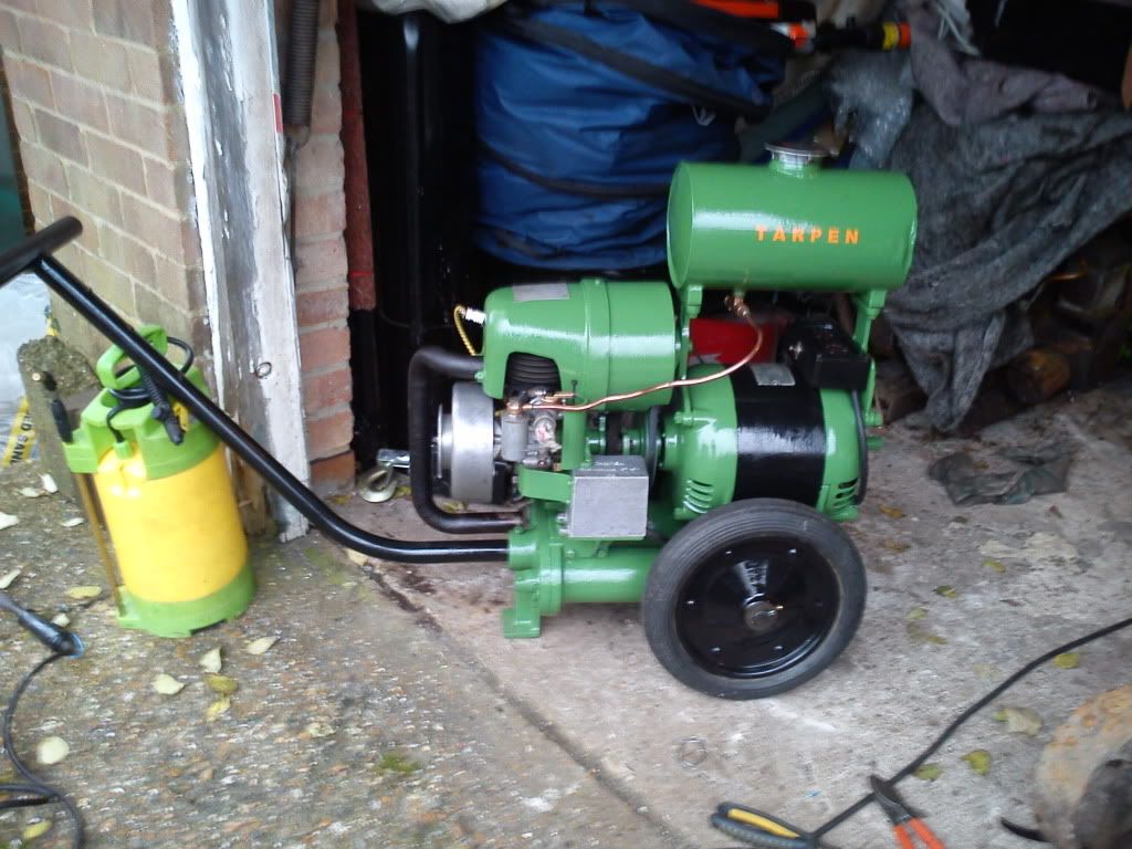

Really not happy now. I got the thing together easily enough....
But after hours of pulling, & injuring my shoulder, I can't get the bloody thing started! It'll pop a few times, but won't catch on. Which I can't understand, as it started so easy when it was just the engine on the bench.
I've tried just about every conceivable different carb & choke setting, I've emptied the crank case when it's flooded, I've cleaned & changed the plug, tried different plugs, different plug gaps, different throttle settings, but I can't get the f*cking thing to start!!!
OK, I've had a couple of pints now, so better not say any more. I bet Ian will just walk up to it, pull the rope & it'll run!
Oh well, I've left it like this....

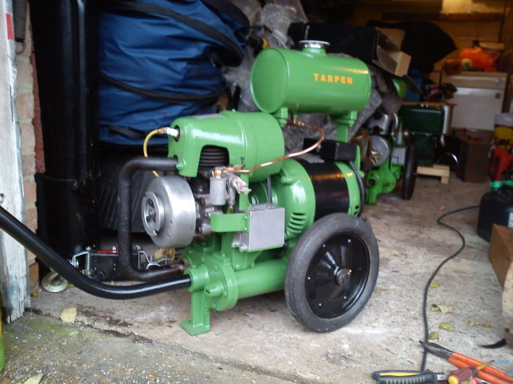

Anyway, true to his word, Ian came round today with the Tarpen & after a LOT of mucking around & pulling at the rope we managed to get it started!
This involved loosening the generator mounting bolts to free things off a bit, also a lot of carb fiddling & taking apart & clearing of jets. I also adjusted the timing in both directions. I can't quite remember what I did to get it going but it did run. We ran it for a couple of minutes, at first it faltered a bit & I managed to keep it going by richening the mixture as it was far too weak. Then I ran out to the car to fetch the light bulbs & we plugged the light board in, it all generates power as it should & the governor works, which is great news.
Then I stopped it by closing the throttle. I knew dinner was almost ready at this point. I thought the ultimate test would be to see if it would start again.
Guess what???....
It wouldn't!
Even letting it cool & having another go after dinner, it still wouldn't start, & once again I've started fiddling with the settings, so I've lost the magic combination, which wasn't so magic after all.
So once again I'm at a loss! I'm fast running out of ideas with this one now. When it ran it ran really well, & I mean REALLY well. there's a cracking spark there & there's definitely fuel getting through. What gets me is we've always had a Tarpen like this one, years ago we had another one like this & they have all always been really reliable & very good starters.
I think the main culprit is the carb, but just to be sure I'm going to take the head off tomorrow & see if I've done something silly like put the piston back on the wrong way round. In theory it would still start like this, but not easily.
I actually hope it is something silly like this. i would feel a bit silly, but it would put my mind at rest. I really want to sell this one on if possible & move onto something different, but I can't sell it if it's not going to start.

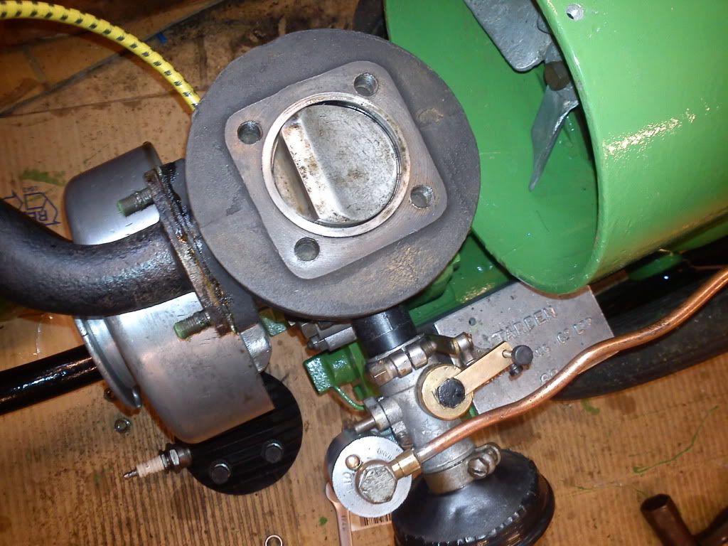

What a dickhead! (not you, I'm talking about me ) Look what I've done....
I have put the piston back in the wrong way round! Can't believe it! I suppose it was mainly because I put the piston back on whilst the crank shaft was still out. All I had to go on was one end had a left hand thread & the other was a right hand, must've got it mixed up.
I've taken the barrel off & changed it around. Had a little bit of trouble with one of the circlips, but it didn't take long (Ian was here to help out as well, he managed not to break anything this time )
Now it's all back together properly it starts first pull every time. It's got to be one of the easiest starting engines I've had. The genny gives a good output & the governor works really well. In fact it's such a good little runner it seems a shame to get rid of it now.
Anyway, I might feel like a bit of a t*t, but at least it's something definite & now I know it's sorted.
