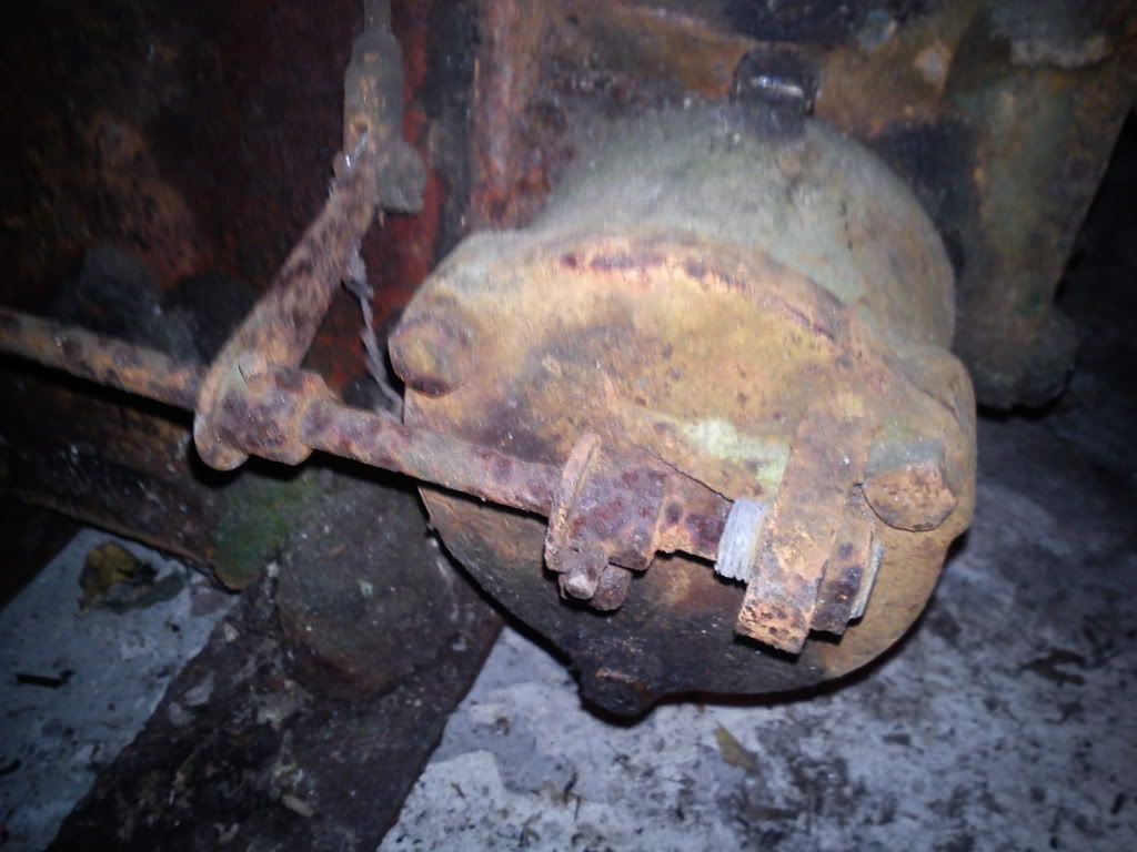

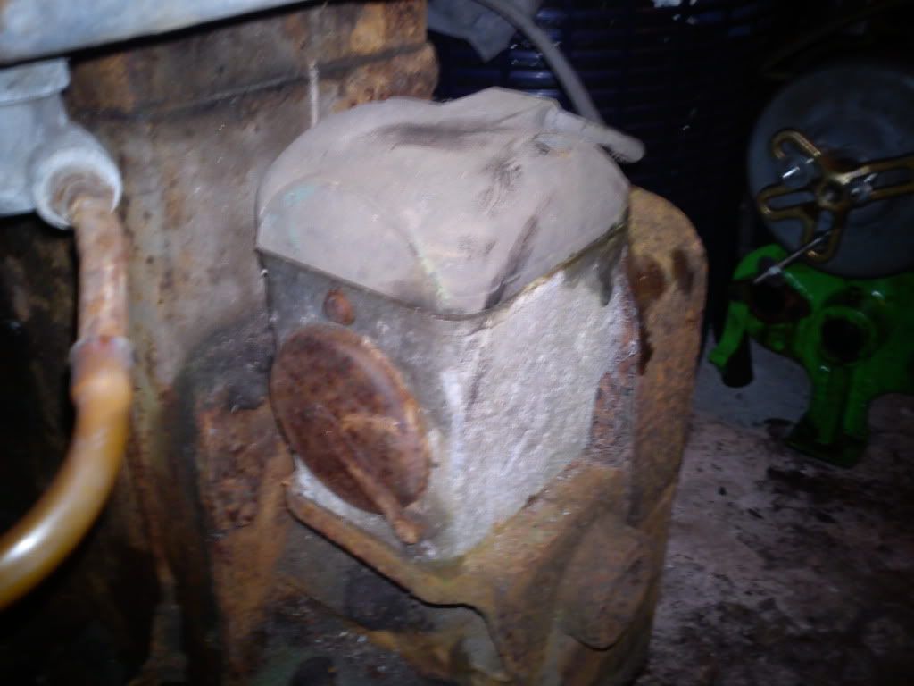

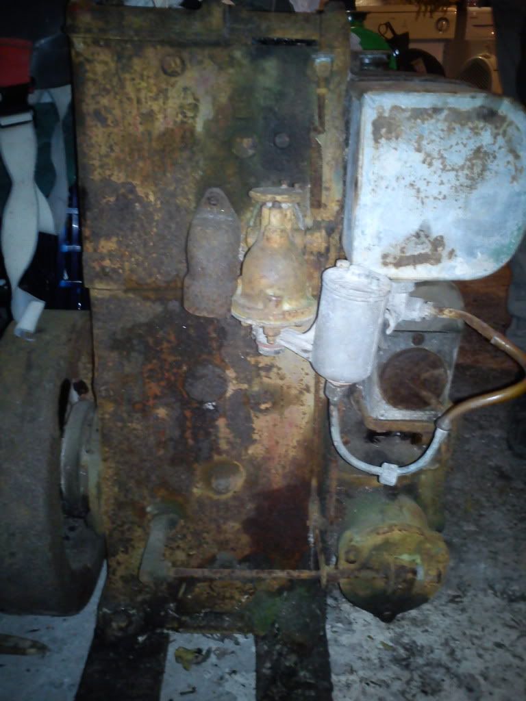

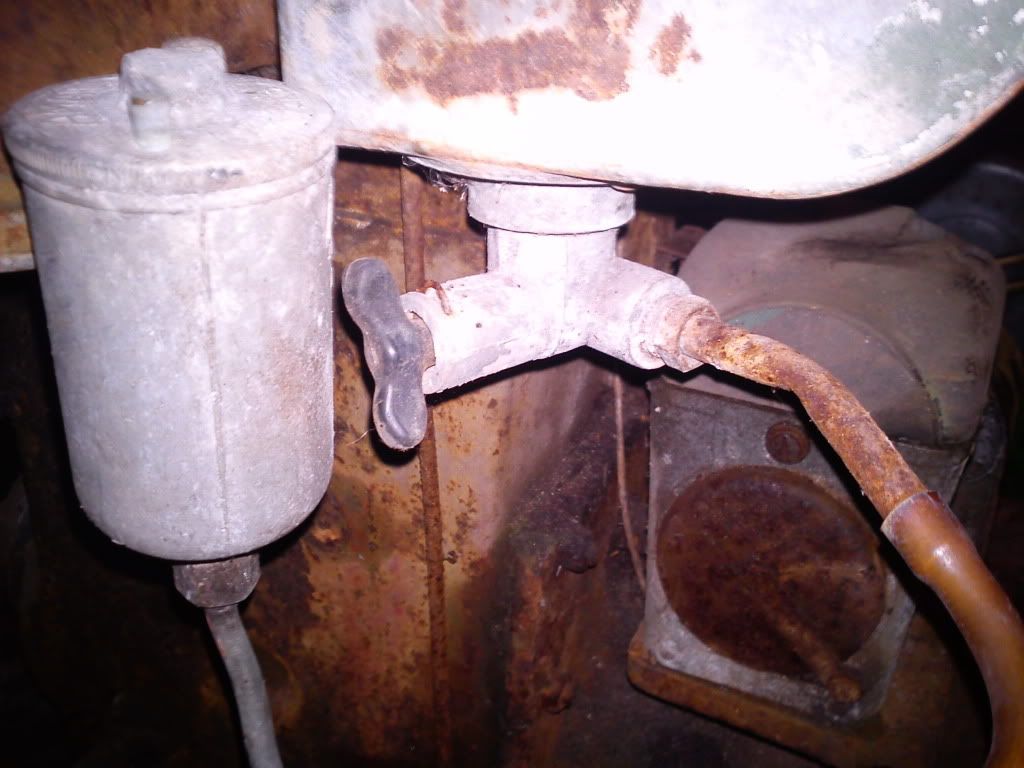

So, the engine:
All the usual bits are corroded & stuck, namely the carb mixture screw, the carb inlet thingy, which should bounce up & down, the throttle/governor linkage & the float chamber tickler (OK, now I'm just being picky).
There's a snapped exhaust stud & a few other bits & bobs which I can see will need sorting.
I would like to get the carb off & all freed up. I would also like to get the governor apart & make sure that's free. I would also like to get the mag off, clean it up & see if it works.
Then I would like to see if she'll run, before we take her apart for the full nut & bolt rebuild. & believe me, this one really does need the full works. I might not bother to remove the flywheel, as I believe you can get to most of it without, but the rest will certainly need full restoration.

Well it looked in decent condition in those ebay pics and I thought that an 'oily rag' restoration was on the cards, however it looks rough in your photos so I agree that a total strip down is needed! Personally I would take the flywheel off as you can't get to check the main bearing ball races otherwise and they are usually full of congealed oil I'm afraid. There are a few differences with the reverse rotation engines, the mag direction obviously, plus the carb butterfly, starter dog, and the oil trough in the sump, and the valve positions are reversed. The inlet valve has a thicker head than the exhaust valve by the way. Plenty of D type knowledge on here. Wink

It looks to have stood out in the rain for a while which is a shame. I would say that mag needs to be looked at and fingers crossed it's not seized. As for the carb a good soak should help resolve alot of problems there.
