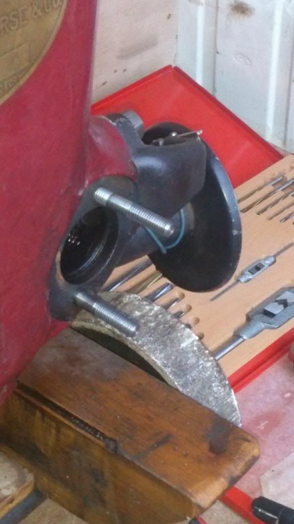

right lads i have been busy but i have managed to sort out the thread problem with the valve / fuel mixer assembly . The threads was that worn that you could pull bolt out without unscrewing it and wouldnt clamp down tight .
So i got a friend of mine to turn up some studs up and i drilled the holes out and helicoiled them fitted helicoil with bearing fit compound . My theory was when you take the casting on and off so many times in its life you will be wearing the threads in the hole slowly . So with studs you wont have any fear of damage as will permanently stay in there .
with the mixer back on .

Post by Lewis MacRae on Fri Sep 27 2013, 06:58
Looking good, that's a new looking tap n die set you have there?
Re: new toy . Fairbanks headless
Post by matt86 on Fri Sep 27 2013, 08:29
Thanks but it's not a tap and die set. It's a reamer set and it's old but we'll looked after.
