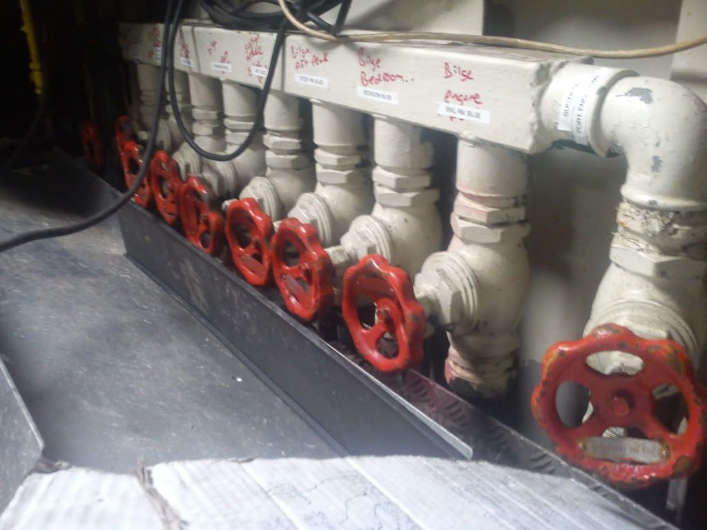

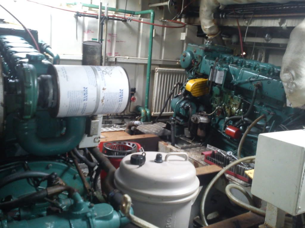

Here's a few pics of my friend's boat I've been working on recently. It's ex-military, Sweedish, he wants to convert it to live on & wants me to sort out the electrics & domestic systems. Here's some of the existing electrical panels....
Here's the bilge pump control valves....
& here's a couple of shots of the engines, there were originally 3 Scannia engines of 300bhp each, these were replaced with 2 Volvo Penta units of 450bhp each, real monsters!....
