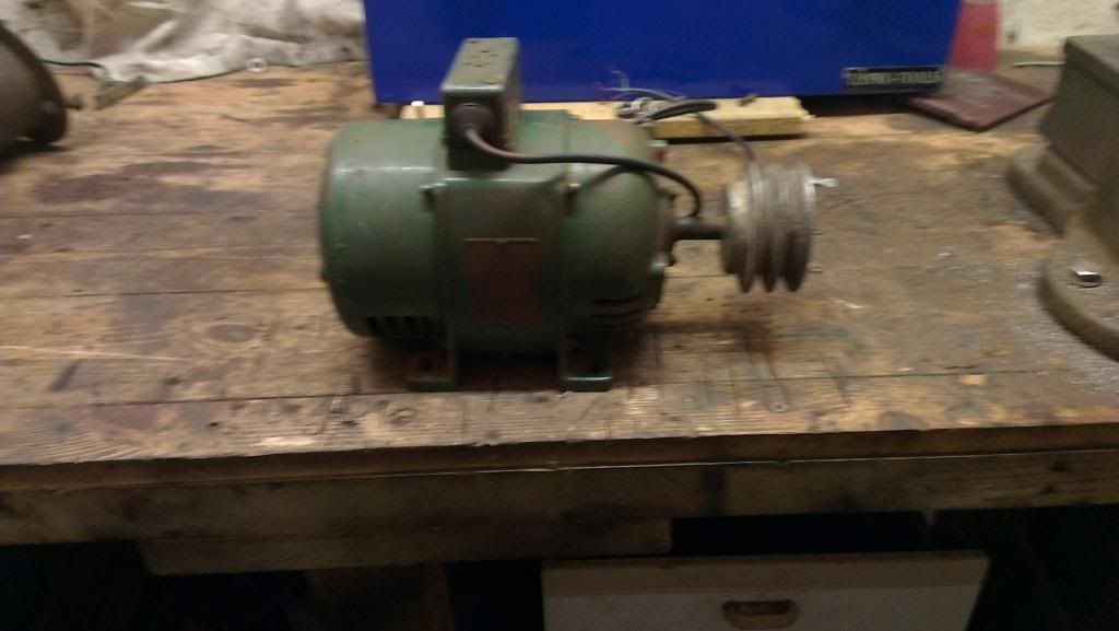

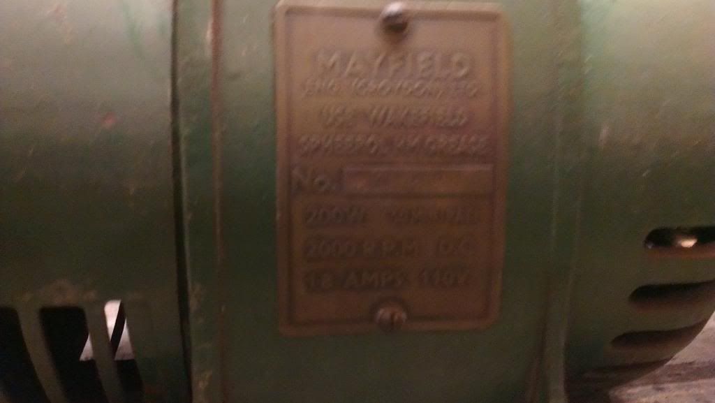

I will go out and take a picture of it for you all to see , and one of the plate too .
Re: dynamo power output
Post by matt86 on Thu Nov 15 2012, 20:02
as promised a few pictures and yes it is a small dynamo !
and under closer inspection it is 1.8 amps Embarassed

Post by Ianhw77k on Thu Nov 15 2012, 20:09
and 200W Rolling Eyes
Nice little unit though, is it going on one of your open crankers?
