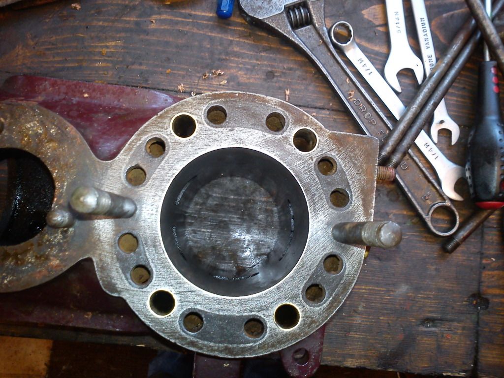

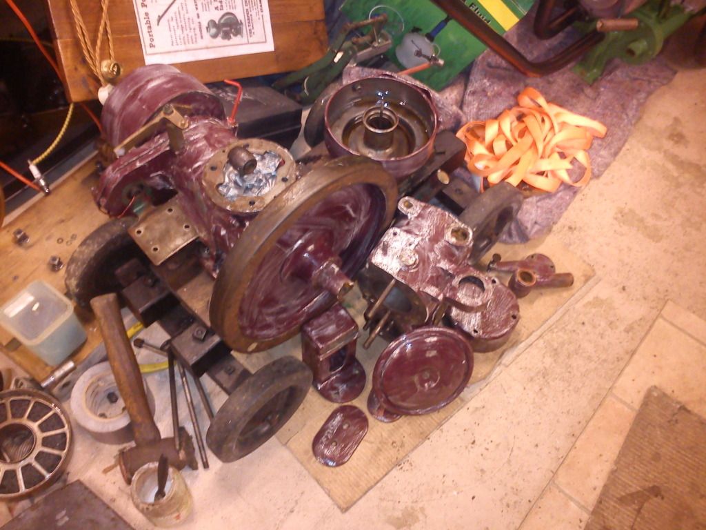

To start with I decided to give it the usual service treatment to the top end, which involves removing the head, barrel & piston, cleaning & de-greasing it all, de-coke the piston, the backs of the rings, the ring grooves, ports, head etc etc, clean, scrape & polish all mating faces & cut new gaskets for everything....

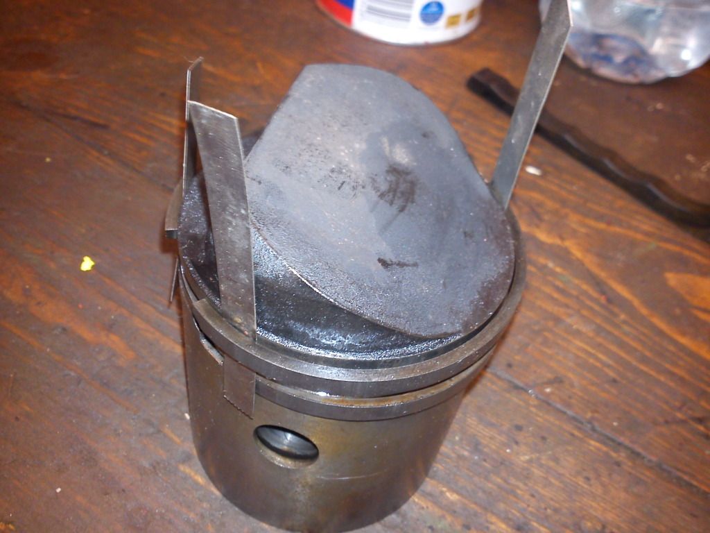

I removed the piston rings to clean & check. I know we probably all know how to do this, but I've always mentioned the method I use, with 3 strips of metal (more for larger pistons), but never bothered to show a pic of what I meant, so here goes....
This is the safest method (without special tools) & with a little patience should get the rings off without any damage. You need to be careful with piston rings, they are very brittle & won't take a lot of stress in the wrong direction. They are also very very sharp on their edges, so be careful. (Like I say, you probably all know this, so apologies for teaching granny to suck eggs).

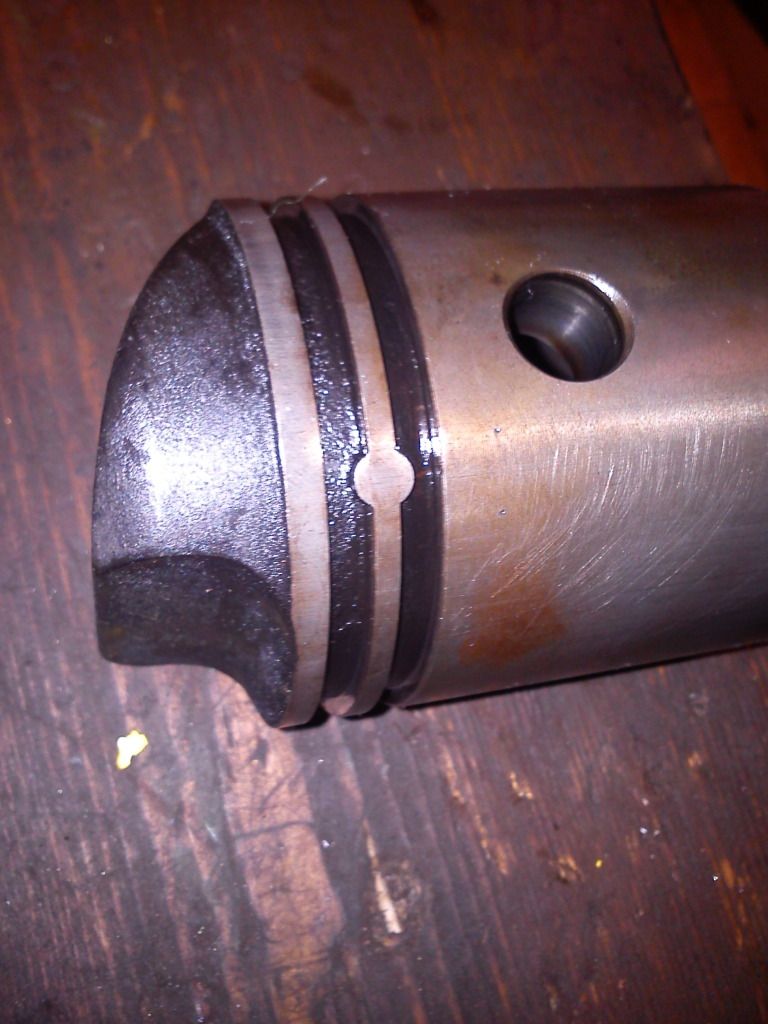

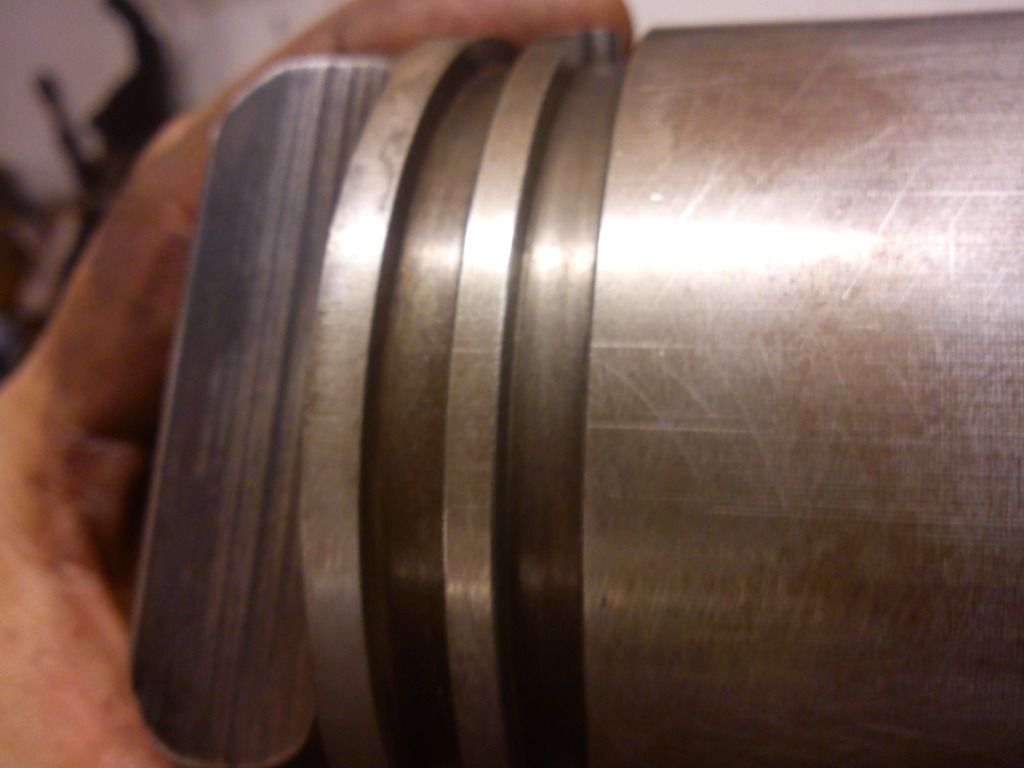

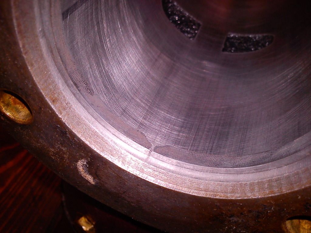

Anyway, I can't say I'm impressed with Stuart Turners now, I always thought they were good little engines, but now I can see why they are so temperamental, just look at the piston ring pegs for example....
To save time, effort & money they've just put one big peg in the piston ring grooves, so now both ring gaps will be in the same place! Shocked I mean, how bloody silly is that?!! We are always told not to line up the ring gaps! They make it so you have to!
I'm also less than impressed with their porting & their head design. The spark plug is in the wrong place in the head, it more or less sits over the wrong part of the deflector top piston!
Anyway, I digress....

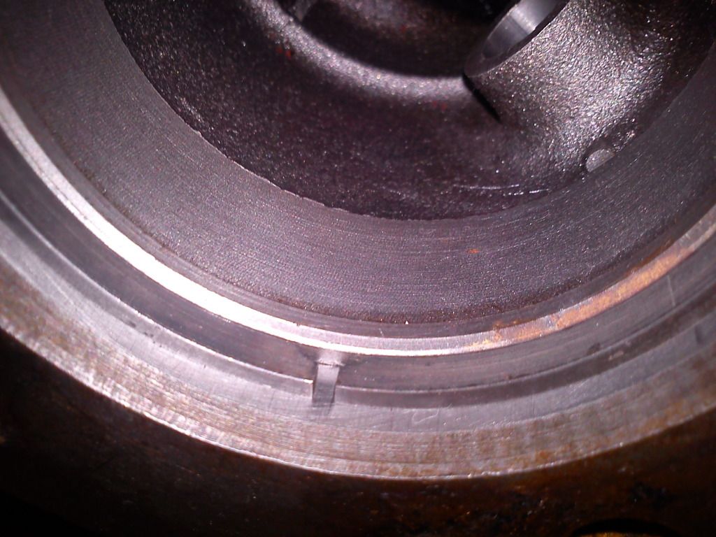

I decided to open up the water jacket by removing the 2 side plates, so I could poke some tools in there & get rid of some scale. I would like to coat the inside, but don't know what type of paint is best. Any ideas anyone??? (I know some people paint inside hoppers).
I tested the ring end gaps by using the piston to squarely push each ring into the cylinder barrel. You then remove the piston, leaving the ring in there, & measure the gap with feeler gauge....
Lovely gap on that one, .013", very nice. How about the other....
Oh well, can't win 'em all!
I cleaned up all mating faces by using a small scraper, then some fine wet & dry paper sprayed with a little GT85 (anything will do, it's just to add a little lubrication). After a good wipe off they all looked really good. I've still got to cut gaskets though.
Then I text Ian & asked him if he would like me to strip the paint off & prepare it for priming? he said no! Shocked (honestly, you can't help some people. How many of you would pass up the chance of having all that work done for you, completely free of charge?)
Anyway, the next day I said "Are you sure?" & he said "Oh, OK then, if you must!" (or words to that effect), so that's where I got to. The pic in my first post, of all the bits, sitting together in the workshop, covered in paint stripper. I've 2nd coated it this morning & will continue with it over the next few days.

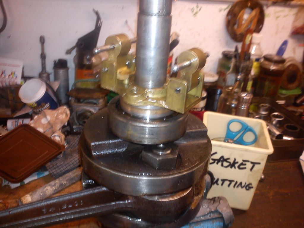

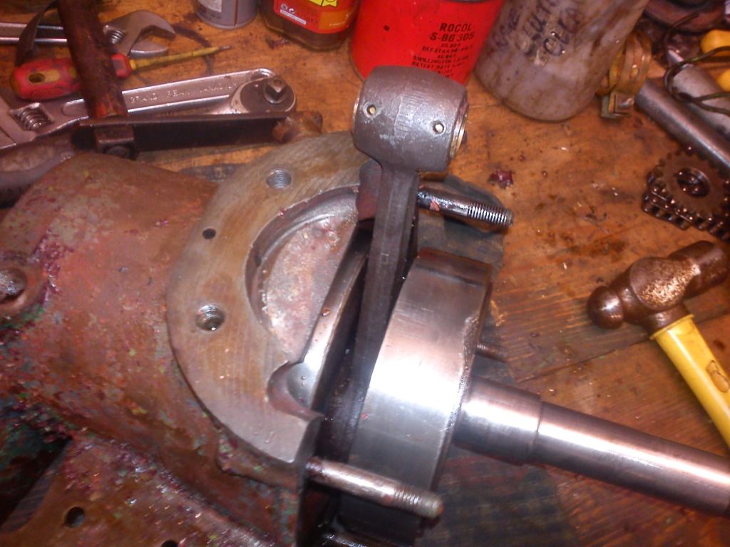

Today I got the flywheel off, then I had to put it back on again so I had something to hold onto whilst I undid the nut on the other end of the shaft.
This nut is the nut which secures the clutch, this is the one which kept loosening when we ran the engine, so I carefully applied some Loctite. This was the green Loctite, the really strong one. I can tell you, this is bloody strong stuff! Embarassed
I heated it up twice to try & melt the Loctite, but I still had to use a big adjustable spanner & a club hammer & I had to strike the adjustable EVERY stroke to get the nut off, it truly was a fight to the death! never let it be said I don't know how to apply Loctite!

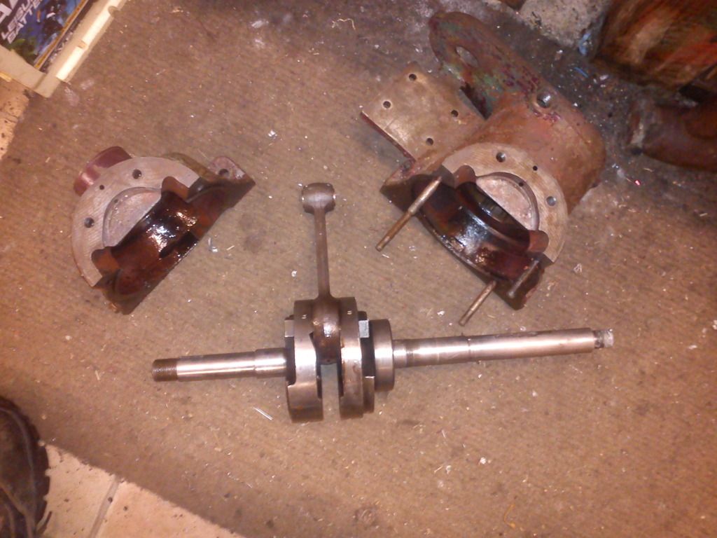

Anyway, I managed to split the crank cases & after some heating & bashing (with wood) I managed to get one half off (the flywheel half)....

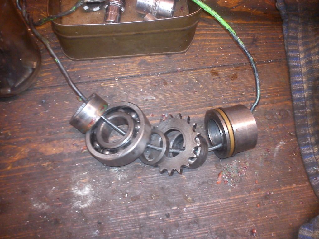

I've also dismantled the other end of the shaft, & removed all the covers, bearings, spacers, washers & seals, but the governor still remains in there, as does the other end of the shaft.

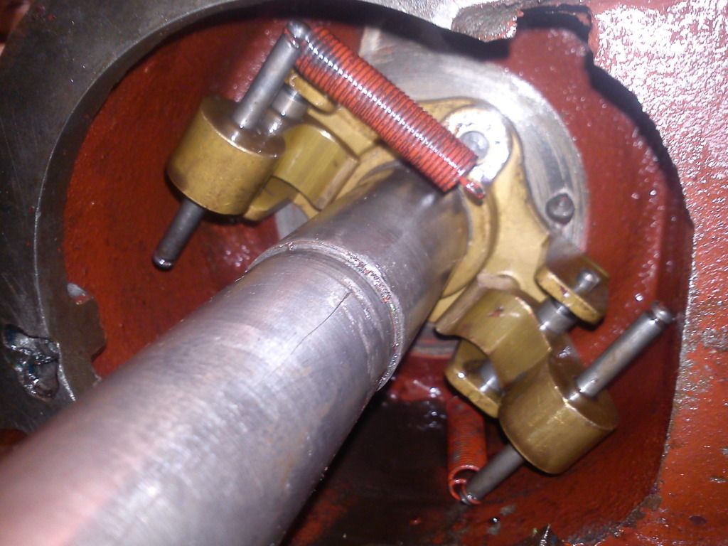

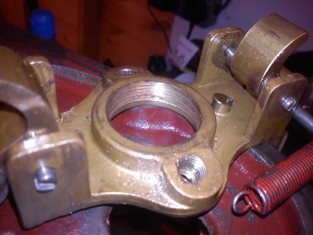

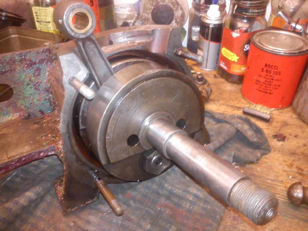

Can anyone tell me how to get this half of the crank case off??? Here's what's left of the governor, I removed 2 small allen headed grub-screws, but nothing's moving....
Basically, here's what's left together, & I can't shift it (I don't want to just belt the end of the shaft, until I know what's holding things together)....
I've taken pictures of everything as it's come off, & put all the bearings, spacers etc etc in the correct order & put them onto wire to hold them in the correct order....
Always worth doing, so it all goes back correctly.
Re: Ian's Stuart Turner P5XC
Post by nutgone on Mon Nov 26 2012, 22:36

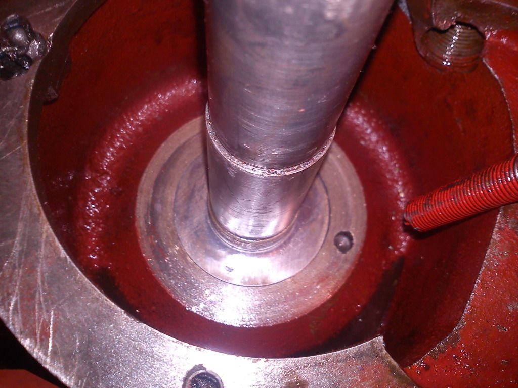

Too late you lot! I've discovered how the governor is attached, the manuals were no help either, had to work it out all by myself, but it's all apart (as far as I want to take it anyway) & I haven't broken anything! sunny
It turns out the governor is threaded onto the crank shaft, not the easiest thing to get off, but manageable....
So now it's just a case of cleaning & checking everything then getting it all back together. I might well prime it all up before reassembly, not sure yet. There's not supposed to be a gasket between the crank case halves, just jointing compound, so that's saved me one tricky gasket, the rest of them are pretty easy, I just need some bigger hole punches.
So far all the bearings & seals seem fine, so that's good. I can't get both main bearings off the shaft, just one came off with any ease, so I'll leave the other one on there & clean it in situ.

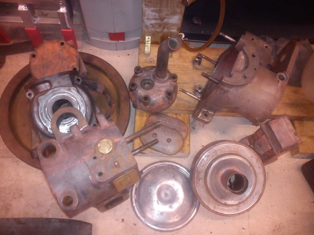

Right, I managed to do a little more on this today. I suddenly remembered how I get rid of paint stripper & get those final layers off, I use a bucket of hot soapy water & some wire wool (I'd forgotten all about that, but it's been a while since I've used paint stripper).
So, out came the hot water & the wire wool & I got what I could off the Stuart pieces, I put them to dry just before having dinner. Then I set to finishing them off with the wire brush drill attachment, using the dremmel thing for any tight corners. I try to stop using power tools or anything noisy around 8:30 - 9:00pm, & by then I had done most of it....
I will probably give each piece a final sand off & clean before painting (I still need to get the primer, Ian's supposed to get it, but it'll all be rusted away before he gets a chance so I'll pop out tomorrow & get some, he can reimburse me next time I see him). But it should all look pretty good with a good primer, maybe an undercoat & a gloss finish. he's talking about bright red, like Scarlet, or Post-box Red, that kind of thing, which could look really nice.
I also dismantled the clutch & got the bearings out. they are caked in old grease. It's not gone too bad, but is very sticky, so I've washed it all off & put the bearings, spacer & end plate into soak in some kerosene/stale petrol mixture. I've started to scrape the paint off the outside of the clutch (can't dip this bit in a bucket of soapy water) & it looks pretty good. These clutches are very heavy & pretty substantial bits of kit....

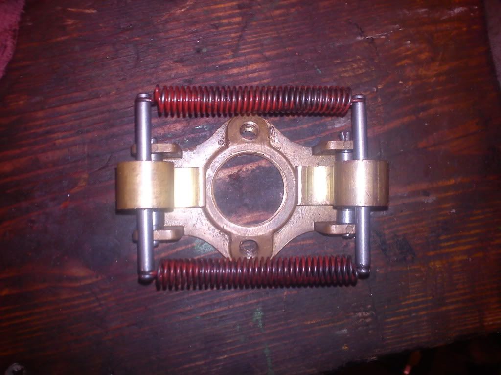

Finally I thought I would put the governor springs back on, shouldn't be that difficult, should it? Oh yes it was! My advice to anyone doing one of these, leave the governor springs on if you can, they are a tight fit at each end & they are very strong springs, their resting position is roughly double their length when taken off!....
So that's it for tonight, I went back indoors thinking it was 10:30 & realised it was only 9:30! Shocked Bloody typical, I could've had the crank shaft ready to go back in if I'd known! Never mind, it gave me time to update the Homelite thread, which I've been meaning to do for days now.
