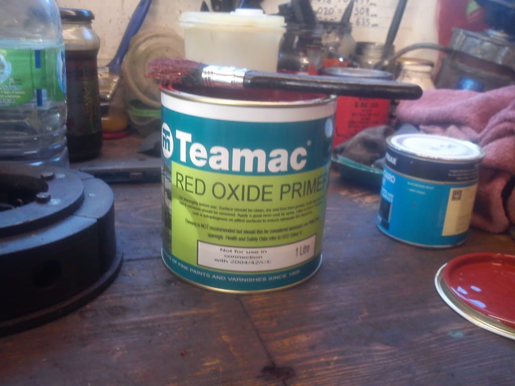

I believe Teamac is good stuff, & this is oil/solvent based, so much better than the other crap I had.
So I started off giving a few bits a final sand off & a first coat of this new primer (it goes on lovely Very Happy )....

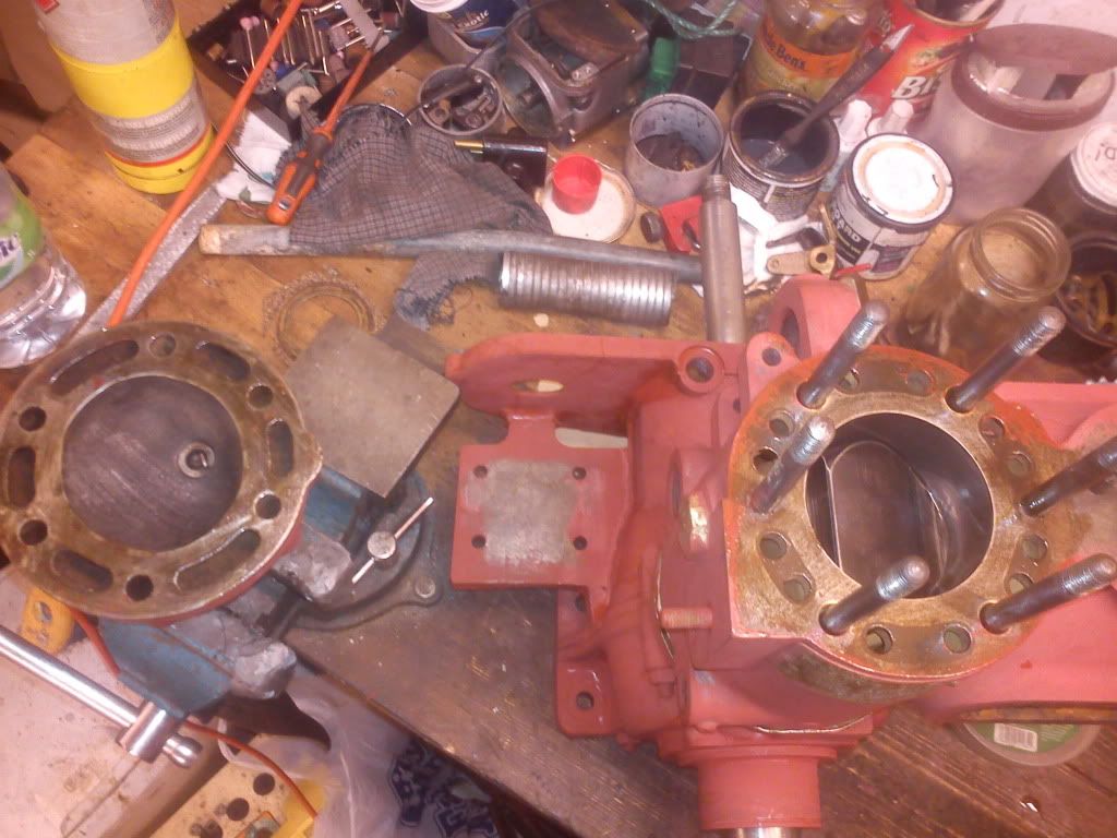

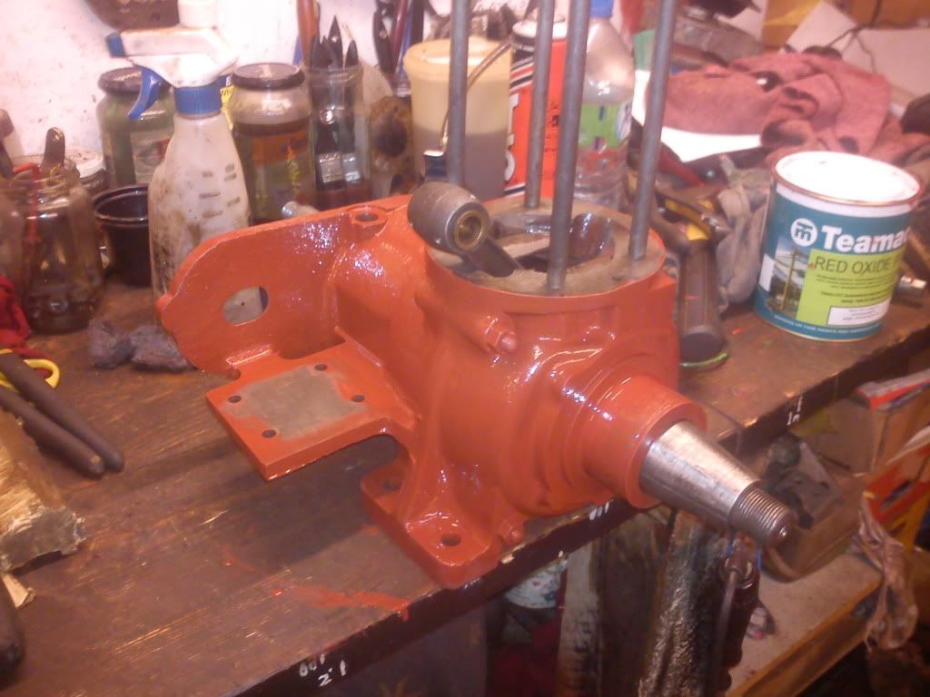

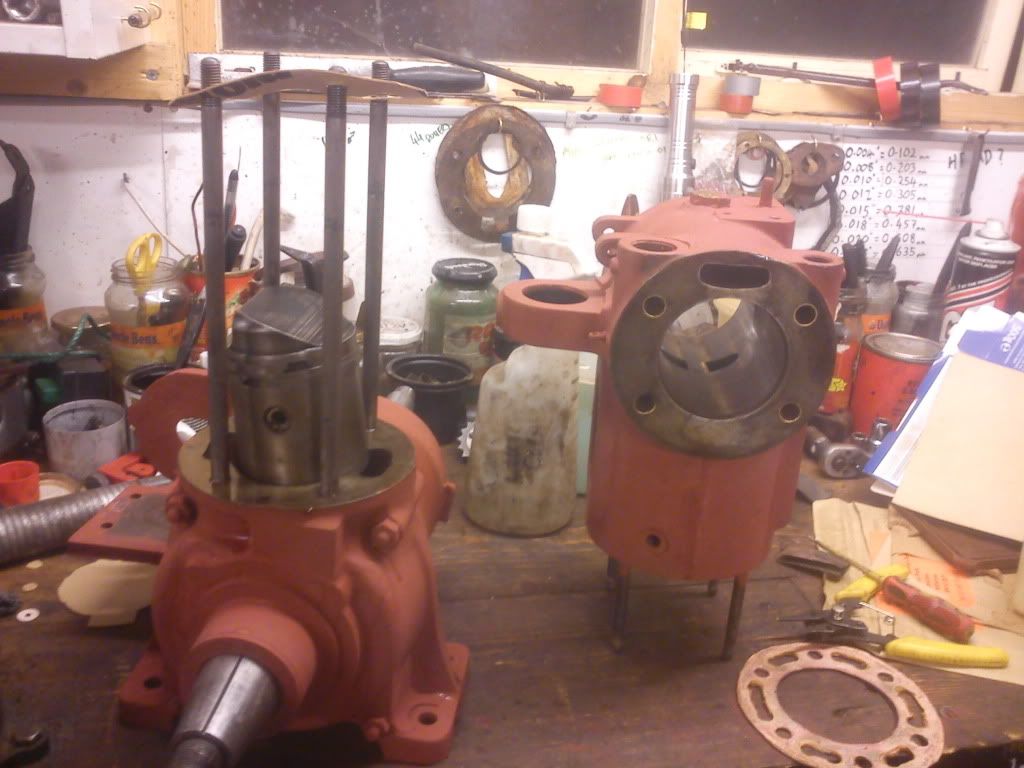

Then I thought I'd better see if I could get the crank cases back together & all the seals & bearings set up correctly. I started with the flywheel side, put the bearing back on the shaft & drove it right down to the crank web. Then I applied the 3 part seal (all washed off & coated in oil). Then I had to put the flywheel collet on, this is supposed to be a sliding fit, as it is split on the taper, which is supposed to close up when the flywheel is tightened on, but it definitely was not a sliding fit for me. I cleaned it all up & even heated it to try & get it to expand a bit, but it still wouldn't slide onto the shaft. I gave it a quick going over with a sanding drum on the dremmel (these will remove a small amount of material & are a good way of doing so, as they are a lot more gentle than a dremmel grinding wheel). Even then it had to be driven on with a block of wood & a hammer! Embarassed
Still, on it went & I started to get the crank case half over the seal & bearing. I heated the case a little & managed to get it on with wood & hammer. I didn't go mad as I knew I would be able to finish it off by tightening the bolts when the other half was almost on.
The other side was easier, I could put the split bronze ring (part of the 3 part crank case seal) into the recess before I put the shaft in, so it was just the bearing that needed driving home. This side went on without any heating & I soon had both halves together.
I coated the joint with Blue Hylomar (the book says a jointing compound, & I reckon this is the best stuff for this job, as there's no gasket. I prefer to use Wellseal with a gasket) I tightened it all together with the crank case nuts, then I remembered that you're supposed to tighten the head & barrel on before you finally tighten the crank case nuts! Rolling Eyes
So i quickly loosened them off again & put the head & barrel on, tightened it all down & re-tightened the crank case nuts. Then took the head & barrel back off again, ready for the piston to go on. (piston was still off at this point)....
Then I cut a barrel base gasket & applied some wellseal to the mating faces. Whilst I waited for that to dry off a bit (they recommend 5 minutes before putting it all together) I thought this would be a good time to put the piston on....
So I got the barrel on & was faced with the decision of the head gasket. Now, I know the head isn't quite right on this engine, well something isn't quite flat & I'm guessing it's the head, but it's not far out. So it needs a thick gasket.
You may remember Ian asking, some time ago, about cutting a new head gasket from some material he got off eBay (I think it's called Tesnit), he did this, & whilst it's not the best bit of gasket cutting in the world, it's easily good enough. Trouble is this gasket has been on once & the engine was run (only once though). It came off pretty in good shape, so I decided to be very naughty, very very naughty....
Not only did I re-use a head gasket with no metal in it, I also applied wellseal to the mating faces! affraid (there, I said it! Shocked Embarassed )
Well, as I see it, it's got 2 chances. If it works then great, it's certainly not going to be run for some time, so it'll all have good time to go off & settle in. If it doesn't work then we'll have to whip the head off, clean the faces & cut another gasket. No big deal.

Right, so I've got what now resembles an engine. I forgot to say I've been applying extra primer as I go. The bottom end is built up, & the head & barrel are on & torqued down (think I went up to 20 Lb/Ft in the end). Next I decided to put the governor back on. pretty straight forward really, it just screws back on & you tighten in the 2 grub screws to make sure it doesn't come off. But then everything goes a bit tight. A slight tap on the governor end of the crank shaft with a copper mallet & it's all settled in & moving freely again. Very Happy

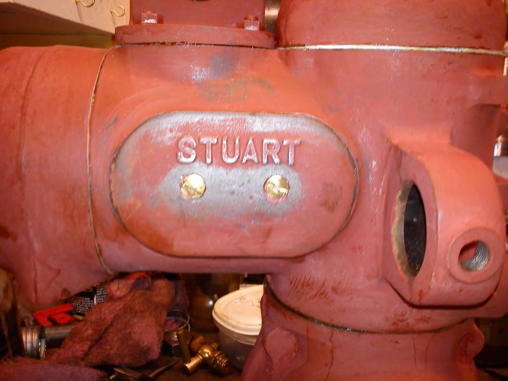

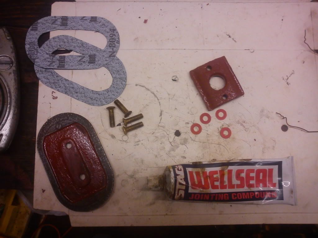

So I thought I would replace the 2 water jacket plates (the bits with "STUART" written on them). When these came off there appeared to be special washers under each countersunk brass screw. On closer examination these "special" washers appeared to be nothing more than fibre washers, they simply take up the cone shape when tightened down. But they were also coated in old jointing compound, so I figured I would see if I had anything in my fibre washer collection to do the job & treat it like all the other gaskets (with Wellseal).
these fibre washers need to be a close fit round the thread of the screws, I found some very suitable ones in my metric collection (of all places). So, I cut the gaskets for the plates & gave all the internal bits a coating of primer (just to give them a fighting chance in the future) got everything ready & applied Wellseal to all the mating faces, including the brass screws & the countersinks in the metal plates themselves (which must be treated as gasket faces, as there will be water behind them)....
I gave it all a few minutes to go off & put it all together.
The rest of my time was spent cutting gaskets & putting it all back together. By the time I was ready to finish I had something closely resembling a Stuart Turner (might need a hand off the bench with it though, it's suddenly gone from "Heavy" to Bloody Heavy!" Embarassed )....

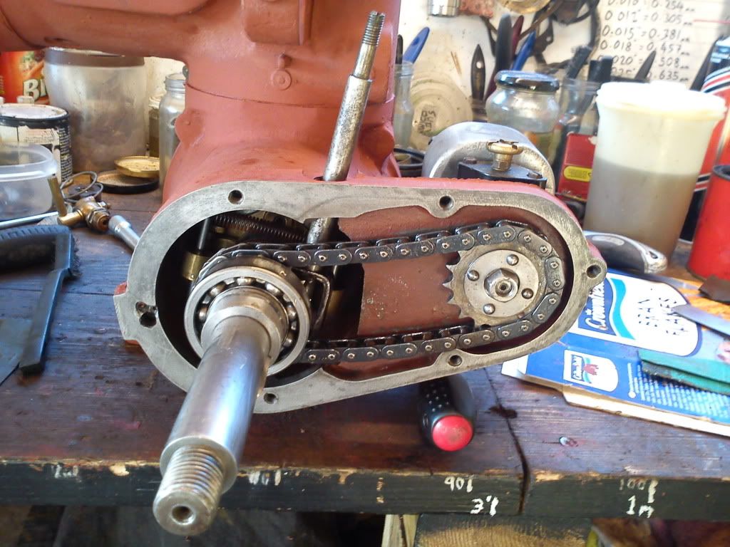

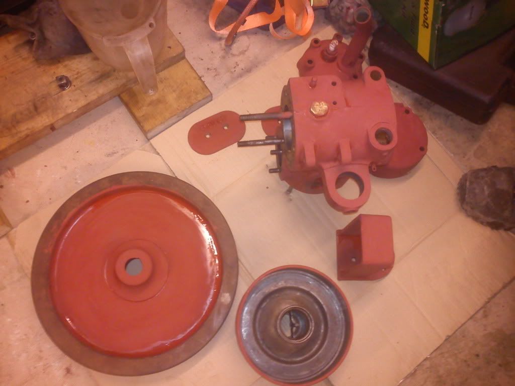

Well, I got the rest of the governor end bits on the crank shaft, managed to keep it all in the right order....
Then I prepped & primed the timing case & put it back on (the mag is only temporarily on there, just to keep the chain in place whilst the primer goes off)....
I also finished off stripping the paint from the awkward parts of the flywheel & primed that as well. Then I spent the rest of the afternoon & evening polishing up the brasswork. Some of the smaller bits got the battery acid treatment for a couple of hours, all of it got thoroughly de-greased with brake & clutch cleaner then polished with Autosol & the dremmel with a mini polishing mop on. I'd forgotten just how quick & useful this machine was with polishing, it's such easy work, I can't believe I've been making my hands ache all this time by hand polishing! I do recommend a good quality, microfibre buffing cloth for afterwards though, it really brings stuff up a treat....

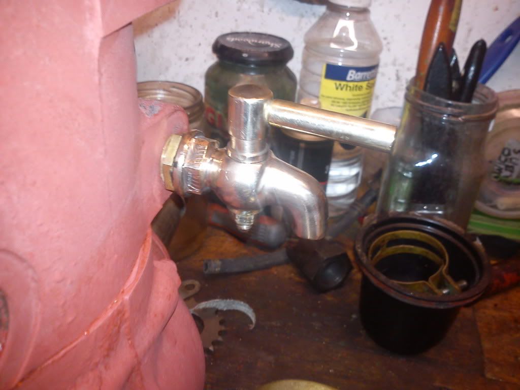

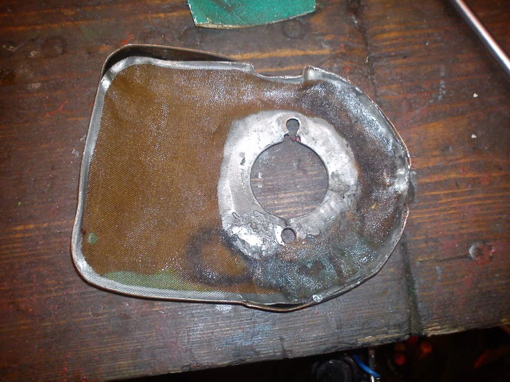

I dunno about this carb drip tray though. It's made of copper, but has a rather tatty looking brass gauze filter soldered into it. Now I don't see the point in this filter, you're not likely to re-use the fuel from the drip tray, & the soldering has come away in places & the gauze just looks tatty & unsightly.
I reckon I should take the gauze off & polish up the copper drip tray. I've taken some pics, one of the top, showing the gauze filter, the other of the bottom, after a quick polish (by hand, it was too late to use the dremmel, dunno if the neighbours can hear it or not, but don't wanna find out!)...
I'll let Ian decide what to do, I know what I would do though.

i have well sould still have a stuart 5 p5 marine i think ,the carb float needle water proof cover that sits on top of the stuart casted top in your pic
it has 3 brass screws and is also brass with a raised center for the float travell as the needle goes up and down if you dont have one let me know and will dig it out and take some pics of it for you to see

No I haven't got one, not sure if I've seen one before. Would be interested to see it. I know the later P5s went over to Amal carbs, the Stuart ones look nice, but Stuart were pump & engine manufacturers really, not carb makers. Still they are a work of art when you take one apart, good to see how a different engineer tackles the problem of getting a metered air & fuel mixture supply into an engine.

It does seem a bit odd to have the gauze filter as it's not as if your going to get that much petrol out of it there again if the carbs ok you shouldn't get any petrol, very strange.

Take it off if it doesn't look right. I'd better get some paint soon as I don't want this one hanging around in primer for too long. Mind you, on second thoughts there is still a fair amount of work to do with the rad and other stuff.

I will take that gauze off tomorrow, or whenever I get round to it & polish up the tray then put it back on the carb.

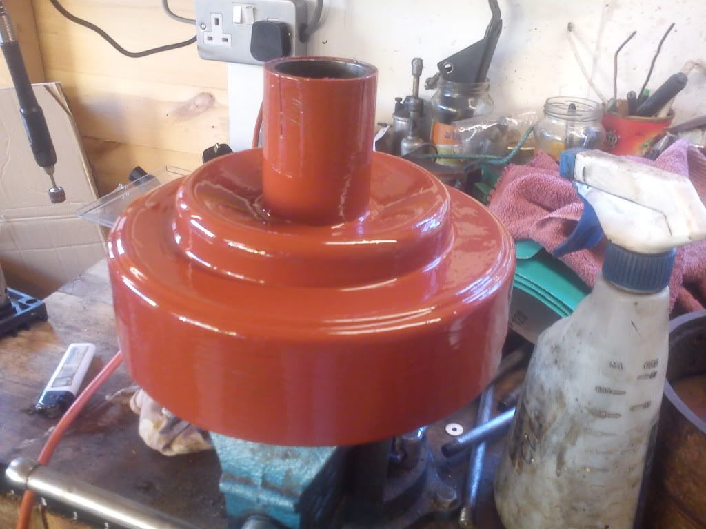

the shaft is 1" diameter with a .25" key. I've painted the flexi-metal inlet pipe black & put it on with the brass clips (now nicely polished) it looks really good, but I didn't have my phone with me to take a pic.

That metal flexi pipe looks a bit small in the dia for the air filter. Do the brass clips cover that up? I can't remember any brass clips.

It's what was originally on there, & is perfect in size, it's just a bit of a sod to fit. The brass clips were round the rubber hose, one was vandalised as it was too small, it had been bent around & a different screw put in it. I managed to find the original screw, bend it back into shape & re-tap a square brass nut for it to screw in to.

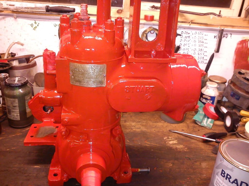

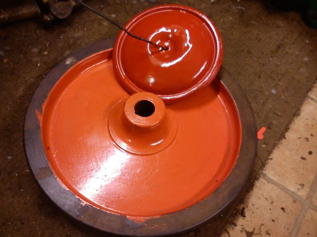

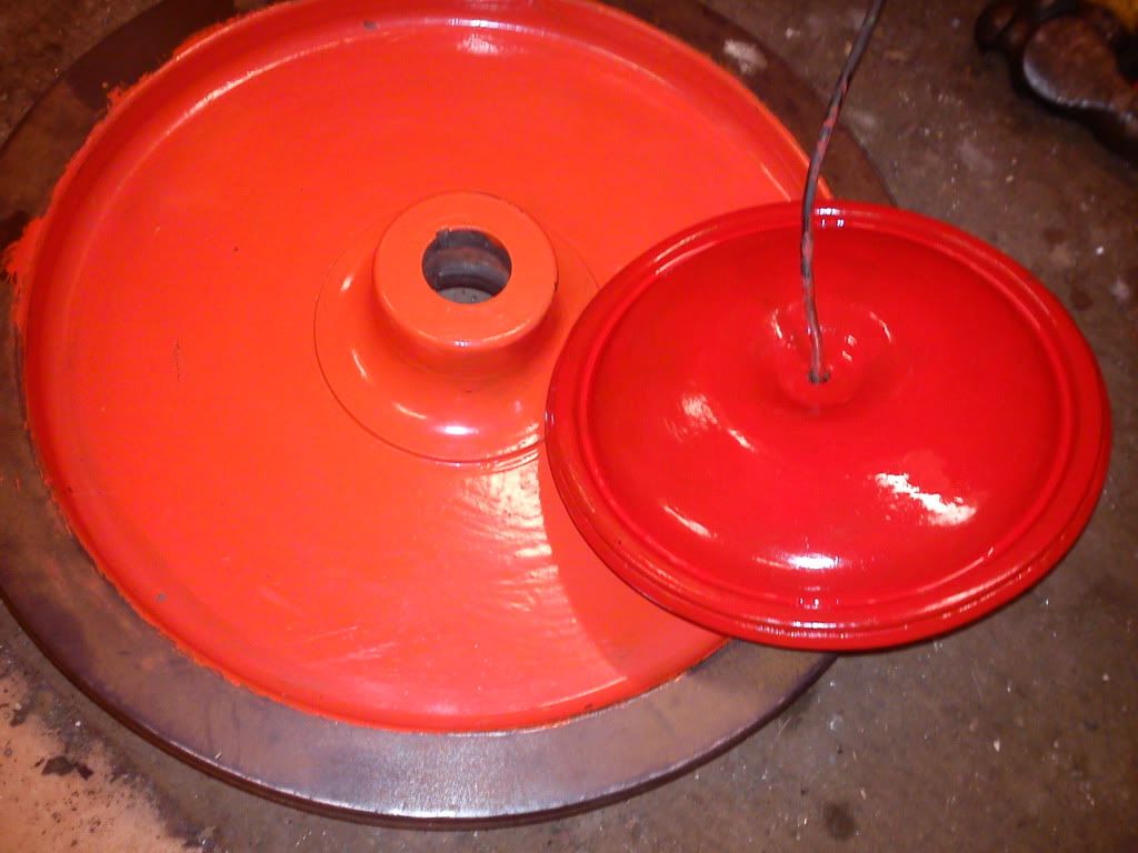

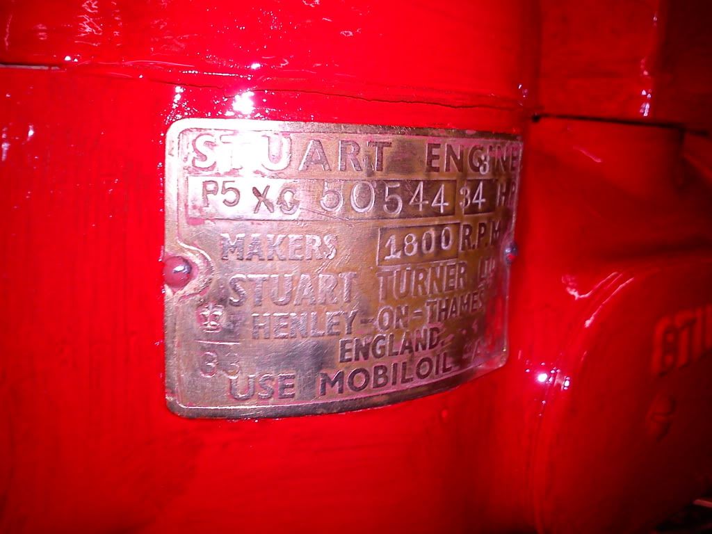

Post by nutgone on Tue Dec 11 2012, 20:04
OK, so the "Post Office Red" arrived today, the paint shop even remembered to ring me & let me know it was in, which was nice.
I got it home, opened it up & it looks much better. Perhaps still a little bright, but it's much better & difficult to tell when it's in the tin (also, the light's not fantastic).
So I got cracking straight away, I'd even bought a new, decent(ish) quality half inch brush (it's only a small engine, & with so many nooks & crannies I find it easier to just use a smaller brush for the whole thing).
here's some of the early results....
& it seems to be darkening slightly as it dries. I've been back in there & it's almost touch-dry now & has gone a lovely deep rich colour with a good shine to it, which is a good sign for a first thin coat.
It will be getting 2 top coats in total, & I will be aiming to leave it a good few days (preferably a week) to harden off a bit so I can give it a little rub down between coats with some fine wet & dry paper (P500 is what I've got, so that's what I'll be using, I guess).
Just for comparison, here's what it looks like next to the RAL2002 colour Ian chose before....
That other colour seems to be very close to the orange that Calor paint their propane cylinders. In fact I would go as far as to say, it IS the same colour as Calor paint their propane cylinders. I reckon it'll look good on the Lister D Very Happy (with black detailing).

I've been out there this morning & it looks really good. You can tell it needs another coat, but I think it looks great. She almost looks like a fire engine appliance, it really suits the rounded lines of the Stuart Turner engine. Once the brass is all back on & the couple of little bits I painted black, it should look a real treat.
I'm taking my time with this one though, I want to get it right. Painting engines has never been my strong point, which is strange as when I was a painter & decorator I was very good & a bit of a perfectionist. This one's had 2 coats of primer, with a rub down between coats. I applied the first top coat with a decent brush & took my time. I'm really tempted to go out there now & do the 2nd top coat, but I think I will leave it to go off for a few days, then I can rub it down with some P500 & make sure the 2nd top coat is the final top coat. If I manage to keep my patience this one should look really good.
I'm really happy with it so far anyway. Very Happy

heres the pics of said item mate
what you thinking
