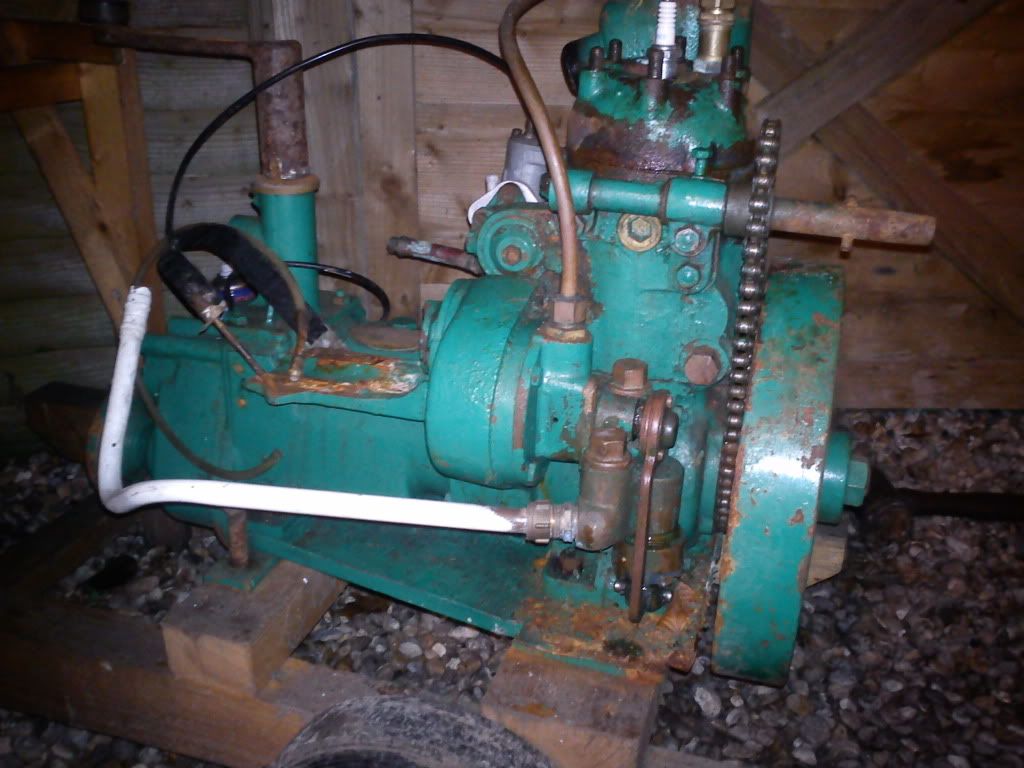

OK, where was I....

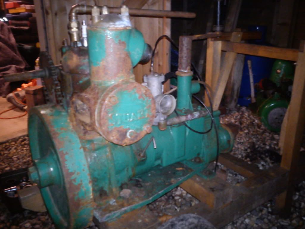

Oh that's right, the Stuart P5 which turns out to be a P6 (so I'm one up on the deal already! ). It's missing a magneto & one of the water jacket cover plates, but I should be able to sort something for the plate, here's the hole....
It's still got all it's bronze/brass bits though, including the water circulation pump.
The Photobucket album is here....
http://photobucket.com/nutgonesstuartp6

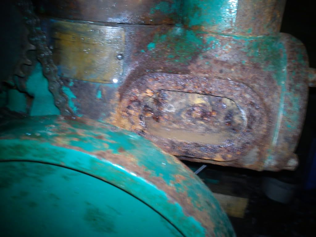

Abes said the heads could be tricky to get off, so I made a start on it as soon as it landed, after releasing the nuts, a quick spray with some GT85 & a few taps with a copper & hide mallet I managed to get it off. I will continue dismantling it tomorrow.
Unfortunately it will have to live outside for now, as I've got the Scott in the workshop there's no more room for engines. It can come inside when I break it into smaller lumps. First I will try & get the exhaust manifold off & then the barrel, but the main thing to do is split the engine & gearbox, then I can probably store it in the dry. Oh yes, & once Ian's P5XC is out the way.
Anyway, I'm very happy with it. I paid peanuts for it (you wouldn't believe me if I told you) & as for fuel costs (around £40 ) well, I also got the Scott in the same journey (which I wasn't expecting) so it's like getting 2 for the price of one as far as that side of things goes.

Re: New Project Stuart Turner P6M + gearbox
Nice engine Nuts and not that many about. I looks to be bloody heavy if other Stuart's are to go by.

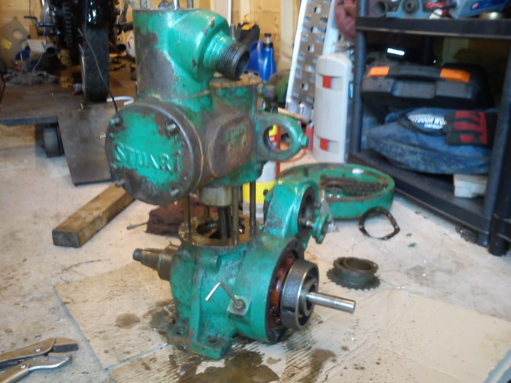

OK, been busy with this one today, but I'm a bit stuck, so I'm gona keep this brief....

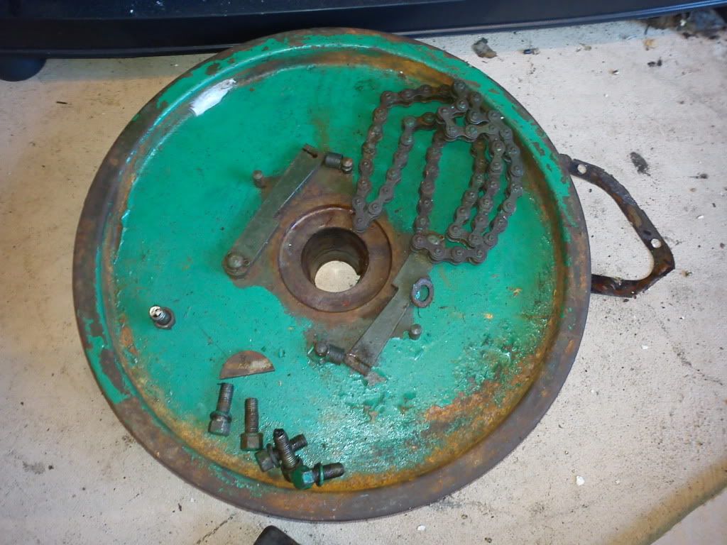

Got the flywheel off (a massive struggle, but came off in the end)....

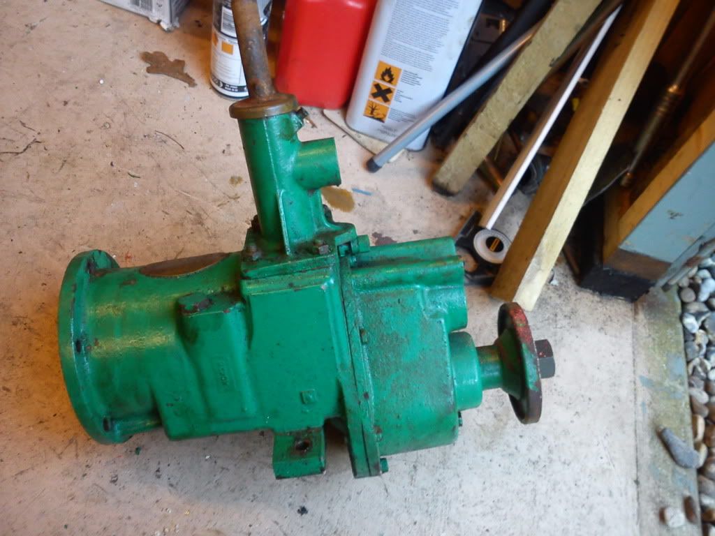

Got the engine & box apart....
Here's the box....
Here's the engine....
Had major troubles getting the barrel off, firstly due to a stuck stud, then it seemed to be the piston's turn, but eventually it came off....
Then I looked inside & it all looked very clean, but there was so much crap on the outside I decided I want to split the crank cases, this happened easy enough on the flywheel side, but I just can't get the damn cone clutch off the drive side!

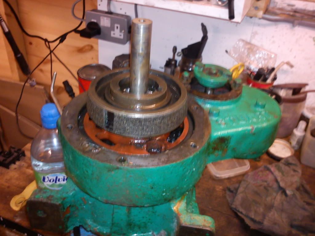

here's the clutch (the crank shaft is in the vice (soft jaws)....
A bit closer, showing that there's a nut hidden in there....
Even closer, showing the mess I've made, trying to remove this nut with a hammer & screw driver, then a hammer & punch (it was the punch which really made a mess of it)....
Trouble is you can't get a socket on it, because of the shaft, & you can't get a spanner on it, because of the clutch, so how do I get it off??? If I continue with the punch I'm going to make a right mess of it (BTW, it's a centre punch, or it was before I bent it). Maybe I should continue & see if it will split the nut, then just get another nut once it's off???
Any ideas out there???
Here's the box....
I've always used a blunt chisel myself to move a nut in that position and try and get the chisel on the edge of one of the nut's flat sides. That could be a difficult nut to get hold of as it's large, thin and could be whitworth thread so I'd try to get a ring spanner or a box spanner, even try to make some kind of C spanner or something to jam into the recesses in the clutch. Try contacting the Stuart agents down your way they might have a special tool and you could maybe load the crank into your boot and take it to them.

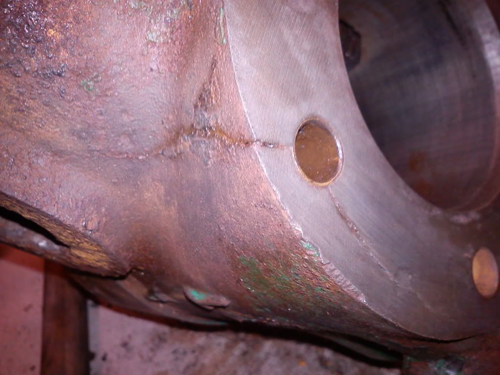

Oh bollox! (& plenty more swear words)! I've hit a bit of a snag.
I decided to have another go at cleaning things up a bit, after chipping away at a very heavily scaled up water jacket I thought I would turn my attentions to the piston. I took the rings off & gave them a good clean. I also cleaned up the piston crown, it's a standard piston, but I don't think it's seen much work. I think this engine was suffering with over heating problems & someone's just de-coked it & put a new piston in, when really what it needed was a complete de-scale, as many of the smaller water ways were completely blocked, & in places these are all it has to circulate (It's quite a complicated system with small water ways in certain places to avoid over cooling & air-locking).
So, I was cleaning up the piston, cleaned the bottom ring, then thought I would test the ring end gap in the bore, but I couldn't get the piston in the bottom of the bore, it goes in the top fine, but not the bottom, it looks like the bore has gone, quite considerably, out of round at the bottom (which would make sense as it was tight on the flywheel at bottom of stroke, & I had a lot of trouble getting the piston out the further down it went).

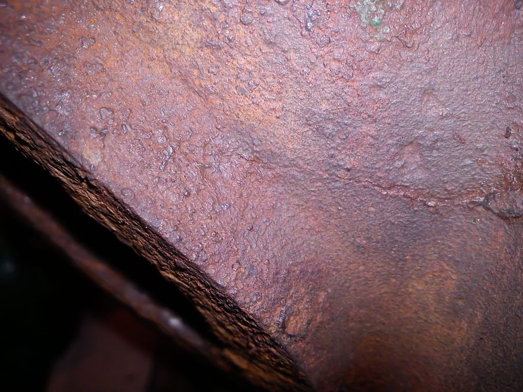

So, I took a closer look & have found a crack....
BTW, all these pics are of the bottom of the barrel casting, the top (I think) is fine. So there was one crack, seemingly just an internal one, between stud hole sleeves. I then gave things a bit of a clean up & wire brush, a quick spray with GT85 to make things more visible & here's what became more visible, a real crack....
This one extends externally to the water jacket cover plate (the one which was missing) you might be able to see this in these pics....
So, it looks like it could be brazed up, none of them appear to have gone into the cylinder bore or the ports. But, if it were brazed or welded, the cylinder bore would still be out of round, so would need machining, which would probably require a re-bore & a plus size piston. I don't even know if these exist & the cost would be ridiculous, way more than the engine's worth.
So I'm after another barrel. Wanted ad already posted. A P5 one would do, they're exactly the same (well, pretty much), I think it needs to ba off a marine engine, not sure if a lighting plant or industrial one would do, I'm pretty sure the P5XC is slightly different. I will know more tomorrow, when I've had a good look in daylight.
Guess now I know why it was so cheap!

If you were really lucky, you could try welding it and the distortion could bring it back into line, but you're probably more likely to win the lottery
There are one or two people/companies who break and rebuild Stuart Turner engines so a replacement barrel might not be totally out of reach. I'll dig out some links tomorrow and you could fire off an email and hopefully get a price. Then all you need to do is save some pennies.

If that barrel is just scrap, I see no harm in giving the welder a try. Maybe source a new barrel first and if they don't want to exchange it then we can give it a bash. It'll be good practise if nothing else. (Every cloud has a silver lining and all that )

Yes, unfortunately these engines, like most of the smaller old marine plants, are raw water cooling & some have been left with that system & used at sea. All there is to protect them is a strainer on the sea cock, which is more for protection of the pump valves than anything else.
I might get in touch with the guy I bought it from, not to complain or anything, but I remember he was a Stuart enthusiast so he may have a few spares lying about.
If I had access to the machinery I know what I would do, I would repair it & put a new liner in the barrel, but to have that done would be mega-pricey. I do have a friend (well, a friend of my dad's really) who has a lathe, but I'm not sure it's up to this kind of work.
But, as Ian says, if the barrel is going to be scrap anyway, we might as well have a bash with it. I think I will carry on cleaning & restoring the rest of the engine, as I can either wait & see what turns up or sell it on as a short engine (a very short engine) or even split it up & sell it for parts.

I don't think I'd try to weld it, I'd be more in favour of using plastic metal or similar. If the barrel is cast you'll need to heat it up before attempting to weld it and I think you'll need different welding rods not the normal ones for welding steel.
