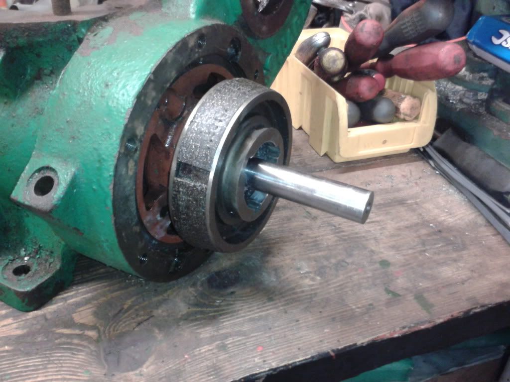

Looks like this one's back on while I'm waiting for the Kohler bits to arrive. I've emailed Mr Schofield about a possible cylinder barrel, if he comes back with a nice positive message for me then I will crack on with it.

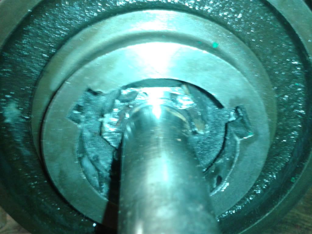

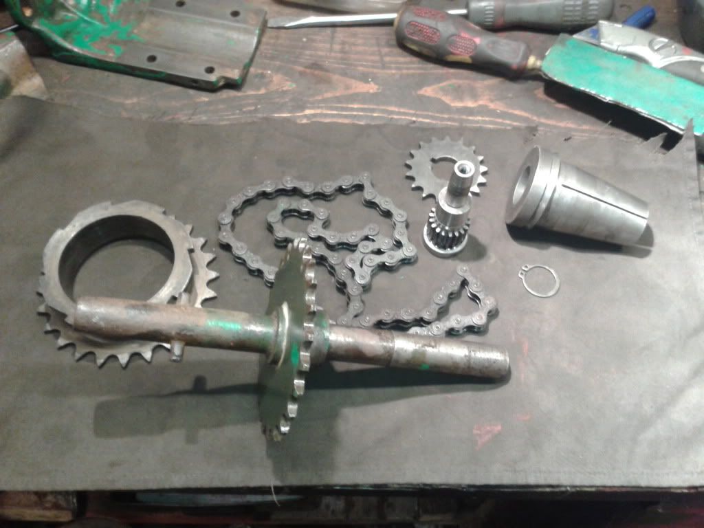

I've been working on it a little bit last night & some more this afternoon/evening. I was having trouble getting the water pump apart, but brute force & ignorance soon got me past that little hurdle (nothing broken, but possibly slightly bent).

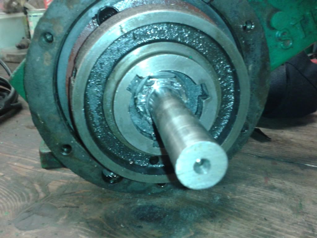

My main problem is removing the cone clutch from the end of the crank shaft. I've been knocking away at the nut in there with a hammer & punches, but it won't budge & I've mangled it up pretty well. Does anyone out there know how to get it undone????
I think the only thing for it will be a box spanner, but weather it will take enough force is another matter. I think I can tidy up the nut enough to fit one on, I just need to find one the right size & buy it.
Of course, the other option is to leave the nut & clutch on there, but I can't fully inspect & clean the crank case, crank shaft, main bearing, seal, & magneto drive chain sprocket from that side of the engine, & I would like to clean out the magneto chain case as well. & all that's stopping me is this one damned nut!

Post by stationary stu on Sat Mar 16 2013, 11:57
Nuts I can't tell fully from the pics the depth of the nut of it's true size and how much room you have to work in. The only thing I can thick off is try and spilt the nut with a small chisel, try the cut at both sides and carefull of the threads. Could you manage to get a drill in and drill either side before trying to split it. I have to say when I try to remove a nut like that I'd use a blunt chisel or punch and hit the edge of the nut giving the most leaverage, try both methods and it may be enough to get it free.

Cheers Stu. There night be room to get a drill in there, but I'm not sure. I may just have to leave it together & do the best I can at cleaning out the crank case & chain case. The bearings seem fine, I just hope the seal is OK in there.

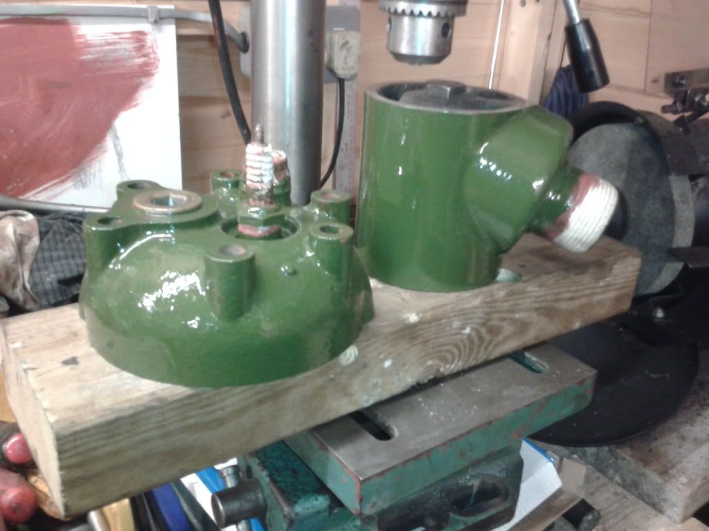

I've been quietly soldiering on with this one over the past few days. I've ordered the replacement barrel from David Schofield & got on with stripping, cleaning, priming & painting various bits.
I've also been polishing up all the brass, soaking various smaller parts in battery acid for a day or two, rinsing them off & wire brushing to reveal a lovely clean brass surface (which then ideally needs protecting with polish).
I'm using the same green I used on the Kohler, which is very close to some of the Stuart Turner greens....
There is some debate as to the correct colour, but there isn't actually a "correct" colour. As with many British companies of the time, the colours varied. I've even been told that some engineers in the Stuart works mixed up their own colours, or changed the stock paint slightly, so they would know who had built which engine if any were ever to come back with faults. But I have revealed quite a lot of the original paint on this engine, & it matches the Kohler (which is supposed to be BMC engine green, which is middle bronze green, which is stated as the correct colour for Stuart Turner engines, except I think mine is a tiny bit too light, but I'm really past caring now!)

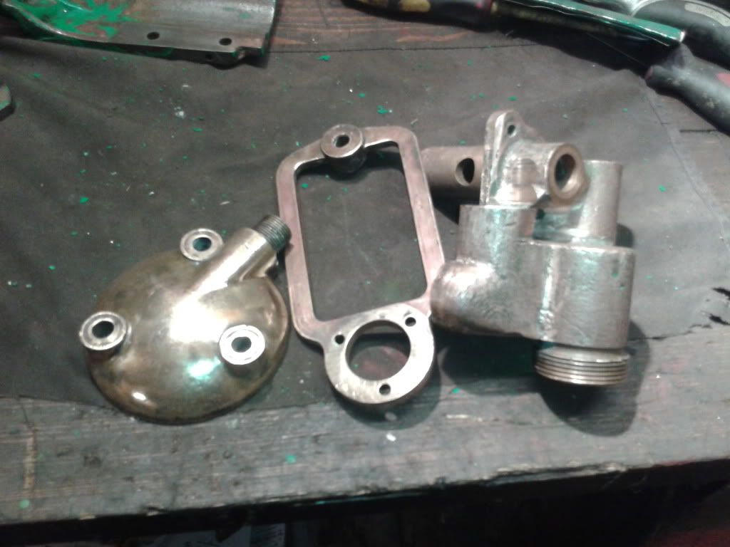

Anyway, I've been polishing up the water pump & other brass bits with the dremmel (There's no way I could do these as well by hand, they were badly tarnished, the dremmel just breezes over them in seconds)....

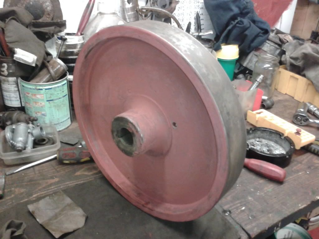

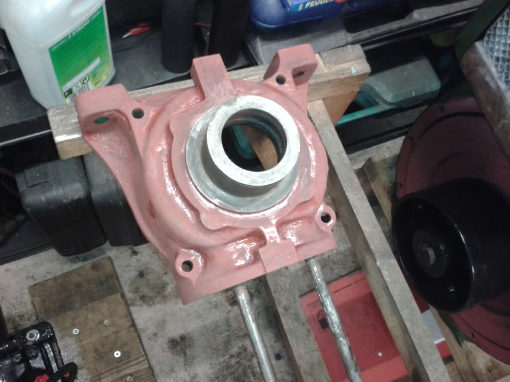

I have stripped most of the cast iron bits back to bare metal & applied primer....
I'm going to leave the outer rim of the flywheel clean & oil it, as it's not really in bad nick (dunno if they were painted originally or not, but would be interested to know, not that I will paint it anyway). I've also cleaned all the nuts, bolts & fixings in my parts wash & rinsed in brake & clutch cleaner. they will all be primed & painted as the machine goes back together (I don't personally go for all this leaving them bare business, especially on a marine engine. Really they should all be brass or stainless) obviously the brass ones won't be painted, I'm polishing them up for added effect.
I've even cleaned up the handle starting mechanism, including the chain....
But I'm not sure it will fit on the barrel I'm getting, as it seems the P5s had a slightly different starting arrangement to the P6 & much later P5 engines. But I'm sure I can manufacture something to make it work.
I've even got a magneto in mind to go on this one, if I don't get it then I will use the energy transfer method, winding my own charging coil to power a car/motorbike HT coil.
The only bit holding me back is the other half of the crank case. The cone clutch is still attached (very firmly) to the crank shaft, so the shaft is still in the case, along with the crank webs, con rod, magneto chain, seals, bearings etc etc. I think I might just have to give up on getting that nut undone, clean out the bits & bobs as best I can & get it back together.

Anyway, I cleaned off that exhaust end plate today & although the battery acid has dissolved much of the scale, it still hasn't cleared the water ways I need it to. One of them has cleared very very slightly, but nowhere near enough. So it's back in for another soaking....
If you look close up you can see that, after a short time, it has started to dissolve some of the scale & turn into a black mush....
I wonder if this will need a few applications, as I expect the acid is losing some of it's potency as it dissolves the scale (not sure of the chemistry behind it, but I know they use acids to dissolve water scale, so I guess I'm using the right stuff).
What I really need is another exhaust plate, but I can't afford one right now, so I'm hoping this will do the trick. I won't be putting it back on unless it is completely clear with a good flow. If necessary I will have to buy another one from David Schofield (if he has one), but I'm not giving up on this one just yet.

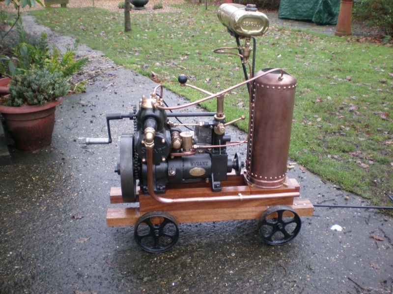

Coming along really well, David is great for spare parts managed to source all of mine at a very good price, not sure if you ever saw mine it was a P5M pic below, what you going to use for the fuel tank? if your interested have a really nice coper tank up for grabs if interested

That's a real picture that one Abes, very nice job. Not too sure I will be dabbling with marine engines too much in the future though, they tend to throw up a whole new set of challenges, especially ones used on coastal waters.
