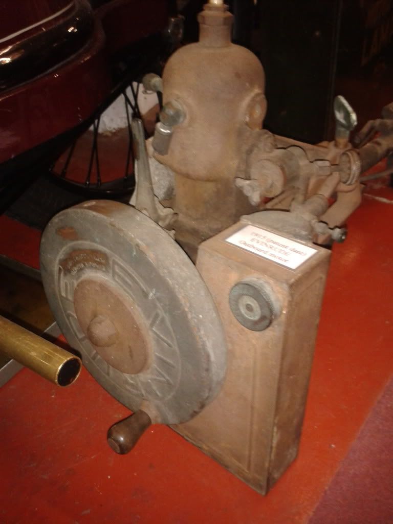

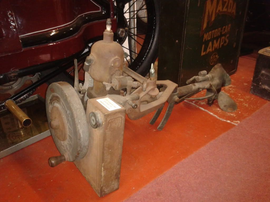

I visited a small private museum today, & amongst many other things there were a couple of these old outboard engines (this pic is o the same one, but there was another one further down)....
They are apparently made by Evinrude & patented from around 1915-1916. Very heavy for an outboard, but I would've killed to be allowed to take one home with me.
Funny thing is, when my brother came over & saw the progress I'd made with the Stuart he said "I wish we had a boat for it to go in". My dad thinks much the same thing.
