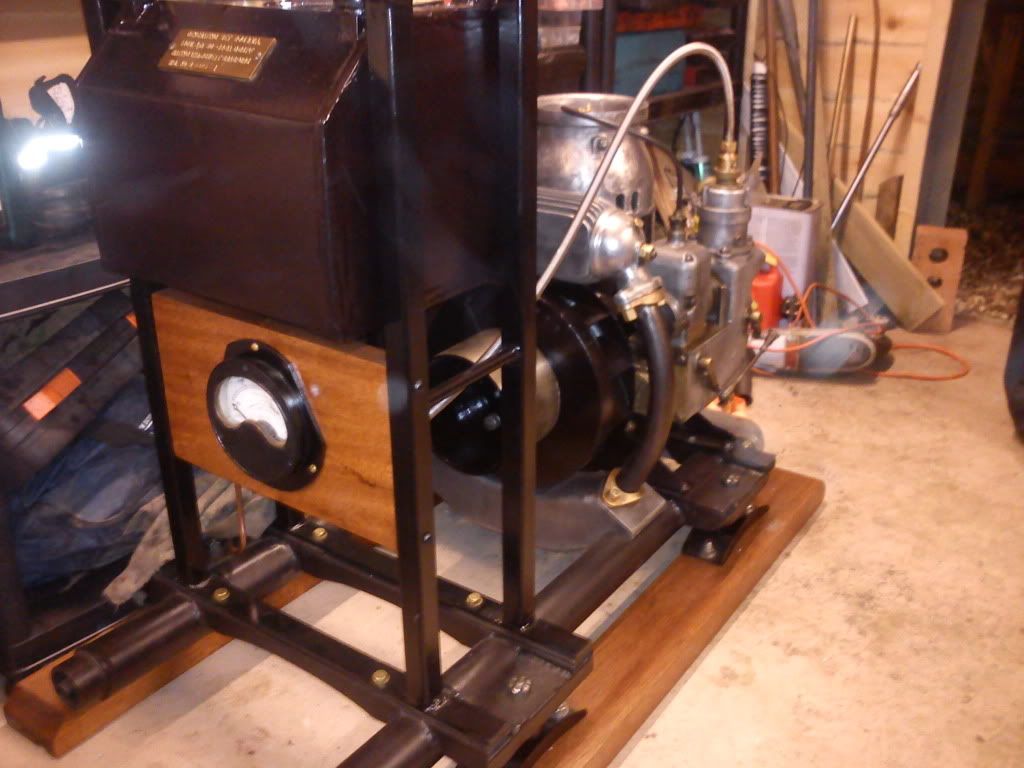

Well, you might have seen it before, & I know it's not everyone's cup of tea, but this is my new pride & joy, it's my newly acquired (from Abes) Scott PAB engine!....
I'm really pleased with this engine, & I don't think there's many of them about (although now I've got one they'll be turning up everywhere Rolling Eyes )
So there it is, my new pride & joy, & I bet Abes is thinking "Wait 'til he tries to start it!", but I will be patient. I think 2 strokes are more my thing anyway, & they may well have to be, as it looks like I'll have to sell my only 4 stroke to fund it (my JAP Model 3).
Now I've just got to get the thing running. Will probably have a go tomorrow. bounce bounce bounce
