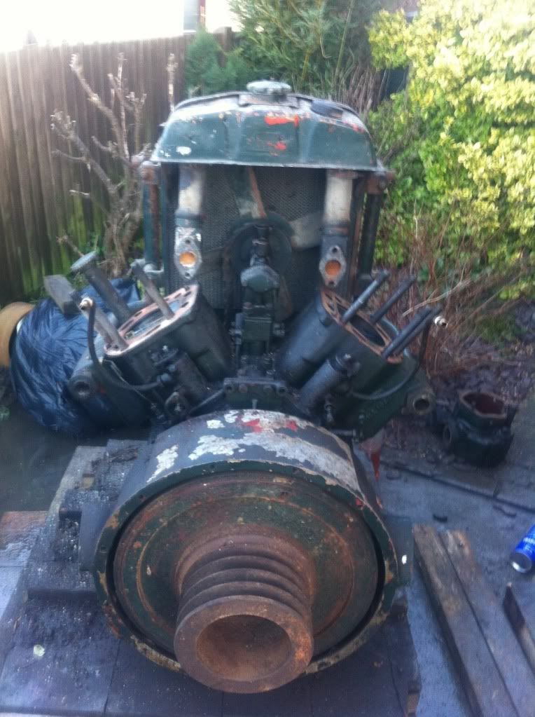

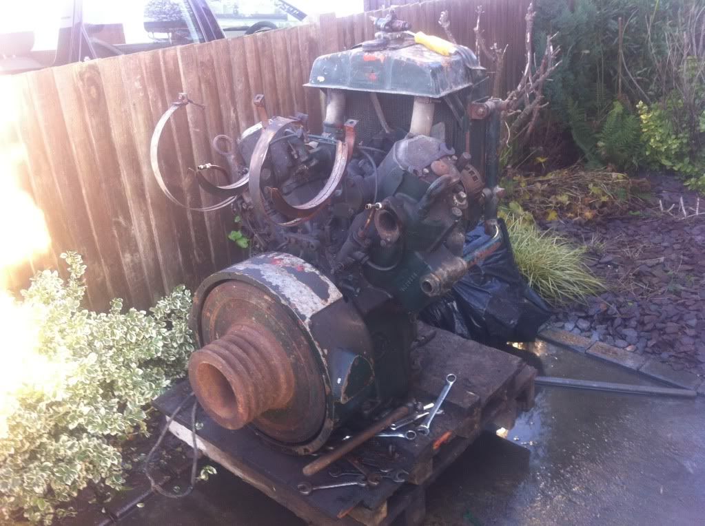

Hello All

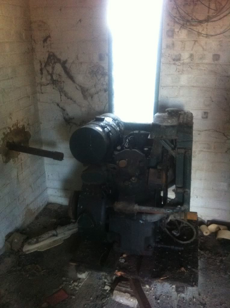

I recently managed to get a Turner Twin Diesel. The engine was seized and had been standing for around 40 years.
Engine in The Shed On the farm where i got it.

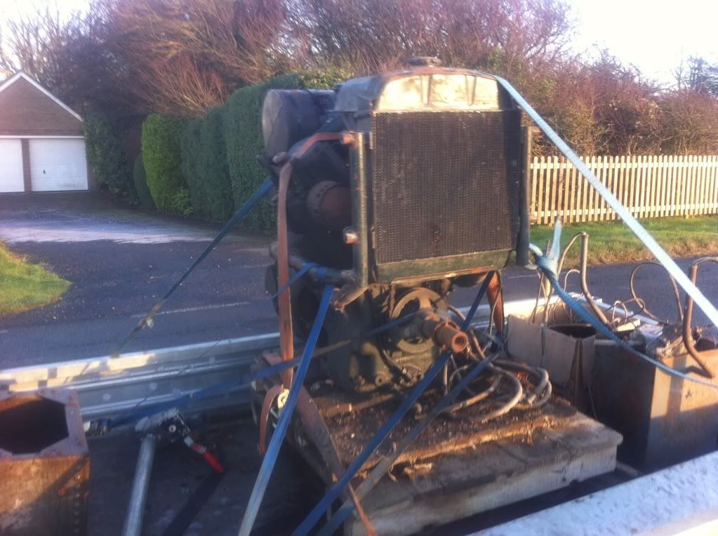

Loaded on the trailer
Diesel Tank And Exhaust Removed, Diesel TAnk Was half Full With 40 Year old diesel.
The exhaust went through the wall of the building and hadnt been capped, So the engines exhaust took alot of damage. The Bottom and baffles has rotted through.

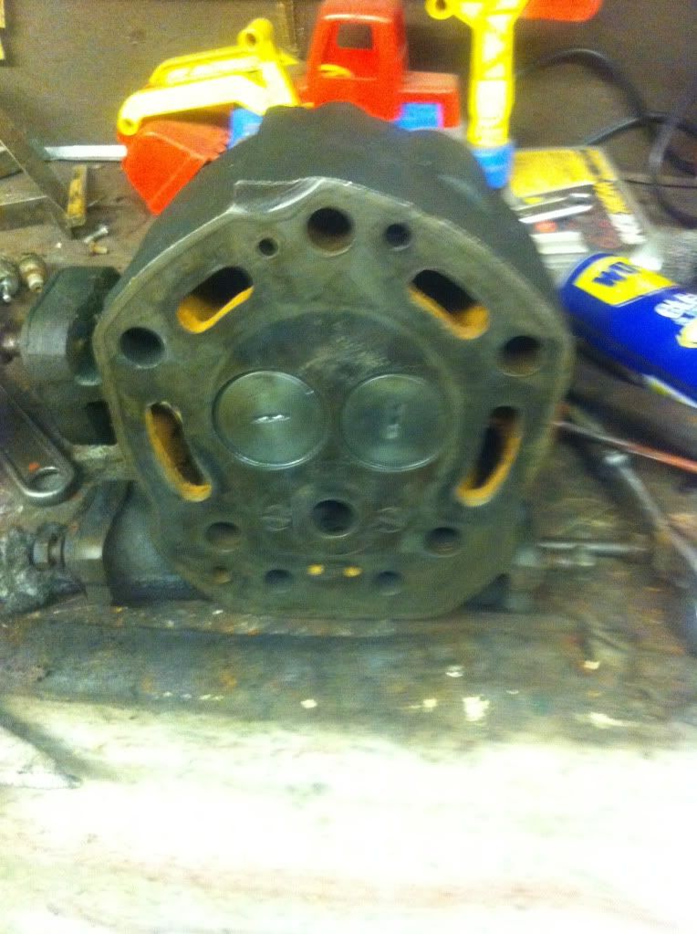

One of the valves was open therefore letting all the water and rust through onto the piston crown.

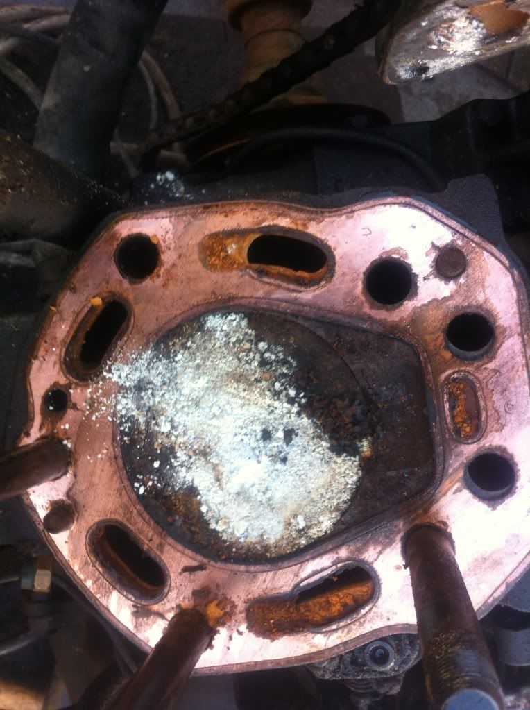

The piston and valve is not in good state at the moment.
The condition of the Piston when i removed the head.
The Valve will require refacing just need to find a companyy to do this now.
The other Cylinder was in much better shape and doesnt require much work.
I reground the valves and cleaned and made new gaskets.
Heres a picture of the good cylinder.

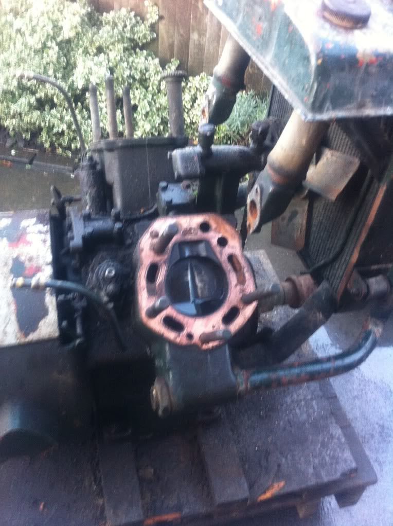

Head and valves rebuilt.
Both Heads have now been removed and just need to free the pistons what is good for freeing up pistons.

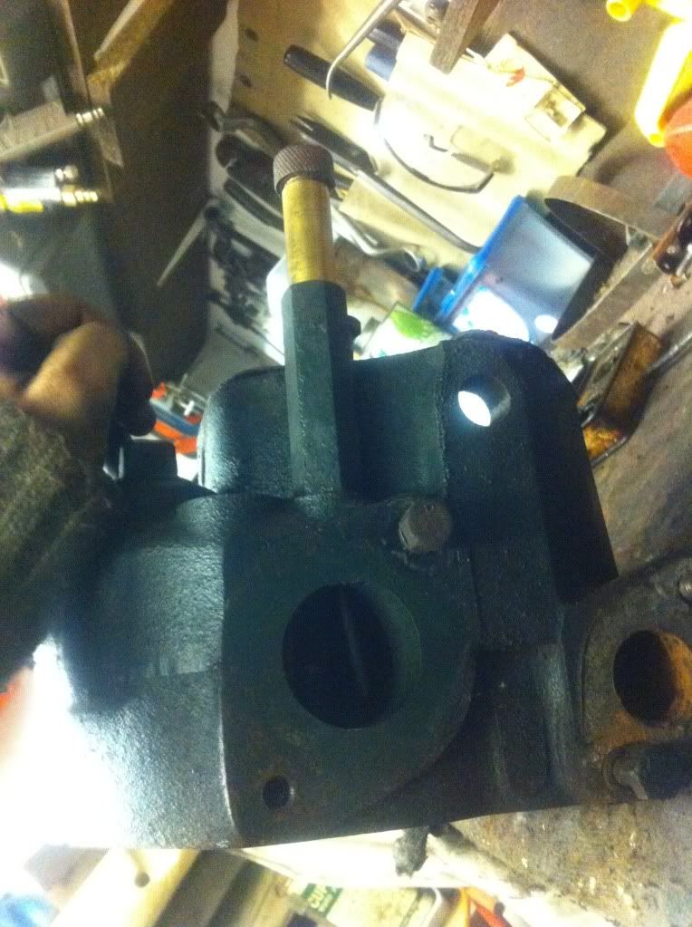

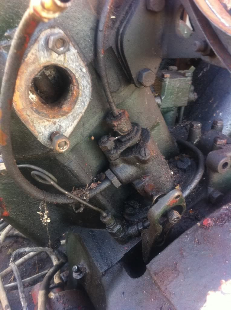

Can anyone on here tell me what this is on one cylinder only. its on the air intake/air filter side of the head and is brass and pulls out.
Next will be the pair of diesel pumps and all the pipe work. I shall also be looking at the water systems and cleaning it all through.
Anyone out there who has one of these engines i would like to hear from you as i have a couple questions.
Many Thanks Lewis

yes mate
you pull the brass out fill the part in head to near the top will engine oil, and push the brass all the way down again
is an oil easy start ,up the compression when cranking to make the diesel explode sooner for "easyer starting"
some early PETTERS had it on also my villiers diesel d270 and my d415 both have them on to of engine and its piped to on top of the inlet valve
its the round hole on top of head left side with the brass pipe in the middle

Your plunger thingy is an oil primer. You take it out, put a squirt of oil in there & push the plunger back in just before starting, this helps cold starting & it really is invaluable. They work really well.
As for stuck pistons, well whatever you like, you name it. Some swear by coka-cola, some use diesel. I would be tempted to say easing oil, but it's going to be expensive. Probably best to make up a mixture, starting with your 40 year old diesel, maybe mix in some petrol, maybe a little 2 stroke oil. Just mix it up a bit, hey presto- your own easing oil/parts wash solution. Heat will probably need to be involved if it's stuck bad though, & a big hammer & some blocks of wood about the same size. Might not come to that though.
Patience is your friend here though. Hopefully Blackvanman will be along soon, he knows about getting things un-stuck.

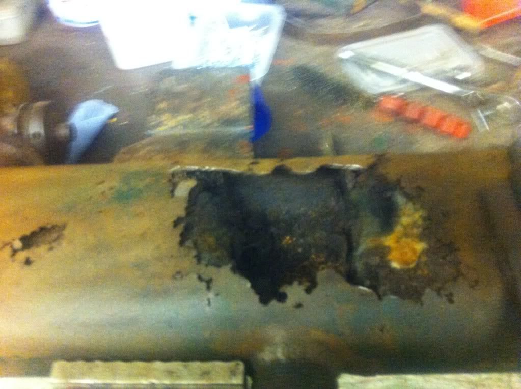

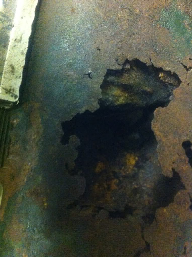

I have tonight had a look at the exhaust which is in a sorry state.
As i mentioned in another post the exhaust pipe went through the wall and caused it become a big birds nest and a way for water to get in.
This has caused the exhasut to rot out.
Heres a few pictures.
The Bottom of the exhaust shall be cut out and the baffles and everything shall be cleaned and repaired. Then a new base shall be put in place.

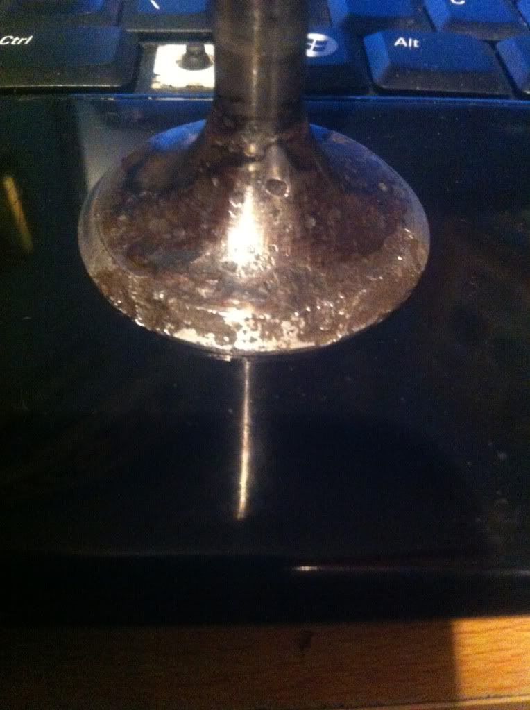

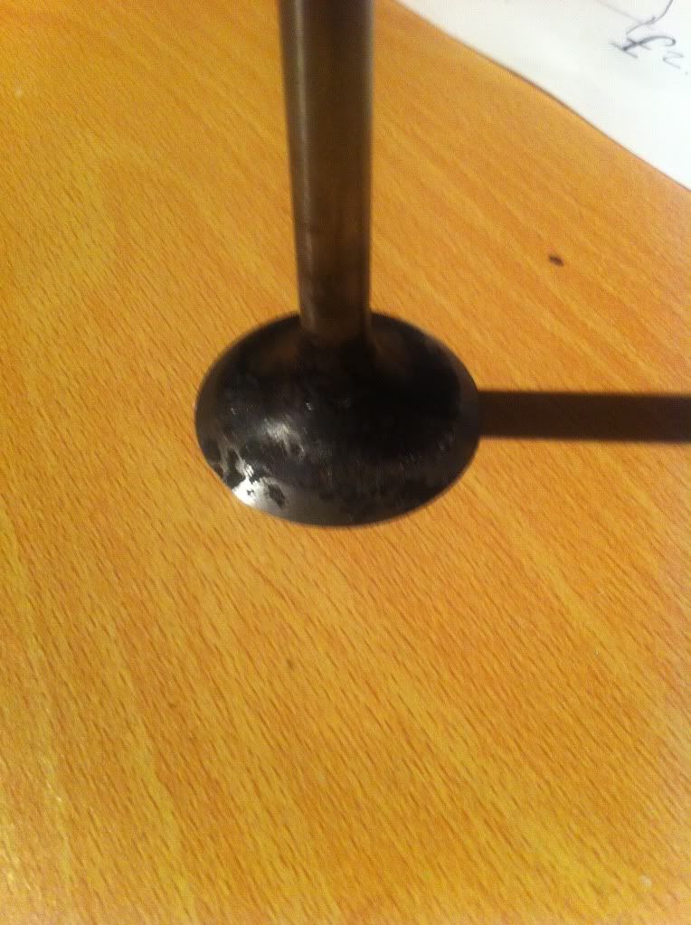

One of the valves is badly pitted due to being left open and is leaking through wd40 when placed on top of the valve. I have found a local company that are willing to reface the valve for me so shall be dropping that off Tommorrow.
Heres the Valve

that valve is in a sorry for its self state
hope they can salvage it for you
and i hope that the head and valve sleeve have survived beter than this
keep going as you are and hope all is well ,
if not "challange on" as we all get from time to time Smile Smile
keep us all posted , it will be good to see what they do with the valve and a rough costing of the job "for future reference
Re: Turner V Twin Diesel
Post by Hughesy on Wed Dec 19 2012, 07:33
They have told me over the phone there will be no charge. The seat and guide and fine with no deep pitting. Just the valve.
I hope they can salvage it. Otherwise another valve may well be needed.

had a quick look/read, first things first, its a v twin, if it doesn't come free easily (and to be fair it doesn't look like it will) drop you crank out if you can, then you can work on freeing one pot at a time rather than by trying to free one off you are actually working both simultaneously making it much harder meaning you are putting in twice the amount of force on the big ends/little ends where you really want to use the least force you can.
As has been said, any thin lubricant (I tend to use wd40 at first then paraffin) you have to hand is the key, if you dry the bore, gently heat the crown of the piston (don't heat the bore too much if you can help it) while its warm chuck in some wd40, the heat will thin it further (it may bubble smoke lightly), next put a little paraffin in, no point making it swim, just make sure the crown is covered.
You may if your luck find things start to move at this point,
if not, and you have the crank out:
find a bit of timber as close to the bore size as possible, place it on the crown, strike it with a medium sized hammer (not a lump or sledge Very Happy ), did it move?
Yes: continue with reduced strikes, minimal force until piston is out
No: give it another good strike
If you can't get the crank out, drop the big ends off, remember to mark them, try to spin the shells out of the con rod (gently) don't mix them up, now use a hard piece of batten on the underside of the piston crown, remember to swap sides of the piston between blows so it will move equally.
If you are stuck and or worried and you can transport, you can pm me and bring it down here to get free'd off if you want Smile

One bore is free as I can wriggle the piston crown. On the rings. The otherwise is the worse.

you are lucky Smile in that case, do as above but without worrying about the crank/other pot, get a second pair of hands, assess which way the conrod is facing and get someone to gently (ish) bar it over as you put the wood in the bore and strike with a hammer, they should then be working with you pulling the piston down as you hit it down Smile

Had the valve refaced tonight and unfortuantly its too far gone they have skimmed it as much as they dare but it still has deep pitting. They also said its worth doing the seat in the head as going by the valve they recommend i take the head in also. so that will be done aswell.
So im now on the look out for another valve or a company who will manafacture me a new one.
As you can see still pitting to the seat.
If anyone knows of where i can get a valve please let me no.
Measurements are as follows:
Head 43mm
Stem 9mm
Length 135mm
Many thanks Lewis

Hi Lewis,
bit concerned about those figures, and they bang on those metric figures? or have you rounded them (even if only a tiny bit)? not sure on the age of this engine, but I would expect it to have been built on imperial measurements, IE:
Head 1 11/16"
Stem 1/4"
Length 1 5/16"
it may not seem much difference but believe me a few thou (.001") can make a massive difference when it comes to things like valve stems/seats etc.
