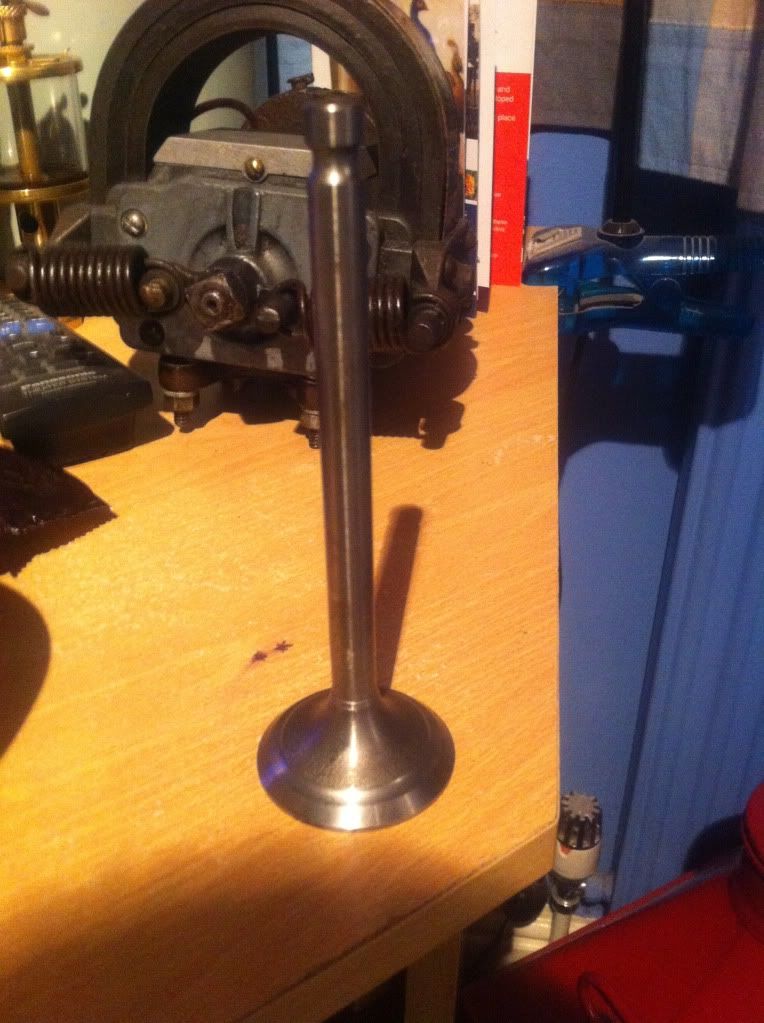

Today the new valve turned up and all looks good with it, fits nicely and shows just how much the others have worn over the years.

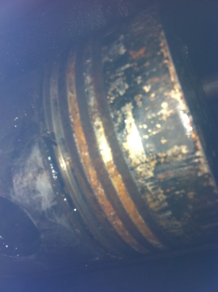

It's been a good day, I have freed the piston up and all look goods. A good few blows the piston soon freed it up.
The 3 top Rings are seized but look good. The oil control ring looks good and is free.

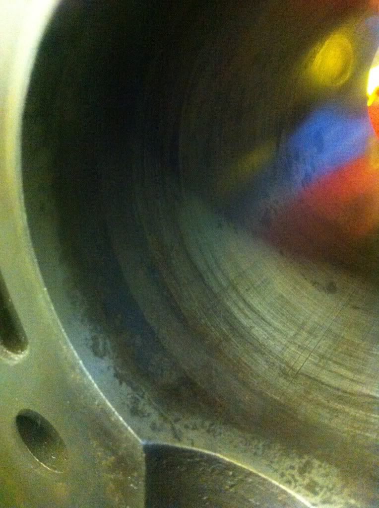

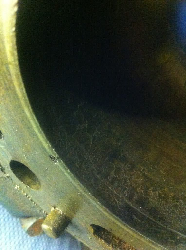

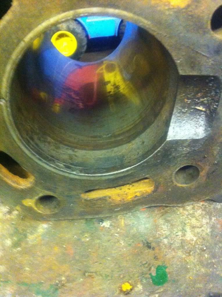

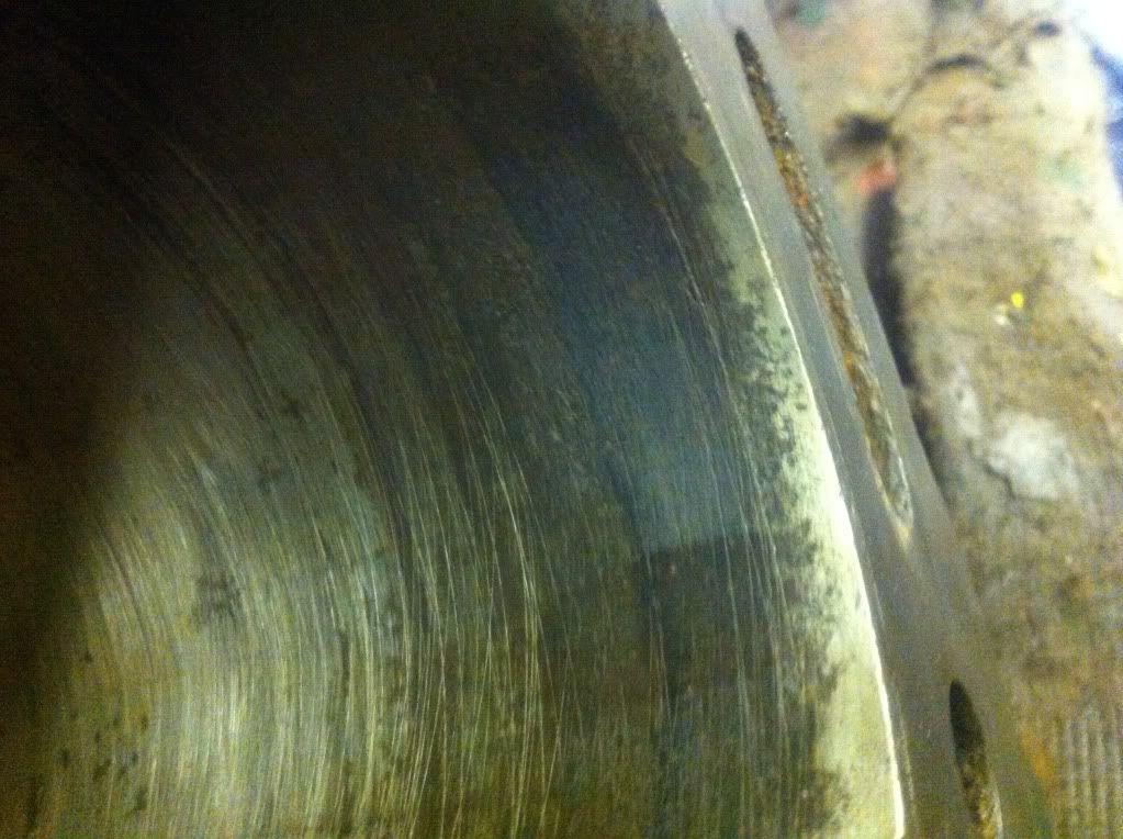

I have honed the bore and all looks okay now. There was slight rusting but this has cleaned up with a good hone.

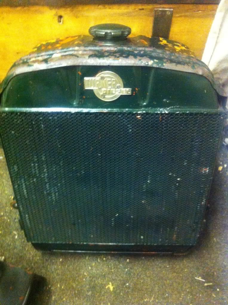

I also cleaned up the radiator and fuel tank and linseed oiled it. Which has come up lovely.

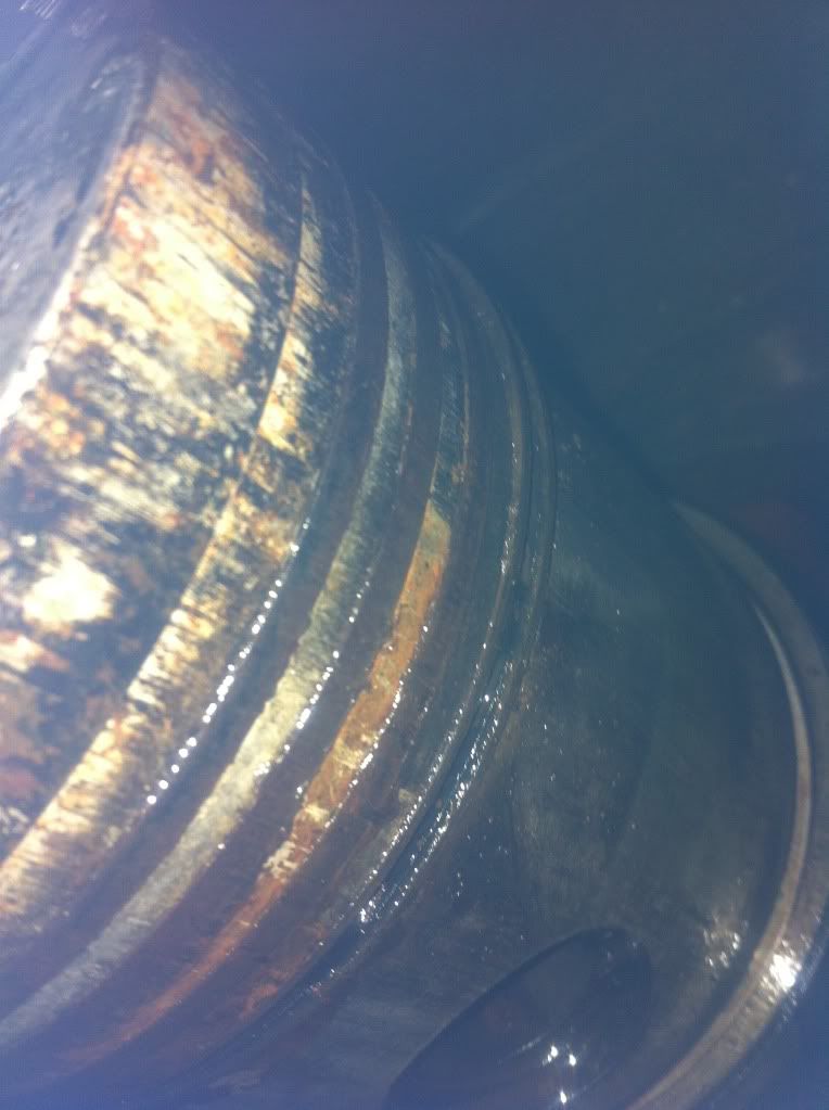

Bore When it was removed from the engine, showing surface rusting to the top edge.
Showing the bore once it has been honed and cleaned.
Piston sorry about the quality it was getting dark when i had finished.

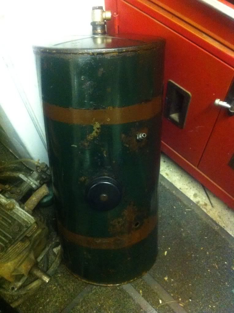

The radiator and fuel tank.

Lewis how badly scored is the piston? it looks as if the engine has siezed up to me. Fingers crossed I'm wrong and it's just a poor pic.
Re: Turner V Twin Diesel
Post by Hughesy on Mon Dec 31 2012, 14:23
No scoring to the piston at all , Think its just the photos. I have cleaned the piston up a bit but rain has stopped play. The bore is in good condition and has cleaned up well. Top 3 Rings are seized solid as expected they would be But otherwise I think it was just seized from standing going by the rust around the cylinder and the way the valve had rotted out due to water.

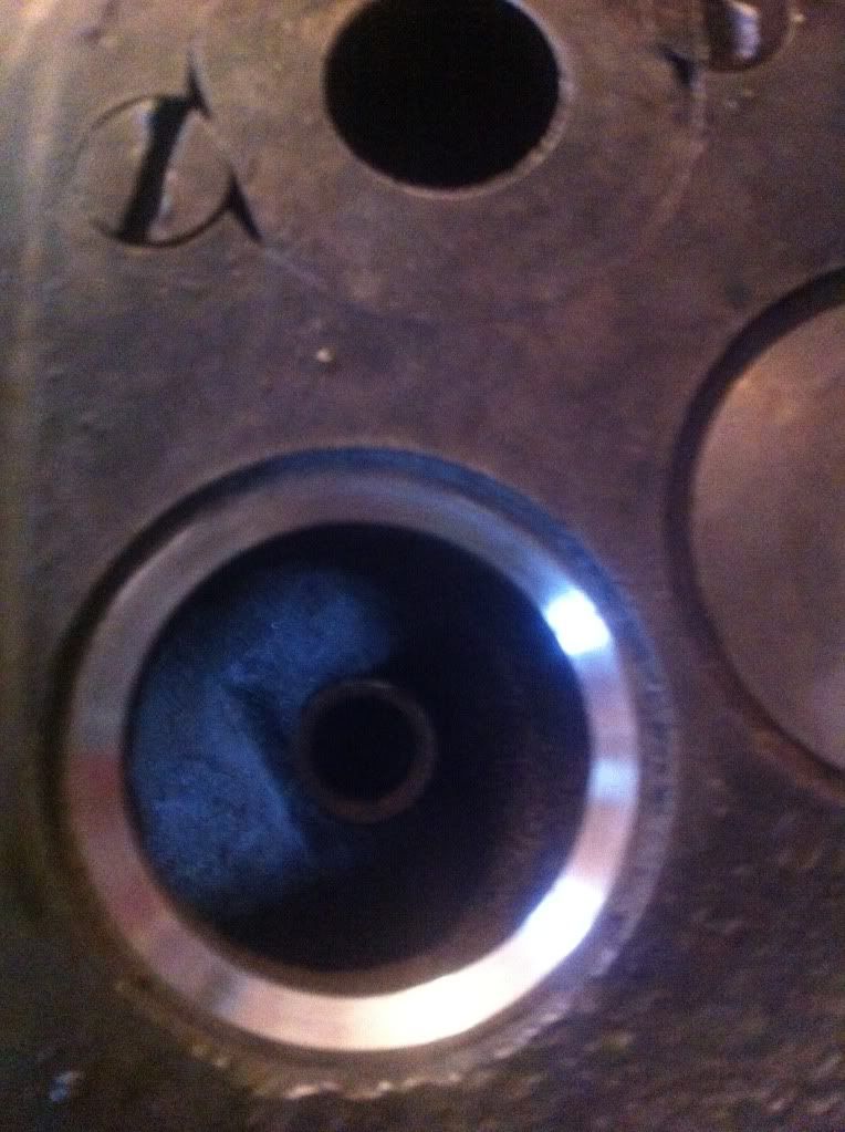

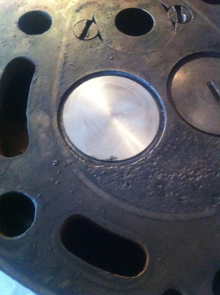

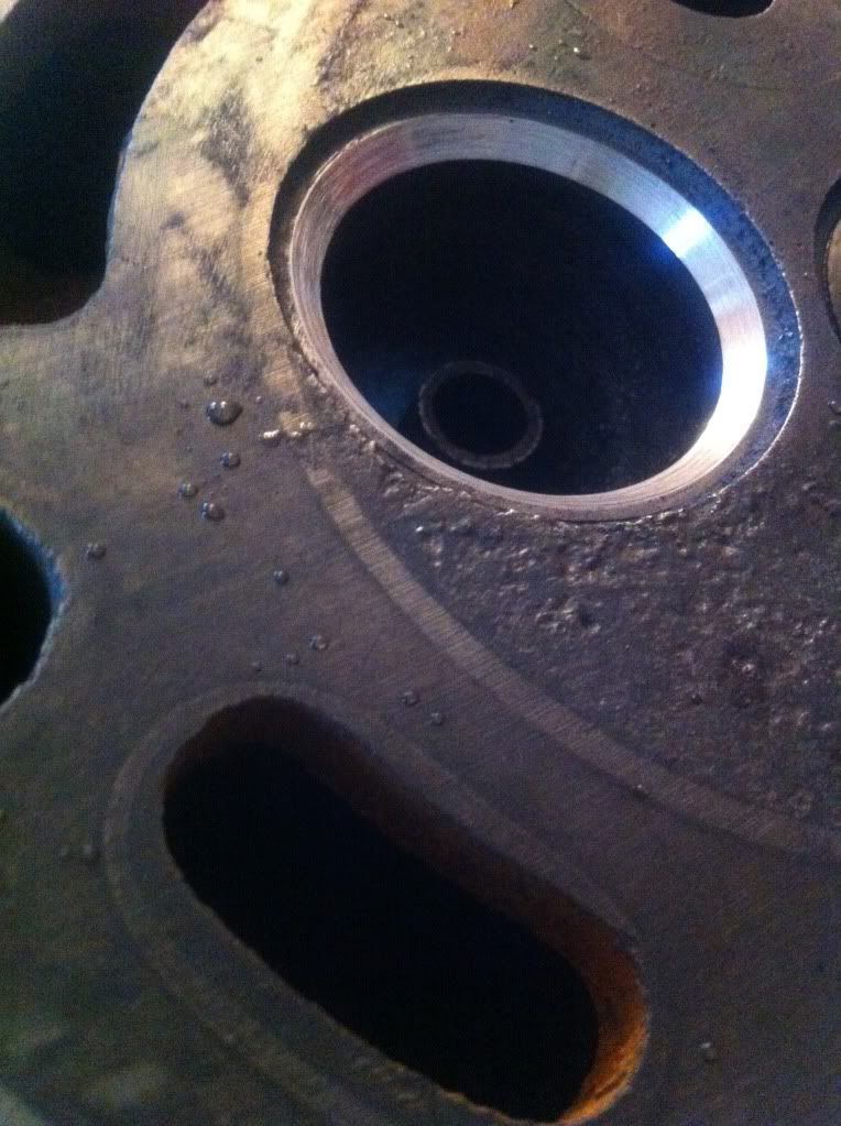

Went over to the engine rebuilders this morning for a new valve insert. They put the valve insert in for me in an hour. Couldnt believe how quickly it was done.
Valve insert cost me £ 30 Which i thought was very good.
